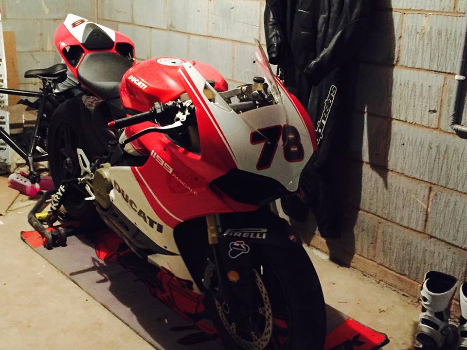

  1. I realise this is an old thread but it's all I could find with regards to fitting the Ducati Performance track fairings. I have bought both the front fairing kit and tail section kit from a Ducati dealership at a reduced price as they were new/old stock. I don't have any electrical connector thingies in the tail section box but 3 connectors in the front fairing box, am I missing something? The rear section box was open when I got it.
  2. Strangely enough I have fitted the rear section, minus the tail lights etc and I don't have an engine a management light on the dash, so maybe it doesn't need an electrical plug thingie.
  3. A quick update, the engine management light does actually come on, only when when you use the brakes though, the ECU thinks the rear brake light is faulty, the electrical connector plug to mimic the light is part number 96580021A. I suppose you could disconnect the brake light wires on the front and rear brakes but am not sure how this will affect the ABS so I'm just going to order the connector instead.
