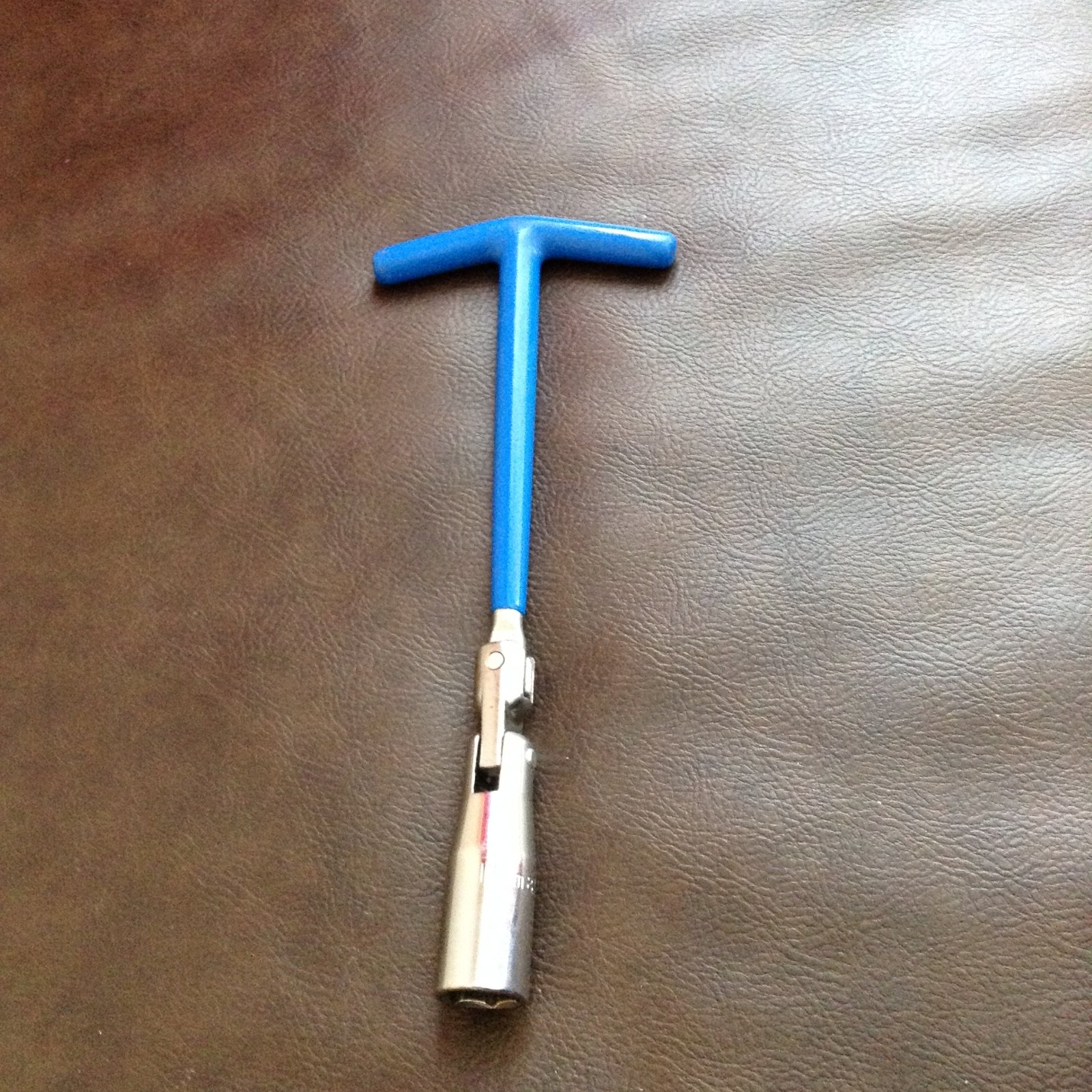

  3. 3/8 drive deep 14mm 12 point socket might go in. their quite thin walled

    Any motor factor has plug sockets to fit the Dukes,
  5. Just tried a Halfords professional one of those, it's virtually identical in diameter to the Halfords plug socket from the same set and wouldn't reach the hex flats either... :/
  6. Went to Halfrauds last night and they didn't. Have a Sealey thin-wall on order that I know will fit via recommendation from CR.

    I had no problems with plug spanners for my SS but the Testastrettas have narrow, tapered plug wells. Normal plug sockets will reach the hex flats on an oem Champion plug but not those on NGKs, which have the hex flats further down towards the electrodes.
