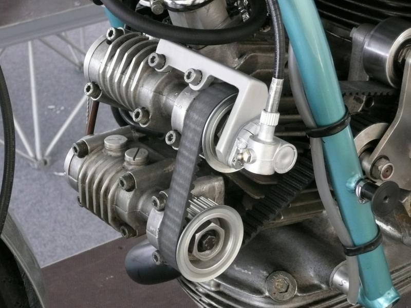

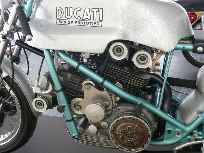

    Now, why belts? While chains and gears may be more durable, rubber composite belts once upon a time were probably quieter, but in most modern engines the noise difference is negligible, are less expensive and more efficient, by dint of being lighter, when compared with a gear or chain system. Also, timing belts don't require lubrication, which is essential with a timing chain or gears. In a nutshell, cost. Belts are cheaper to maintain than a chain. The downside is that they need to be inspected more often and there's the greater potential to snap - even in their service period if for example they start rubbing on stuff or get debris in the belt housing.
    I wouldn't be at all surprised (and I don't know) if Ducati also moved to chains because firstly it can package the engine tighter, and secondly there is a 'perception' of increased reliability
  4. [​IMG]
