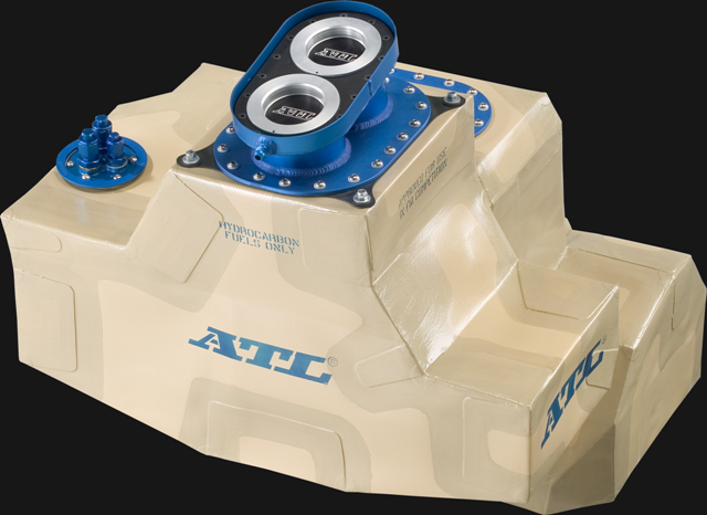

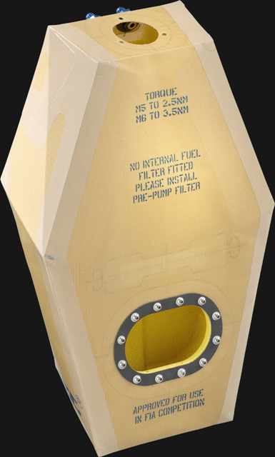

  1. @Sev any idea what the bladders you used weigh?
    (and if you can be arsed - how you seal the fuel pump and filler neck to it, if that's how it connects?)
  2. Genuinely insightful @Sev and possibly the most interesting post I've read here, thank you!
    I'm guessing that bladder is collapsible to a certain extent to fit it? Or does it require the tank to be built around it?
    Yeah those Beater's are something else eh? I've been thinking of one for some time now and even moreso since @johnnie58 ordered one a couple of years ago for his 999R. FWIW my F9 build has an ETI cell.
    Excellent info @Sev and thank you for taking the time to put that post together :upyeah:

  4. The chemical bonded bladders are used for two purposes;
    1) repair rusting leaking steel tank
    2) reduced the migration of fuel into the fibre/resin matrix of a carbon tank by sealing the structure, and protecting the tank.
    A separate bladder not subject to shear force, because not bonded to the internal tank surfaces would give the greatest safety when the tank shell is deformed or fractures in an accident.
    The problem is if a thin tank brittle fractures and the fracture edges move against each other, (egg shell failure) you are then using the bladder as structure and this is not likely to work,
    up to every individual?

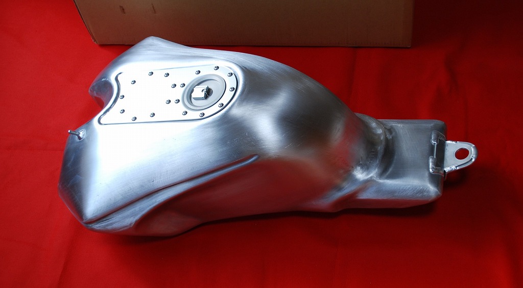

  7. What an interesting post and a beautiful looking fabricated tank Sev ,and not that much more expensive than the troublesome porous Kamna CF tank i had on my bike...if I had the choice again I know which one I would go for.
