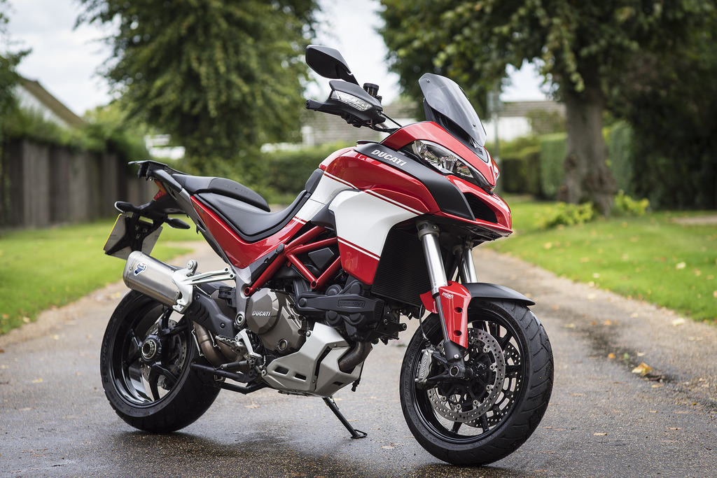

  6. Thinking about shelling out for a full system, couple of questions, the footpeg hanger, it doesn't change the footpeg height? and does the exhaust have any effect on the panniers or the number plate, heard in the early days that it melted the plate and effected the panniers, as most of riding is 2 up and a couple of holidays a years with the panniers this is a concern before shelling out lots of £££££
  7. Footpeg is the same height. Exhaust doesn’t have any effect on the panniers. Exhaust can toast the number plate - stick some silver tape on the back of the plate and you’ll be fine.
