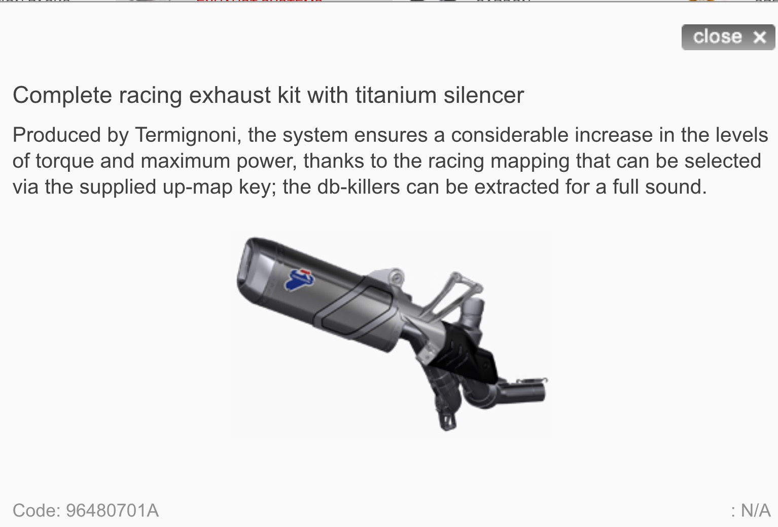

  2. It this does end up being true across any dvt with this exhaust fitted I'd send it back, yes I appreciate the noise but they'll be far cheaper ways to get noise.
    In their description they suggest 'considerable' increases, I'd say what you've got is minimal, not considerable.
    Is there any way to check the upmap is actually working and had actually changed the fueling?
  3. Shame you havent got a std run, one to compare to, as 130 is poor from a 160 bike to start with! I'd have expected 140 BEFORE any mods
