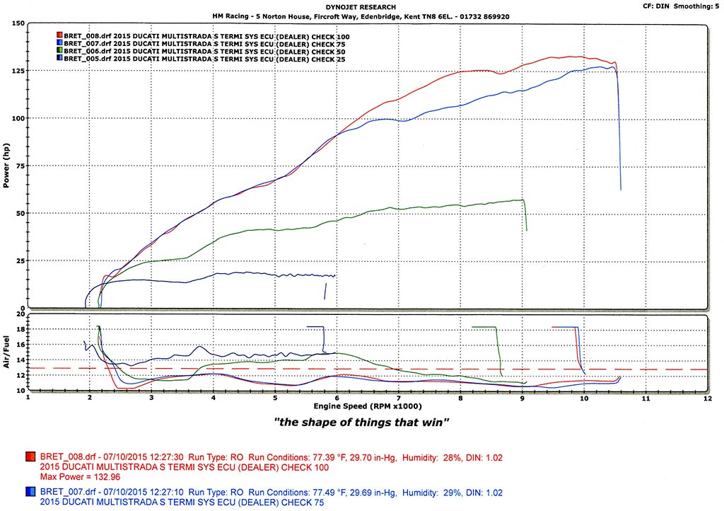

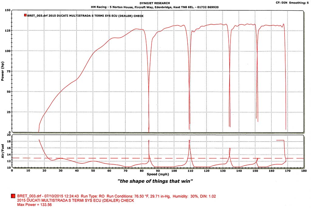

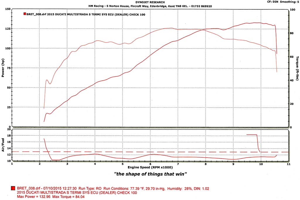

  4. Right had mine tested this morning:-
    MY DVT has 5k Plus miles on it now, I also run V power / Super unleaded
    Remember this is with Termi fitted and Ducati up map in sport mode with ABS, Traction, Wheelie Control turned off.
    I do not have a Dyno test before exhaust was fitted.
    HM Racing did it, good of them to do it this morning for me after contacting them this morning. They stated as par for course HP at crank looses generally 15% by time it gets to the back wheel, so 160-24 = 136 HP at rear wheel Of course this is before Exhaust is fitted, which as we know Termi state increase in power.
    Another note, although not to sure how much you can count on this info. The Ducati APP gave me 133 @ 9006 RPM max power before exhaust was fitted, and since exhaust fitted I have recorded 145 HP @ 8121 RPM
    I cannot stress though how much I think there is an improvement in acceleration at 3.5k RPM upwards in all gears compared to before the exhaust was fitted. The difference being for me well worth the cost of the exhaust, but questions have to be asked though clearly in standard mode (Standard Exhaust) for me the bike is lacking power to what is claimed by Ducati, and I have always maintained that compared to my old 1200 S 63 plate, lower end / mid range pull was more instant and harder on my 63 plate.
    HM racing also stated little could be done by them, as there is no Power commander map that can be loaded yet, (seems there was not one for 14 plate either) and because of the Closed Loop system of Ducati, they cannot adjust the bottom / mid range.

  5. Good work Madproff! Thanks for sharing. Looks like their printer is better than the guys who did mine.
    Was that baffle in or out?
    Your numbers are consistent with my "baffle in" numbers. Interesting that they said 15% loss to the rear wheel - that's more than I was told at Steve Jordan's, where they reckoned it was more like 10%.
  6. Baffle out. TBH I cannot see having the baffle in or out would make a lot of difference it is just a short tube.
    Their general comment was most Ducati's run lean at the bottom end, so should / could easily be improved, but they just cant as this so called "Closed loop"

  13. 133hp and 84lb ft!??!
    Im taking mine back it it is!! Explains why it feels so much less punchy than the old one
