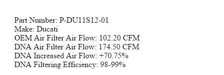

  3. Yes the air filter - many of the bikes when you fit the termi - they recommend you fit a freer flowing filter - this is details for one on Ebay. - See below
    Some of the dealers also sell some termis as kits
    Not sure if Ducati do one for MTS - but other manufacturers do for sure.
  4. Yeah, I know that engines have air filters :upyeah:.

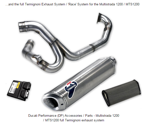

  7. Simon Audi, that is the one before last! The Skyhook 2013 on one has the USB key instead of the ECU. But that came with the performance air filter too. It is the old saying: what goes in must come out. If you are increasing the outflow with the full Termi it makes sense to increase the inflow with a more free flowing filter.

  10. The exhaust valve comes off with the old pipework. The cable is removed from the valve, and the instructions say to simply tie it up alongside the rear brake hose out of the way. The cable activating motor isn't removed. The upmap ensures there are no error warnings due to the valve/cable not operating.
    Fitting the Termi system isn't very complicated (ask your dealer to print out the instructions as there are none in the box), apart from getting the two pipes to align when fitting into the 2-into-1 Y piece. That's a right bastard. WD40 on all the pipe connections helps them to slip into place more easily and retains adjustability while loose to enable you to line it all up and get the rear silencer tucked in nicely and not sticking out like a badly broken leg.
  11. Ah txs Tobbers, the remap explains why you dont have to worry about the engine end of the cable coming out and causing exval errors when fitting an after market jobbie.

  13. My experience with filters on the MTS 2010-2014 and the bikes that shares this filter (848/1X98) is its not a restrictive at all, take the filter out completely and power is like one hp down with either filter you choose OEM, DP or MWR, to NO filter. What IS worth noting is that the oem and termi filter is sealing poorly at the ends, so tip is to either glue filter material to the ends of it or get a foam filter such as MWR.
    Take your filter out and use a flash light too see how much fine dirt is inside there :)
    So air filter here isnt a tuning option, as its not a restricting factor.
