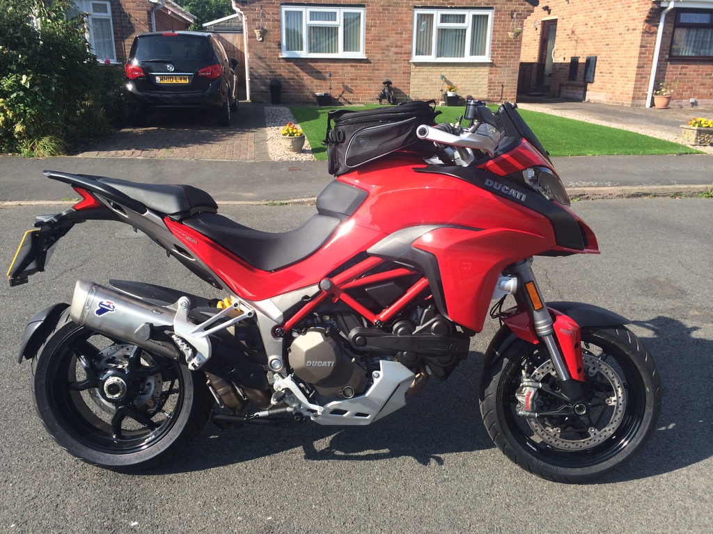

    The rear peg doesn't bother me on looks, if it had a single seat then yeah I'd remove the pegs but I sometimes think they look odd having both seats and no pillion pegs .
  4. Tobers, have you had a chance to try the "arse dyno" with the baffle out yet? I ask because I had my full termi installed about three weeks ago and felt that the mid range flat spot was totally elliminated, however (and this may sound stupid) Ive been riding around the whole time with the baffle out and didnt realise it :Asshat: Wasnt until this morning when I opened the box containing the original exhaust that I found the baffle and single bolt. No wonder the technician at the dealers said "its very loud" when he handed the keys over. Soooo....I put the baffle in this morning and on the first ride the "arse dyno" was telling me that the flat spot was back but not as bad as the standard exhaust and not as good as no baffle.
  5. I haven't tried the arse dyno with the baffle out yet. I don't like to be too noisy and I quite like the Termi sound with the baffle in, quiet when cruising about, a bit nasty when opened up. I'll have to give it a go. Will report back....
