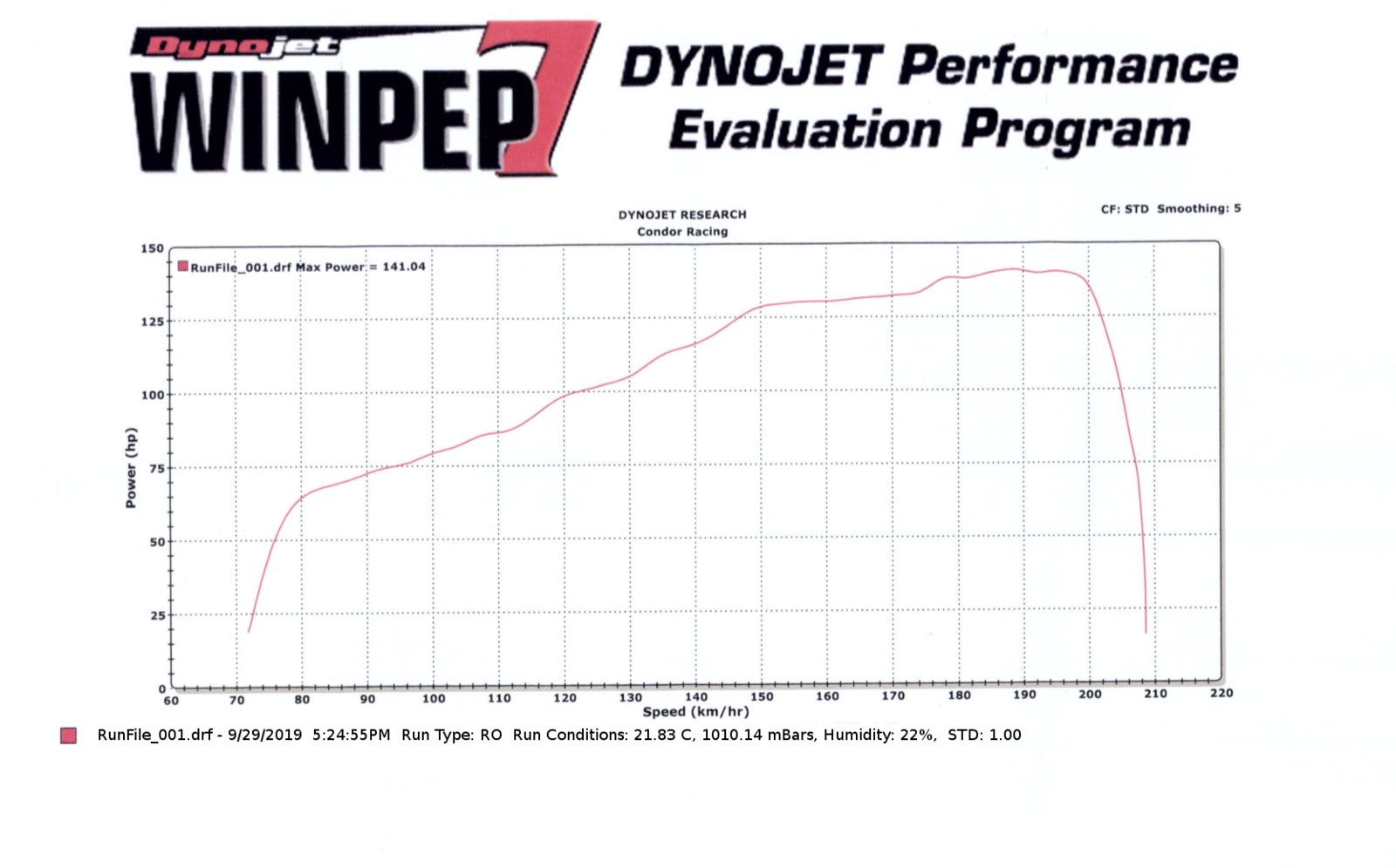

  12. Just had a "for charity" Dyno Run on my Multistrada 1260PP. Half the proceeds went to the Diabetes Foundation. Great Idea.
    Lots of fun. Awesome turnout. Guys were betting on closest dyno estimates vs results. Totally hilarious.
    Here's my results. 141.04 HP. No torque figures and the chart lacks details. but it's for charity!

  13. For a bike quoted at 160 by ducati that’s pretty disappointing imho.

  14. out of interest Dar, what gear did they do the tests using ?
    And is that meant to be engine or rear wheel bhp ?
    If its rear wheel then its pretty good imo.
    @bradders the new GS certainly does well, doesnt it. One ridden well and ragged mercilessly certainly gives a Multi a run for its money. The difference is the multi is doing it effortlessly (or feels like it anyway)
    I'm not a BMW lover but can certainly appreciate how much they have come on from the 1150, 1200, early 1200LC, etc
    'on the dunk' :joy::joy:
  15. We've seen worse. An 11% drop is not that bad considering how HP is measured: crankshaft (158) vs rear wheel (141).
    Although it would be nice to see consistency between manufacturer's claim vs real world results.

    I didn't count the shifts but think he did use all gears.

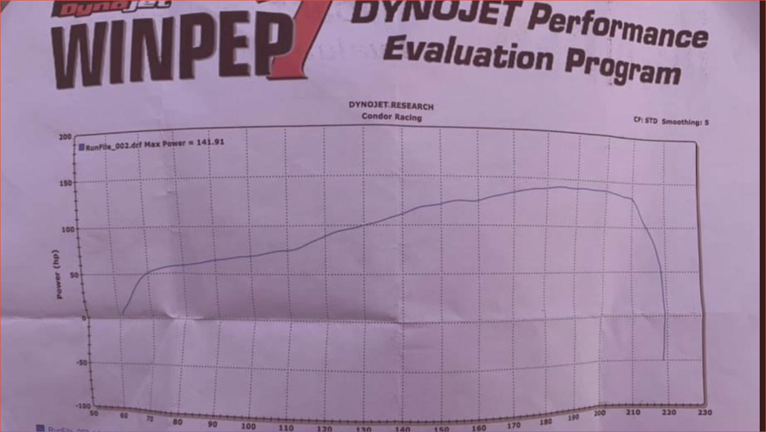

    Most damaging to my ego was my buddy's 2016 or 17 1200 DVT with a Rapidbike unit which pulled a 141.91 hp.

  17. Shame you didn't get a torque sheet too, as surely thars where the 1260 gains the most.
    Tell your mates that anyway ;)

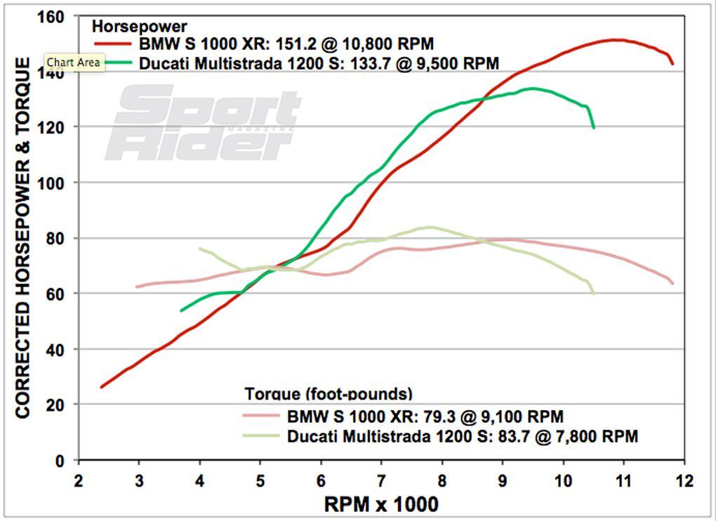

  18. More torque for sure but the Rapidbike unit on his 1200 made a huge difference over stock.
    141.91 with the RB vs 133.7 stock as shown here:
    https://www.cycleworld.com/resizer/...aws.com/public/QBSOH3JELOYNXHYIOFXIUDSNLE.jpg
    However, I'll get him back with a 100 KPH roll-on in sixth where the 1260 has a 10HP advantage.
    Here's his 1200S:
    Screenshot from 2019-09-30 20:11:13.png
    We both have the same gearing at 15/42.

  19. The trouble is @DarR, just how many people really do a 100kph (~62.5mph) roll on in top gear.
    I'm more likely to be in 4th at that speed, and drop to 3rd to wind it on for overtakes.
    So whilst you may have more power on the 1260 at those revs/gear it is irrelevant, I would be up the revs a few k rpms and likely match or even have more power ;)
  20. @John W
    True that. I could pick another combination of speed and gear.
    Like they say: "There's no replacement for displacement"
    Moreover, 1 hp at the top is meaningless.
