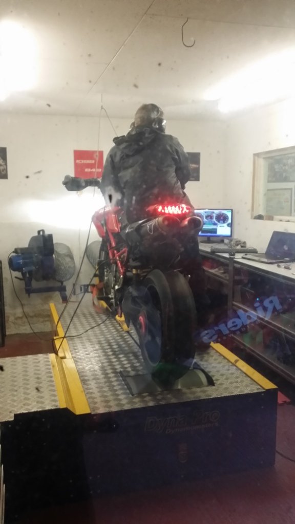

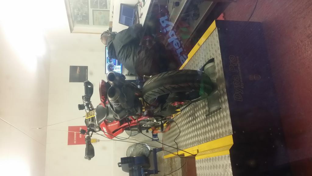

  7. Sounds alot better from behind! Been here for a couple of hours....got some video....

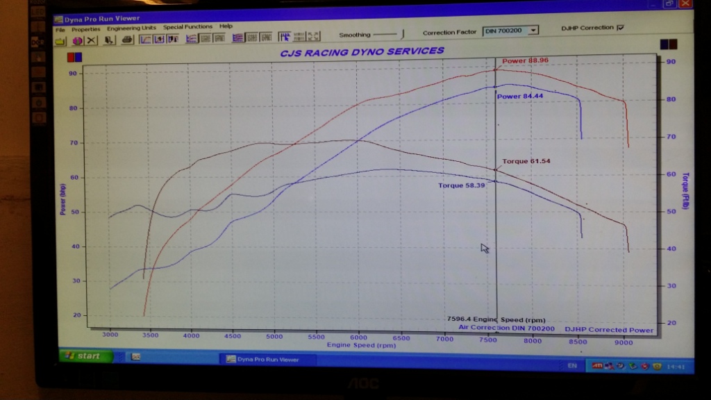

    First and foremost - why didn't I get this done sooner....as you can see from the output file theres some pretty big gains mostly at the bottom end (the net result is the ability to lift the front with ease now). No more chattering down the bottom end when filing through traffic. Feels like a new bike to drive. Laughing all the way from from Louigi Motos.
    Theres some information that Chris has access to that gives him a significant advantage over from what I can see any other Dyno tuner that tackles a Ducati (Also being based at Lougi is an advantage also). Essentially he's got a way of decoding whats actually inside the original dump from the ECu.
    Definitely not what I thought when it comes to dyno work...he's worth his money, when I was actually watching what he was doing and how he was doing it. programming a power commander is one thing but remapping an original ecu is another. He explained the differences between the way a power commander worked and the way the remap of an ecu works.

  9. From 50 to 65lbft in midrange. THAT will be fun to ride!
