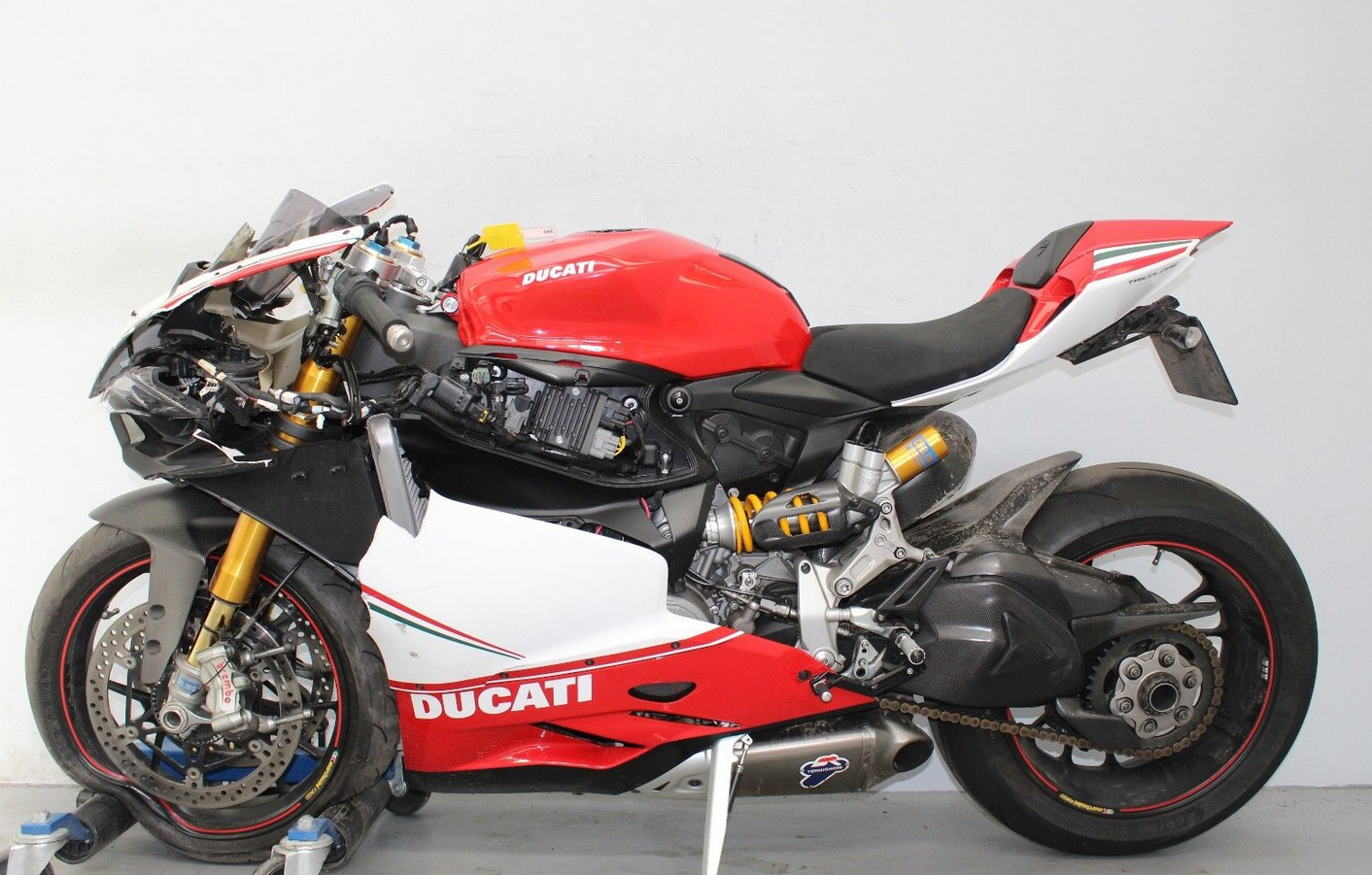

  15. It's in the link. 1199R started at £57. Andy
