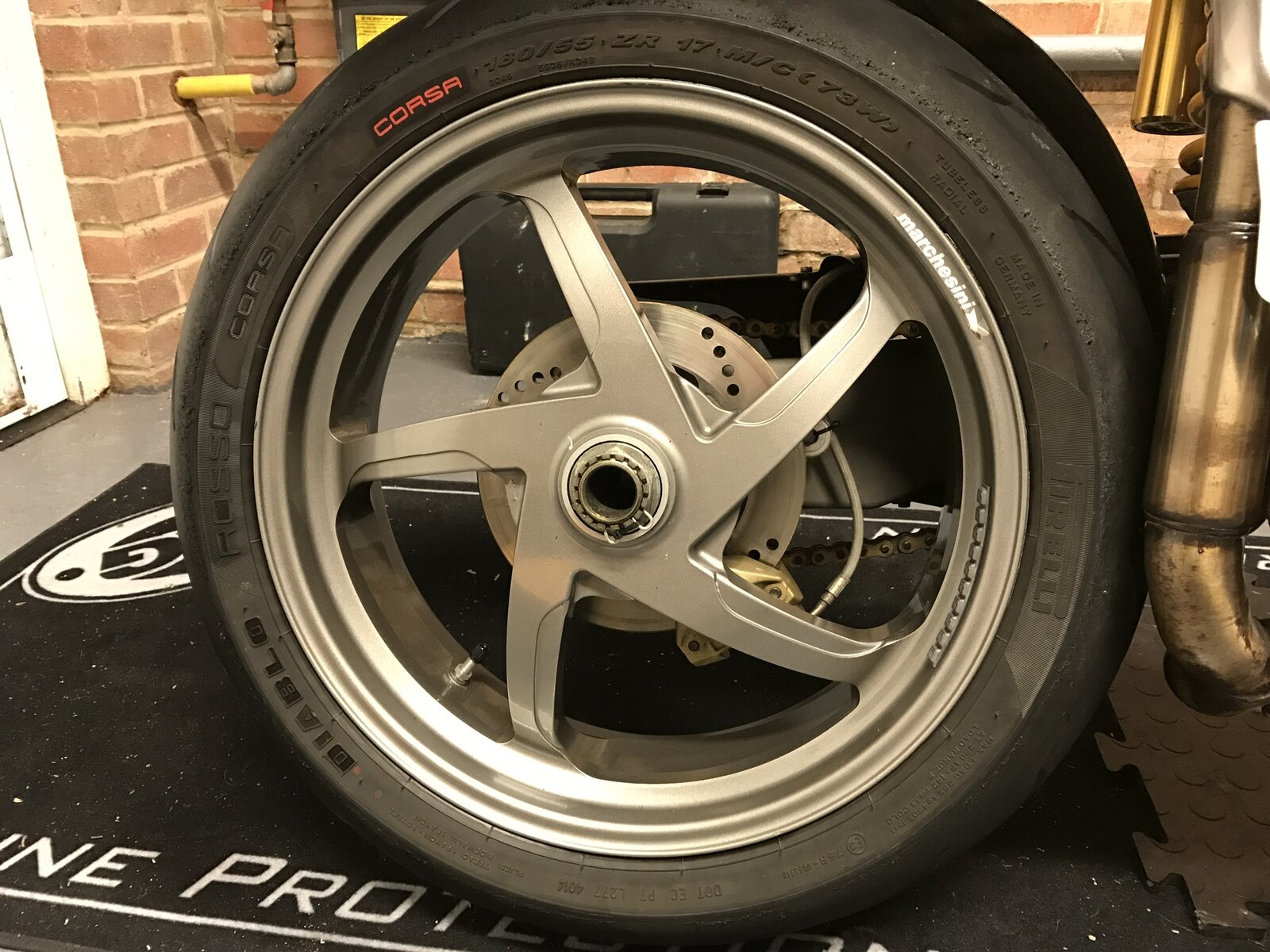

  3. Not sure I agree that the wheels are stock. They look nothing like my stock OE Ohlins 748R Marchesini wheels which are grey. Andy

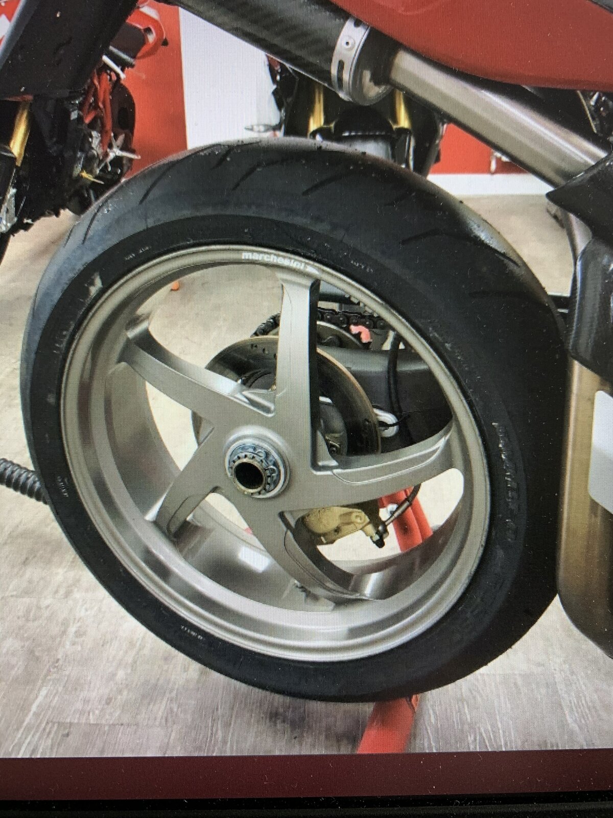

  4. this is a pic of the wheels from the add, and one from my mates standard 748r, identical.
  5. I’d attach a picture of mine but it’s locked up in MR. I don’t recognise the colour of your mate’s wheel but it’s definitely aluminium, the number of balance weights give it away. Andy
  6. I always thought the mag wheels had flat faced spokes and were a square section spoke without the cut out due to strength but happy to be corrected, another thread also :) I love a 748r
  7. No, you are correct, found a picture of my magnesium Marchesinis and the spokes of the rear are as you describe, flat. Every day is a school day :upyeah: Andy
