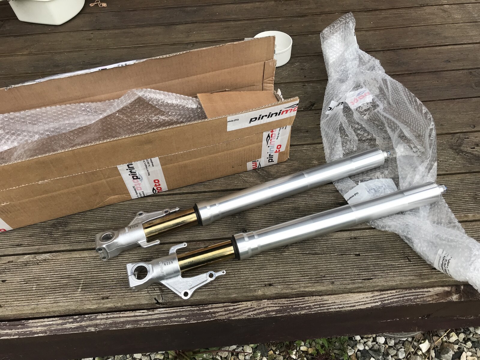

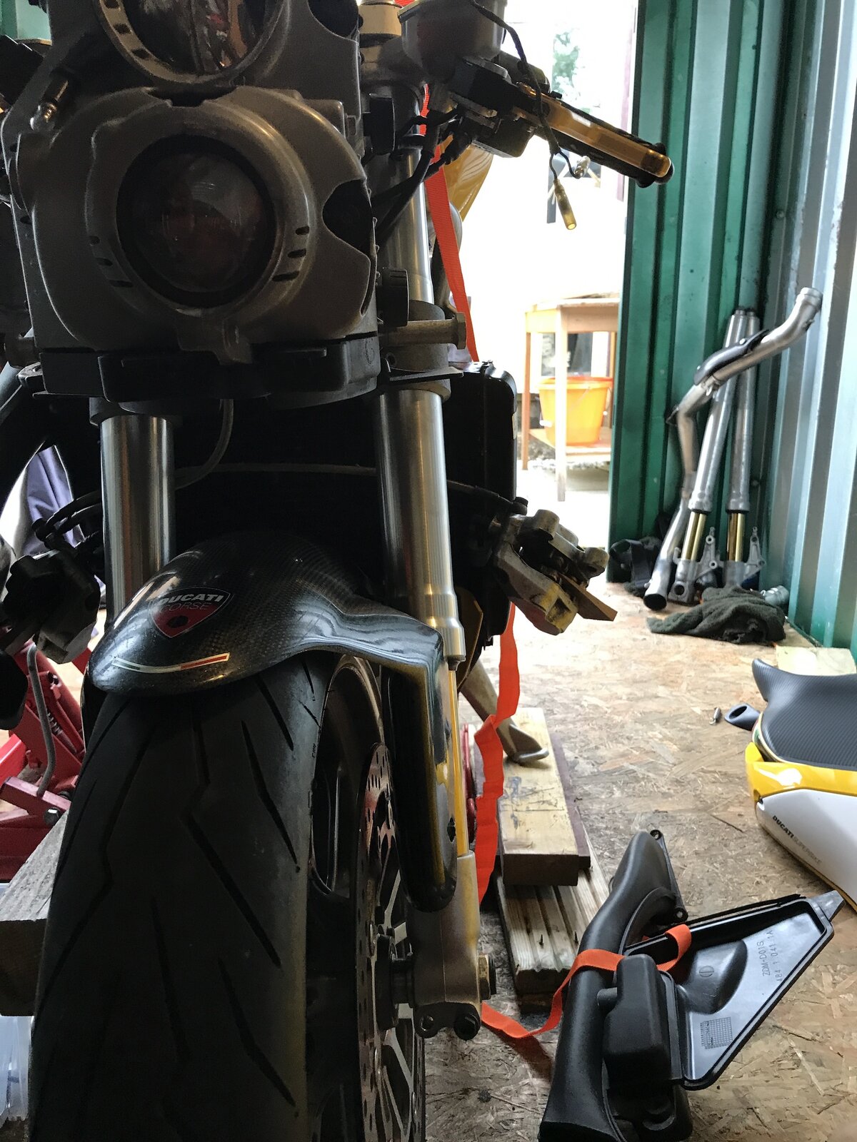

  2. OK, that job is done! quite nice to re-acquaint oneself with the idiosyncracies unique to the marque, some swearing accompanied by a noticeable learning curve.
    brand new Showa forks from Pirinimoto in Italy £350..beat that.
    Oberon slave cylinder is in the post so that's next job, but she is ready to ride now and fettling is optional as we go along.

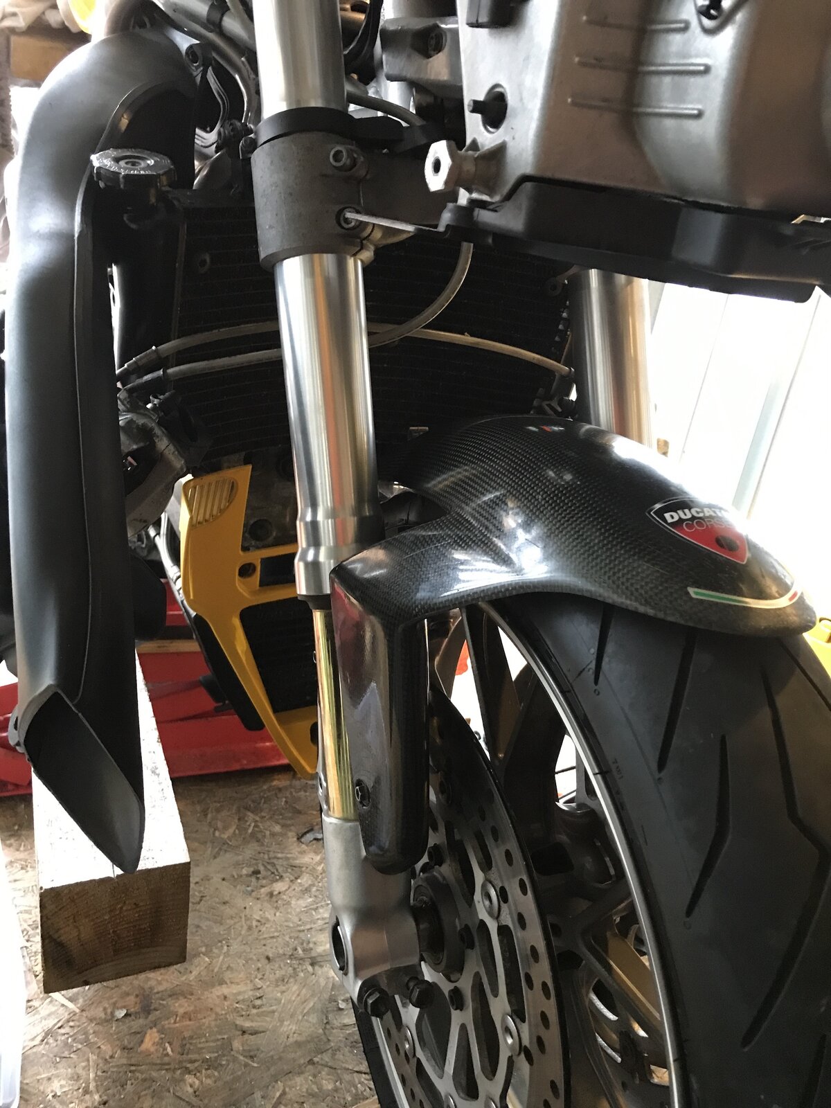

    anyone got rad/oil guard ideas? have you just made one yourself from mesh?
    the tank protector is really shabby, carbon look thing, how do you get that off? what to replace it with? IMG_1115.JPG IMG_1116.JPG IMG_1117.JPG

  3. Bargain on the forks :upyeah:
    Hot air gun for the tank protector.. peel very carefully...I once pulled off the top coat:worried:

  5. thanks for that Raj, what do you stick the new one on with?
  6. They normally have a sticky side.
  7. Make your own, the triangle on the bottom fairing fill with ali mesh, the top rad cover with the same mesh and plastic tie it to the outside of the rad

  10. The new Showa are great forks, how do they feel on the move?
    I use a rubber pad to protect the tank, they are effective too.

  11. You must have escaped the import duty etc on the forks?

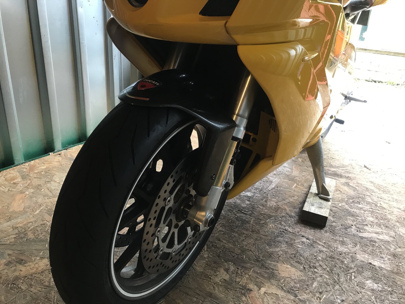

  12. i thought so untikl i got an £80 bill! still good value. handling is very nice, a bit of a push to turn in and then tracks beautifully, surprisingly plush really.
  13. Yes, still a good price, however it would be nice to know the state of play when ordering. Theres no consistency I’ve found.
