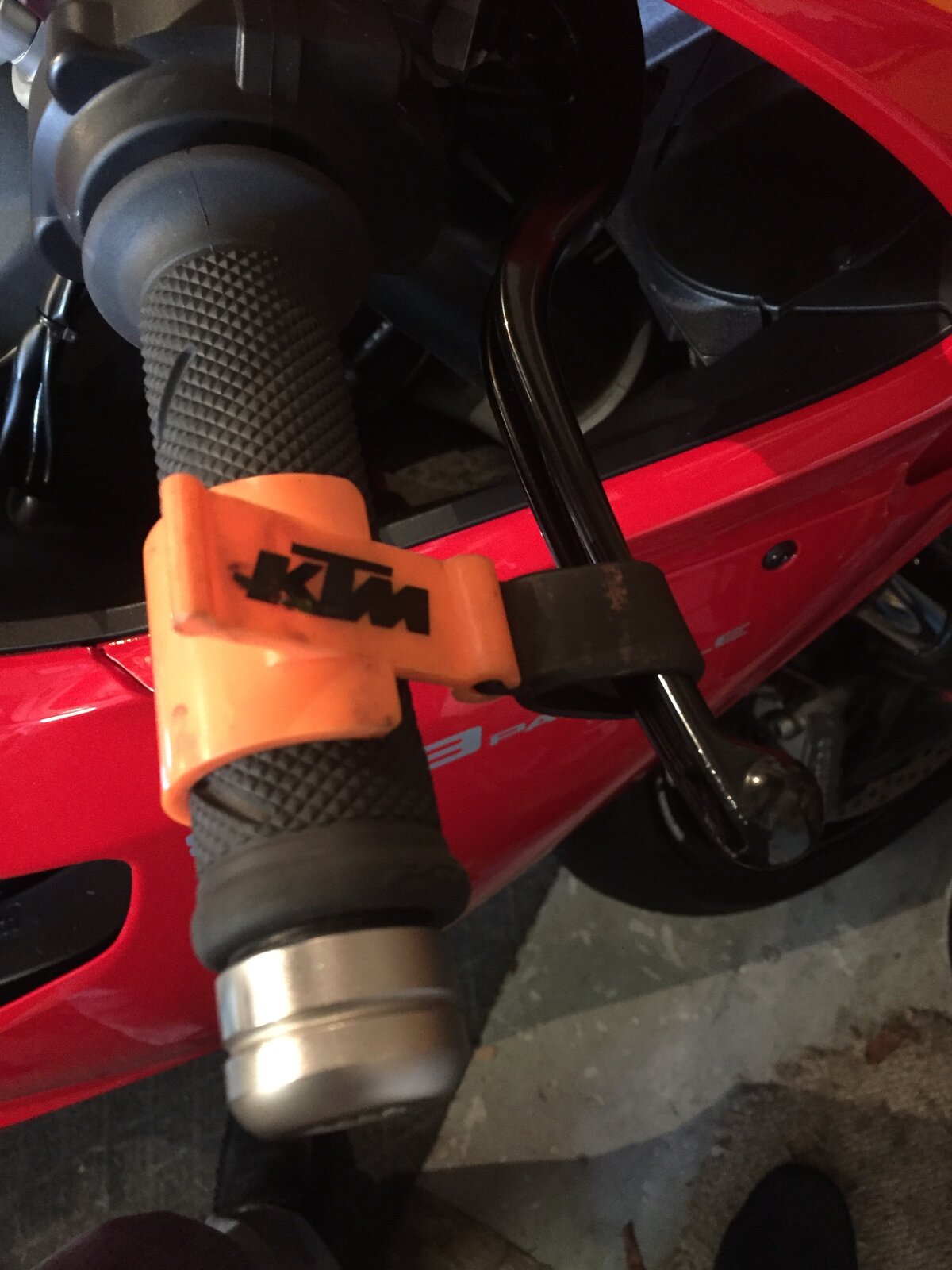

    I use my KTM handbrake to hold the pads on after I’ve aligned the wheel
    It was only about a tenner and has been really useful, it also gets used when I go on a ferry with the bike, as well as ratchet tie downs and being left in gear , I slip this on the front brake to make sure the bike is going nowhere...I know,...I’m a bit anal !!

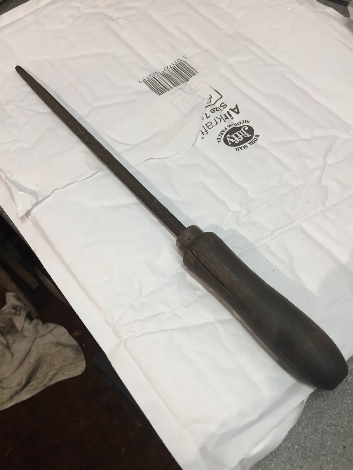

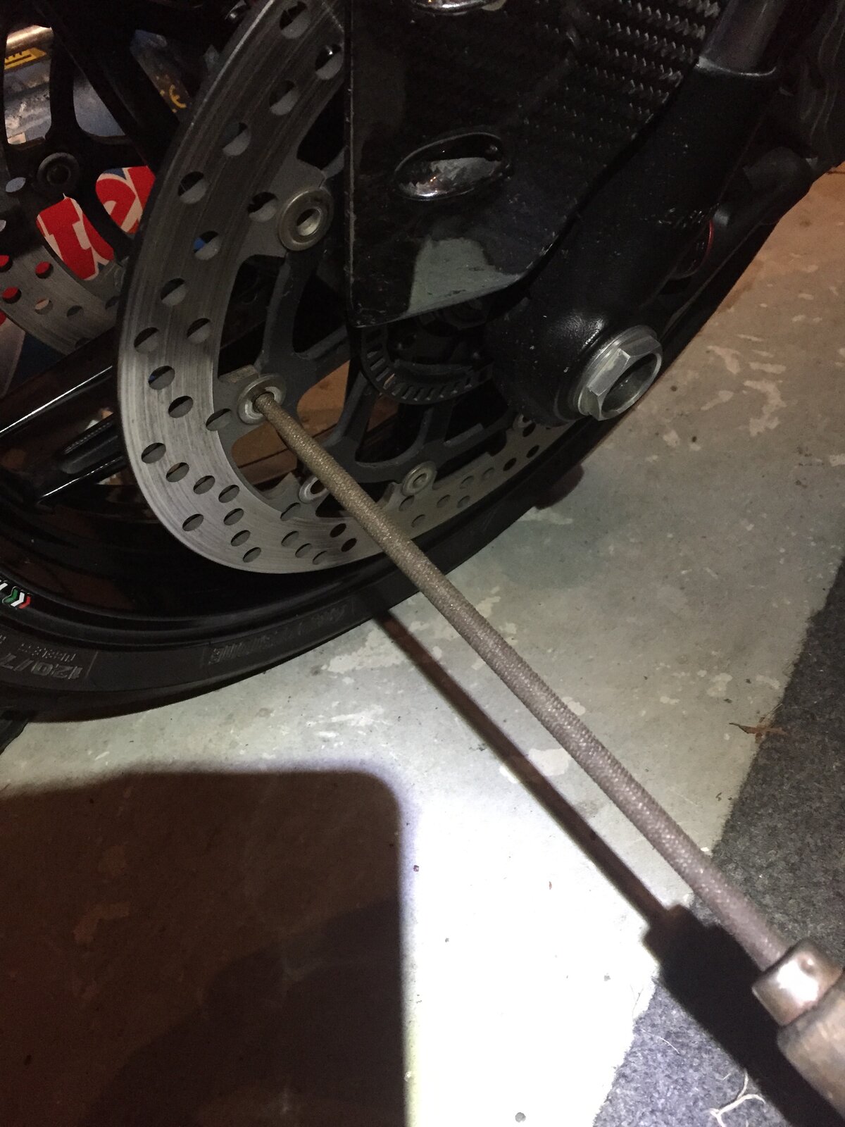

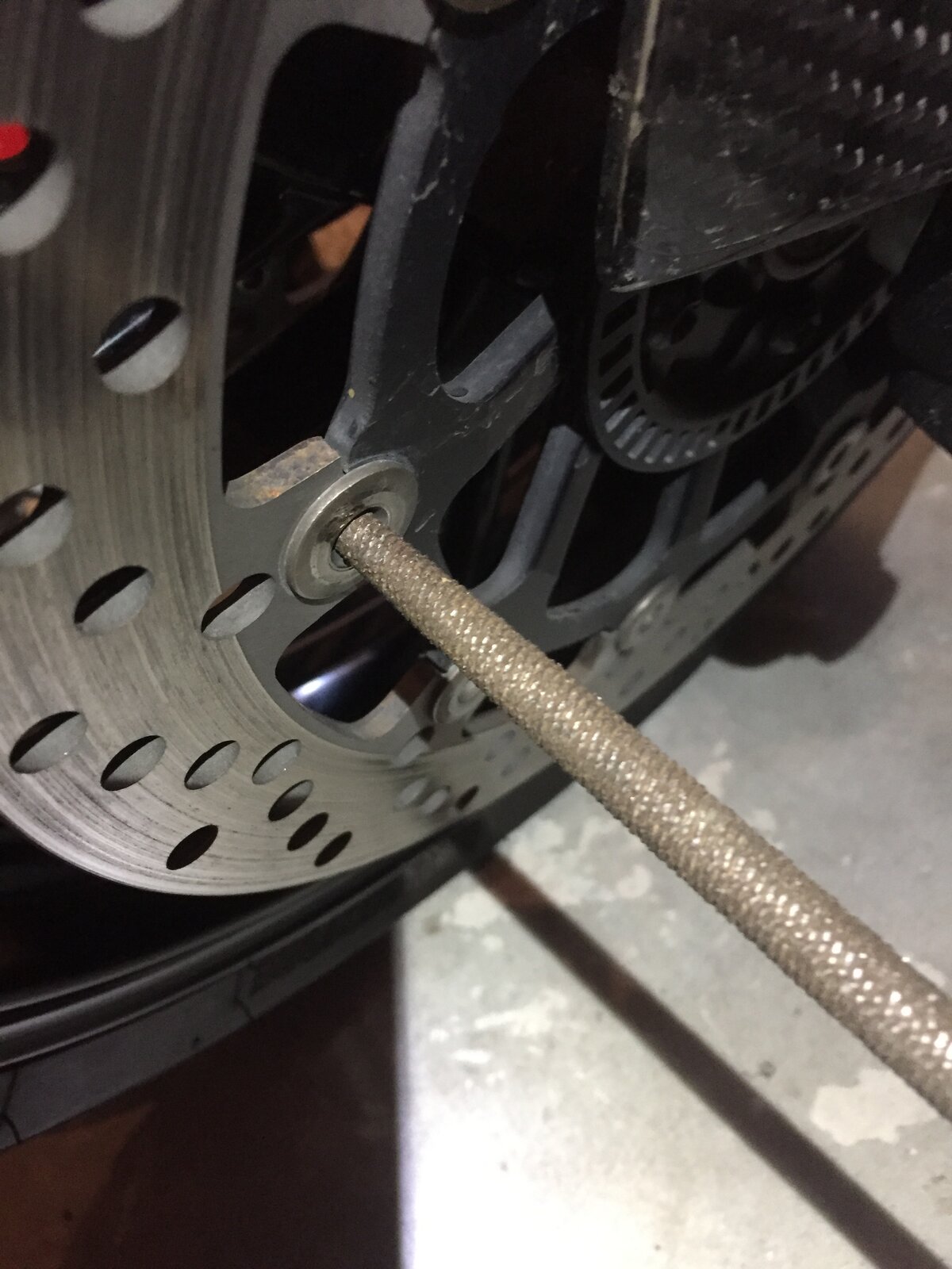

    By far the best way I’ve found of keeping your disc brake bobbins nice an free is to use a round file, as below..
    Find one that fits nicely inside your bobbins and grips well...
    This allows you to rotate the bobbin, so I give it a good soak in brake cleaner, spin the bobbin a few times and just kind of rotate the bobbin in a conical movement, about a 10 degree included angle, not much and you’ll see it start to chuck out a load of brake dust,...then give it another flush with brake cleaner to rinse off.
    Take your time working around all bobbins and you will notice the difference
    I don’t think bobbins are the sort of thing you want to be clouting with a rubber mallet, this file method is a lot more mechanically sympathetic I think :upyeah:
