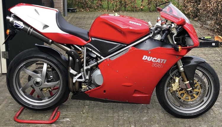

  9. 996R 136HP sandcast deepsump: ti rods.
    998 123hp die cast, no deepsump: steel rods
    998S/Bostrom/bayliss 136hp „sandcast“ deep sump exactly the same engine as the 996R, ti rods
    998S FE die cast and steel rods
    998R different era: 104 bore, 139HP etc
    USA versions are 123Hp and yes full carbon fairing, but don’t really care about the USA thingy

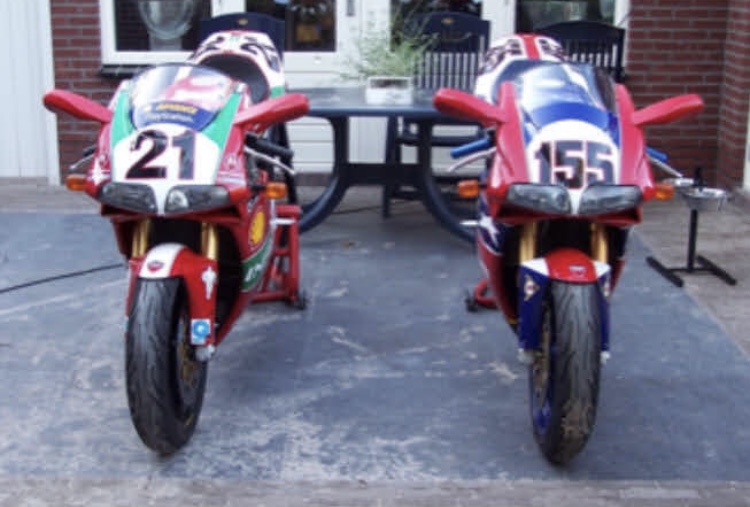

  11. Bostrom/Bayliss didn't have Ti Rods, same bore/stroke but wasn't Ti
  12. Line 2 in @DucRider 's post afaik
  13. So newer engine that went into the 999 but not deep sump
  14. afaik yes. The 998S engine is identical to the 996R homologated engine which is slightly different to the regular 998 engine, but both engines are testastretta ie narrow head.
  15. I had them both, Bayliss and bostrom. Both sandcast, deep sump, and ti rods, same engine as the 996R and the 998s (not the same as the FE 998s, that one has the deep sump, die cast 999 version.

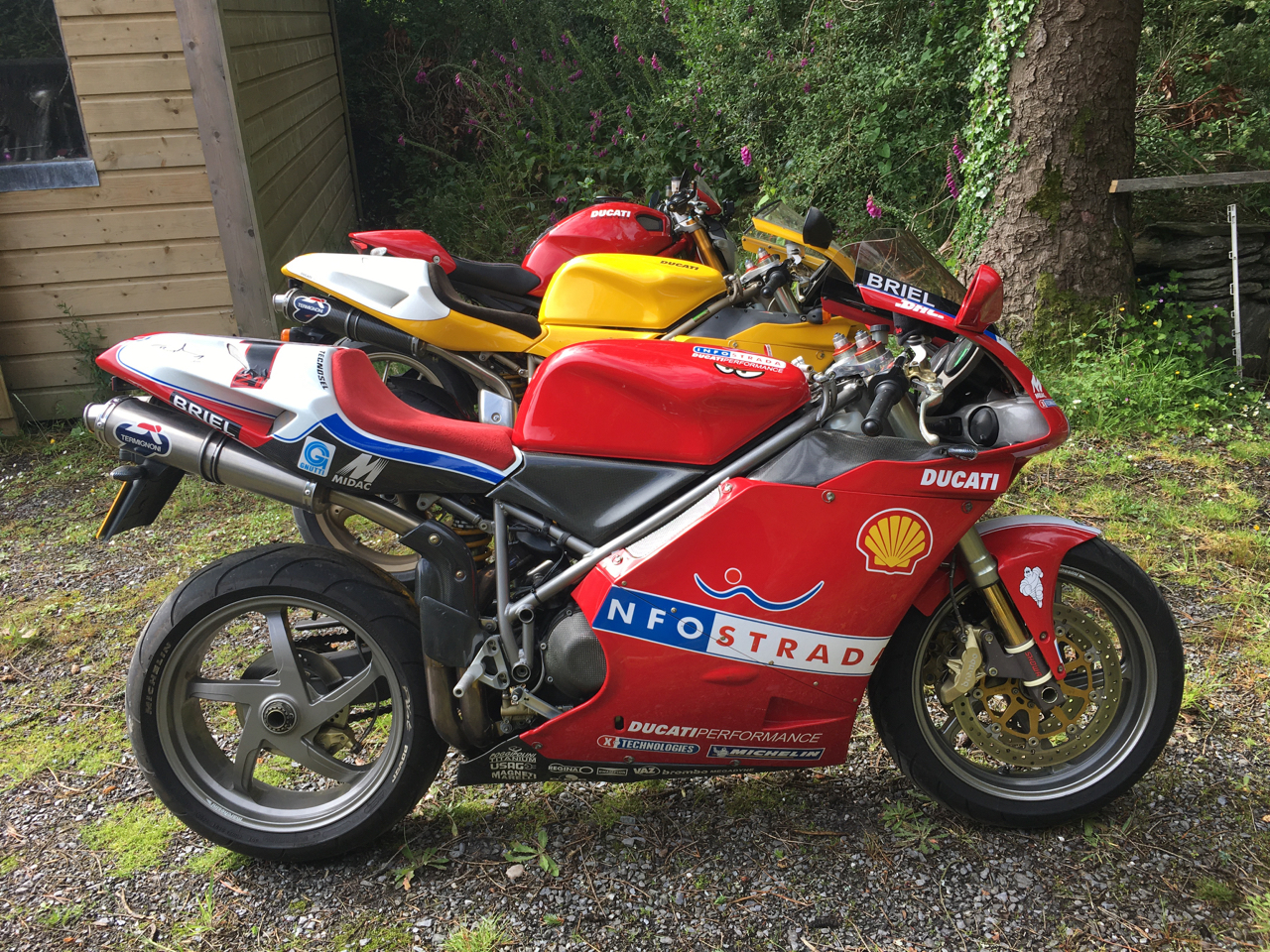

  18. I would always go for the S. Better engine and it will hold his value.
  19. That looks so nice :heart_eyes:
  20. :D - wait for an S
