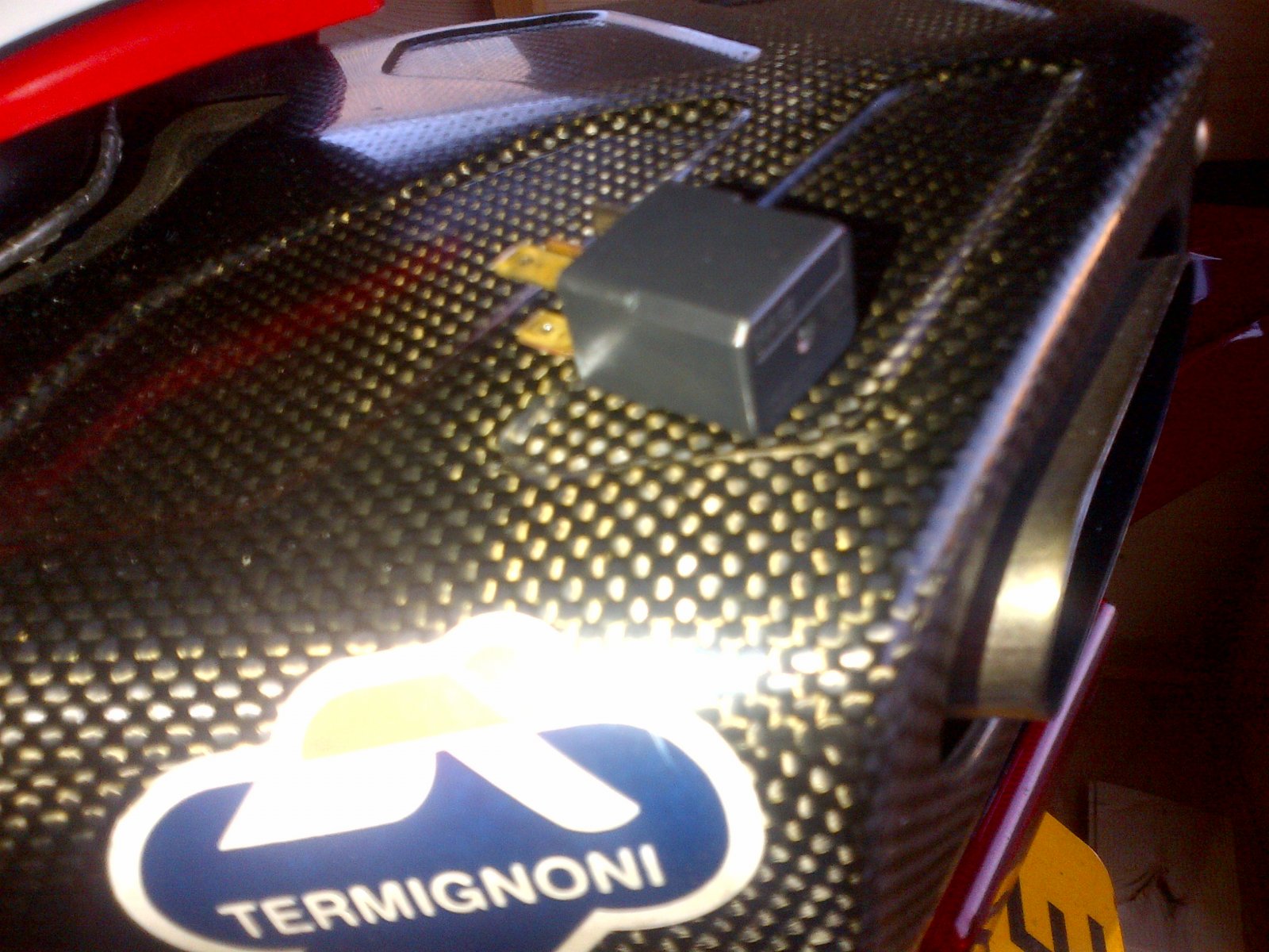

  3. Oops, Ebay price is only £79.95 not £85, plus the above mentioned discounts.

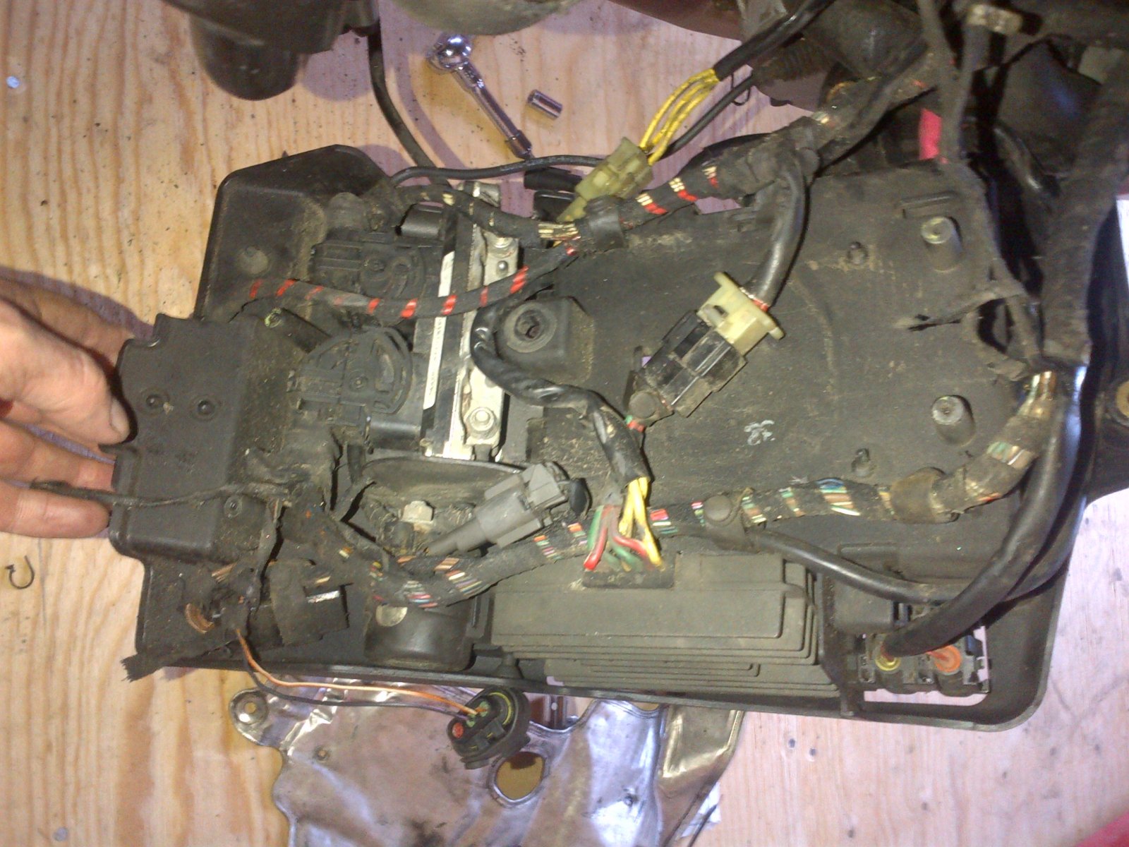

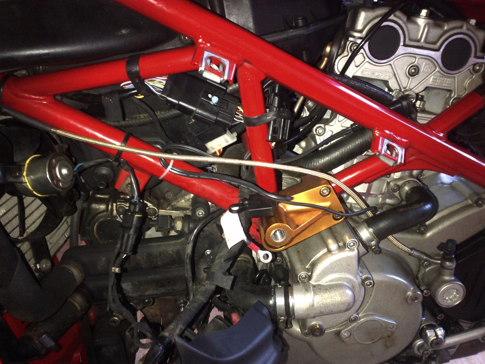

  11. ok , bike is starting and running good, but still not confident that the problem is not still lurking waiting to strike again when least convenient,,,, so stripped it down today to find the errant ( pos ) relay,,
    all conections to / from the battery are good , as is, from what i can see, the connections onto the solonoid ( i think i found it on the back of the battery box ) so , is this the relay, and if not where on the back of the battery box is it , or is it somewhere else in the other picture,, help please ..
  12. renew all the relay's anyway. first chance change the leads as well. you will be eliminating a lot of possibilities straight off.
  13. that i the only relay that i could find
  14. sure mine has three. anyhoo throw the old ones away.
  15. Will try to get nerw one ,,, nearest bike shop is 30 miles away , nearest ducati 150!!!!!!!!!! ,,, got sparky in work to test it ,, he says it is fine ,,,,,,,,,,,,,,,,,,,,,strange thing is that the bike is starting and runing fine again !!!! Leads and connections all look good ,,,,,, how easy id it to replace the battery / starter leads , as per exigy. ( Fairings are off and battery box / heat shield already dropped down )
  16. PM your email and I'll send you the instructions so you can review, you've done the hard bit, just need to get the heat shield and harness routed back where it was.
  17. piece o piss. and throw that old relay away.

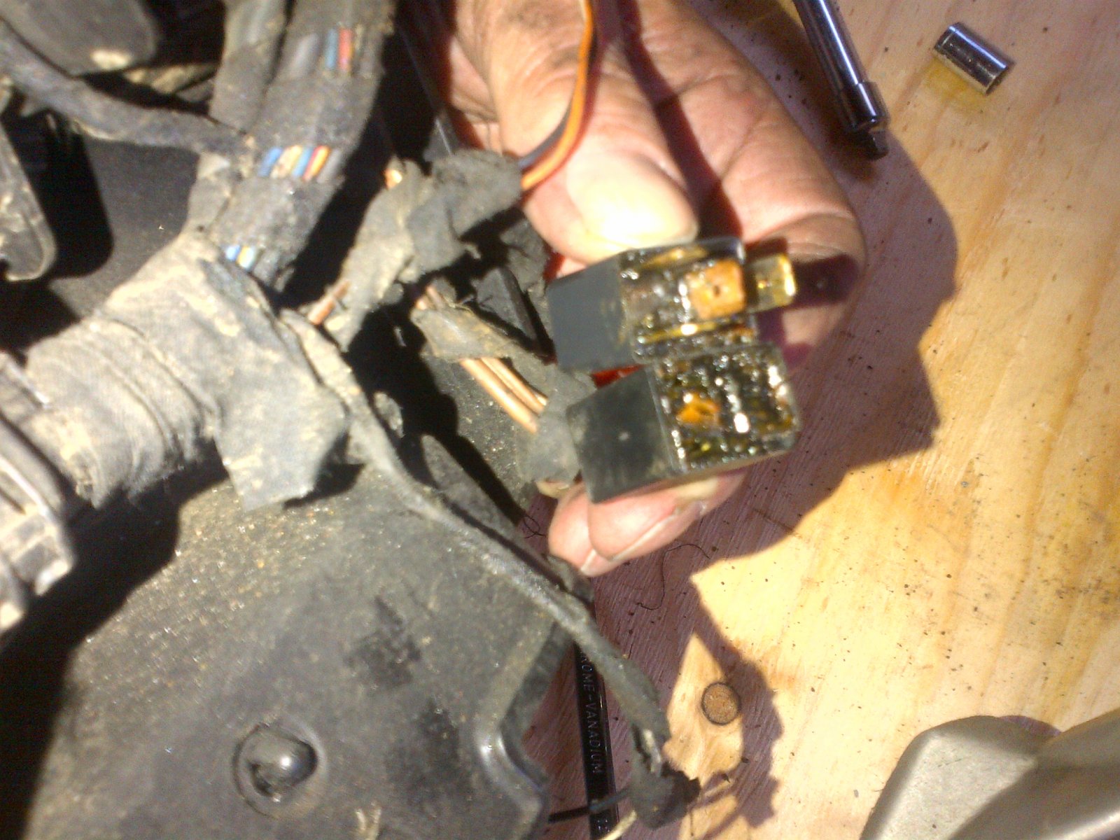

  20. The relay could appear to be ok when tested by the sparky, but it's not really a definitive test.
    The contacts on the relay are tiny and deal with arcing everytime they operate, eventually leading to errossion of the contact material, which can then lead to intermittent problems.
    For the small cost of a new relay it's a no brainer to replace it to eliminate that as a potential problem.
