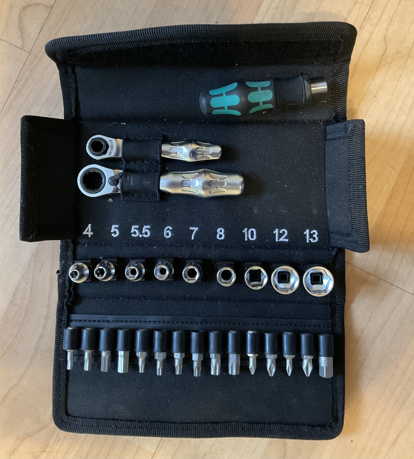

  1. Wera….. mmmmmmmm, nice
  2. I've used Wera for years - good kit.
  3. Wera nice.. seems they have a very good reputation, I'd seen their kit before, but never realised it ranked so well. Thanks for the pointers.
  4. And they do an ideal, small, get you out of trouble, kit. Andy
  5. where the hell do I store it :bucktooth: just no space at all.. would fit the older one ok I guess ? :)

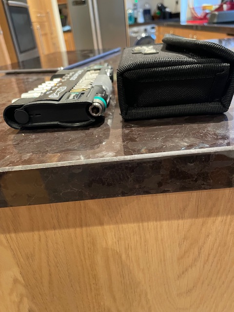

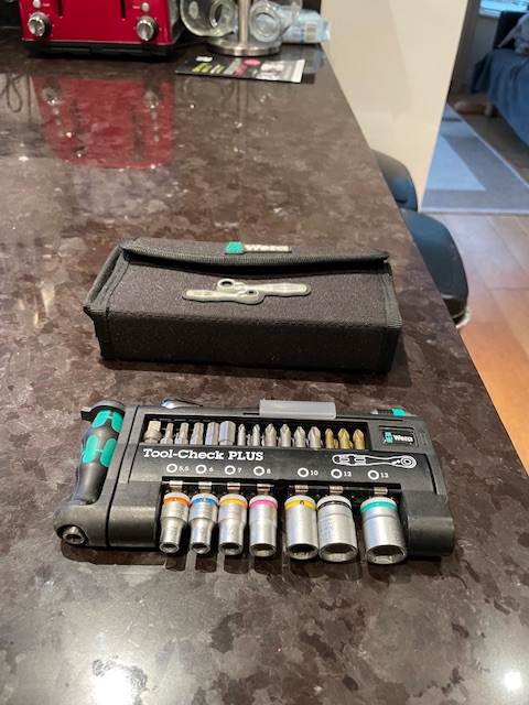

  6. The tool check one packs up smaller for under the seat storage.
  7. That is a brilliant design... ! Still not sure it would fit anywhere on the Panigale style bikes, but easily pop into the 996

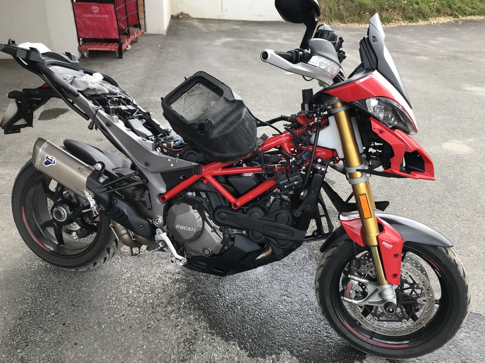

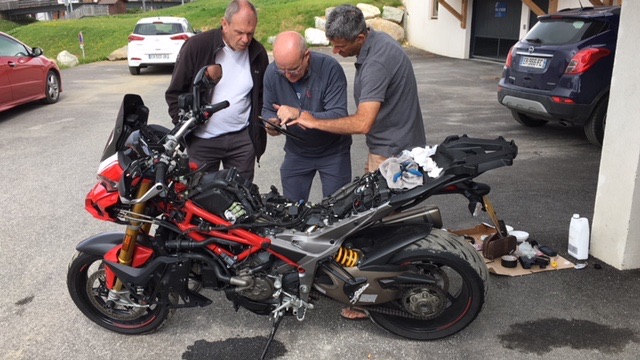

  9. I have the same one which I take on tour. We once used it to dismantle a Multistrada to fix the Y shaped hose in a hotel car park in the alps.

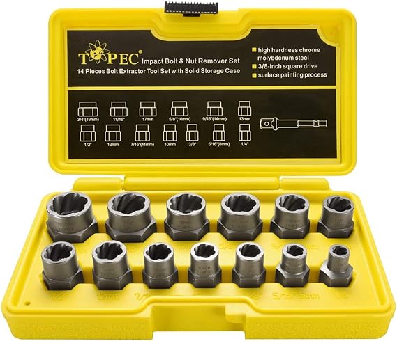

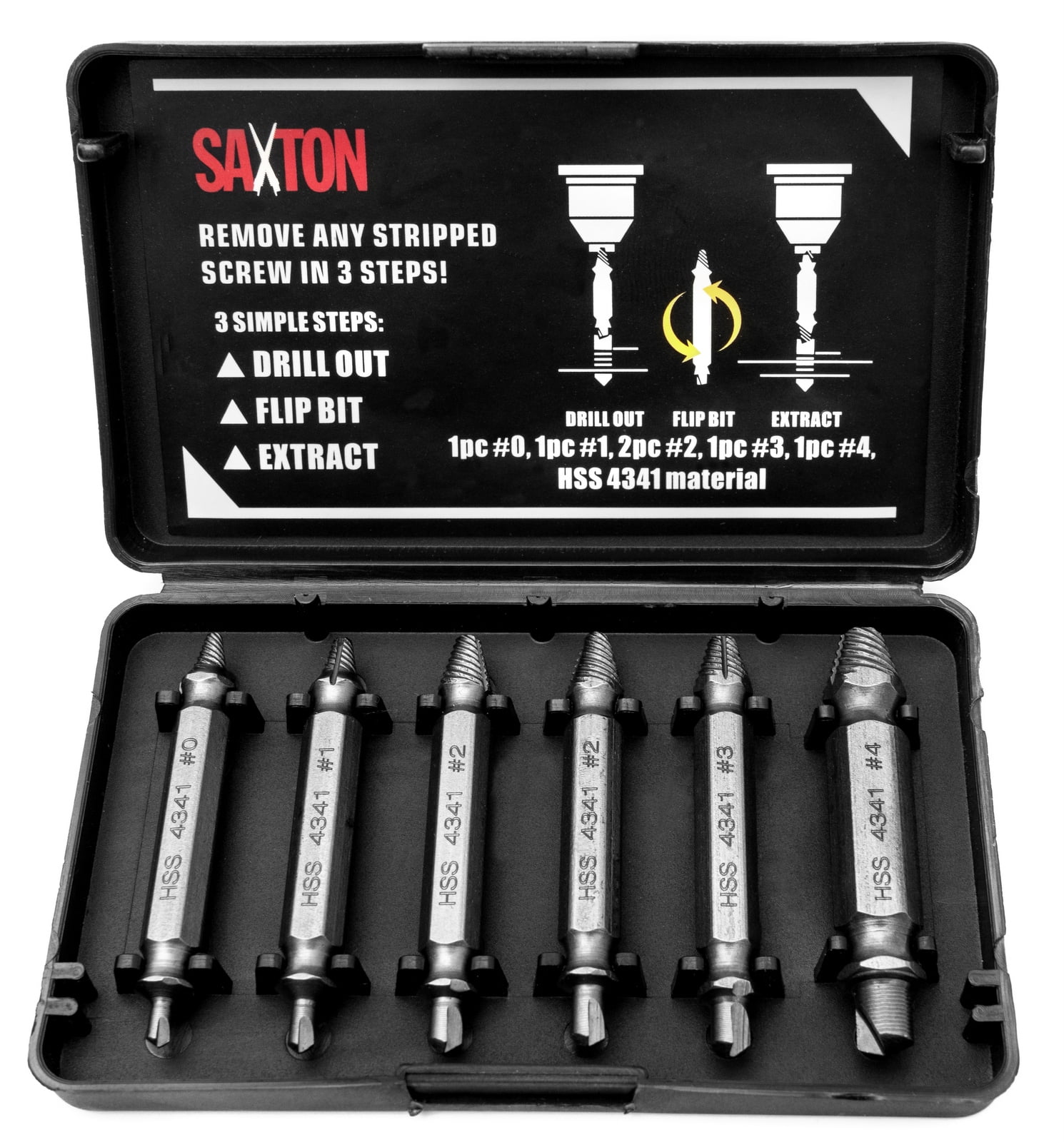

  11. seeing as we have gone for general advise on how to remove dodgy fasteners. these are awesome. particularly the first pic with rotted heads. i put off buying them cos they looked pish. but the lads bought a set and jeezo. superb.
    back to the original fault, forgive the upcoming gloat. i never break a bolt. (which no doubt means i will break everything ii go near when i'm back to work) as soon as you notice capheads or any splined bolt is starting to slip, stop. get yourself an appropriately sized punch and hammer and just start tapping away at the top of the fastener. it will tighten up the spline of the bolt and slacken its grip on the threads.

  19. all failed so far! have some easy out type things, and thought I would wait for the local garage to open this week to see if they can do anything before I irreparably damage the bolt heads. lots of reviews seem to suggest the same risk with the easy out things, seems like a 50-50 fix vs making it much worse. will probably, as you suggest, need to buy left hand bits to drill before trying the easy outs if I do try them. my last hope is to ask my brother who is a dentist to get his micro drills in and sort it out.
