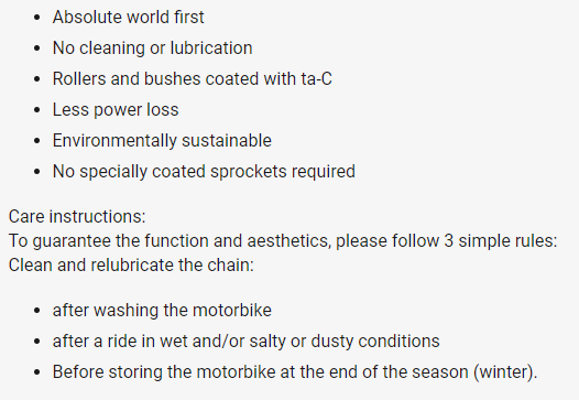

  4. Those instructions are a bit miss leading , see photos of my chain , no oil just soap and water and a rag.
    I think its a guide for the stupid. I spoke to Regina direct and as he said , no oil needed just general sensible maintenance but again no cleaners or chain oil.:upyeah::upyeah::)

  7. The Regina document linked in #20, states, “to guarantee its best functionality and aesthetics over time, follow 3 simple rules, (1) clean and lubricate the chain after washing the bike, using the bike in wet conditions and/or salty or dusty conditions, before storage (2) relubricate the chain once a year (3) check the tension every 3000km. I appreciate your experience but I’ll stick to my RK chain and follow Reginas’s maintenance regime :D Andy
