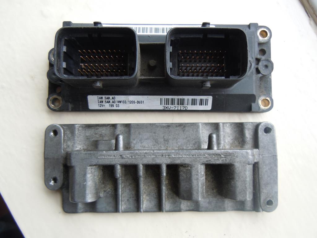

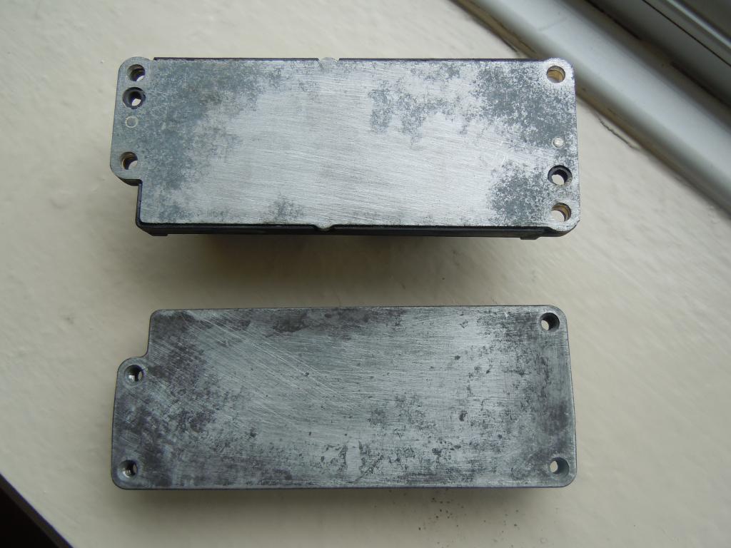

    took the ecu off
    Ok ....4 torx srews holding it together.....well I've never seen inside one of those so lets have a look......screws out and it separates mmmmm a heat sink which the earth was connected to and another piece (riveted and plastic welded together with the processors and connectors) but the joint between heat sink and circuit board is full of corrosion..[​IMG] .aluminium against aluminium.
    cleaned the faces and greased them(copper slip), reassembled, reconnect plugs and battery(now fully recharged) pressed the button and the beast roars into life.
    it would seem this time the earth for the ecu was not good enough through all the corrosion.
