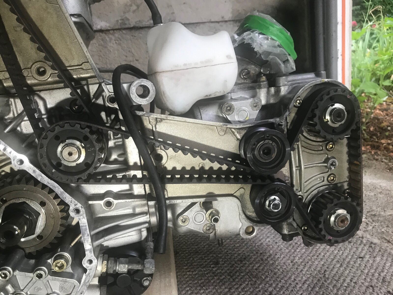

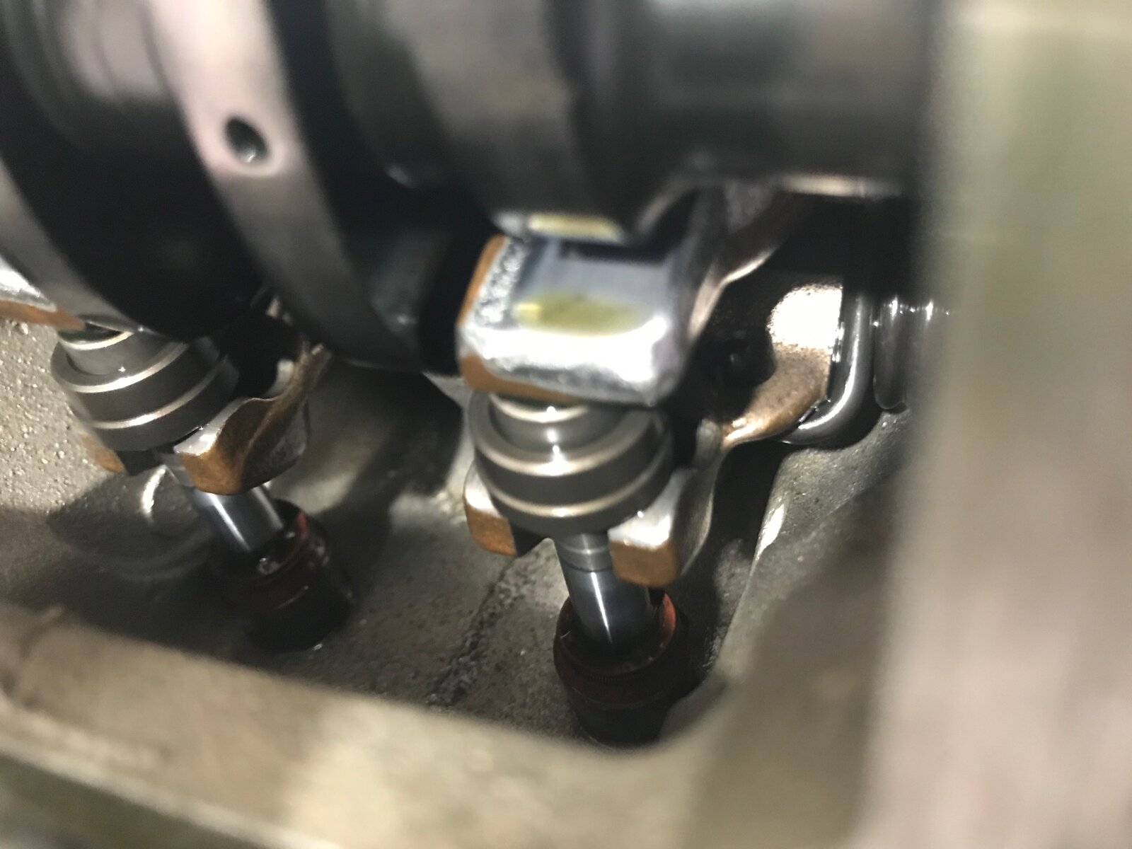

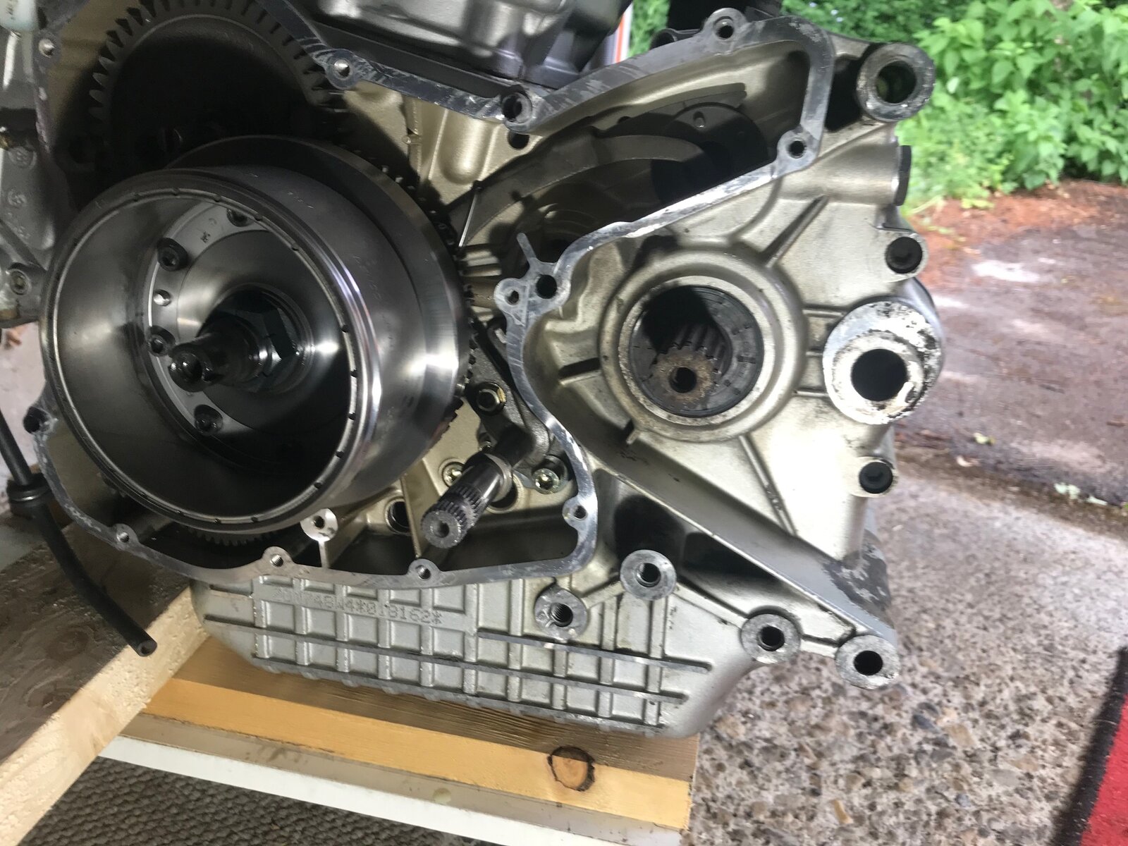

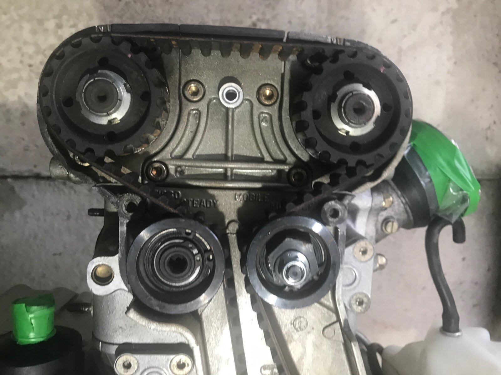

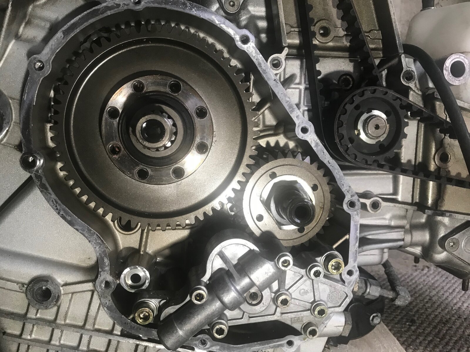

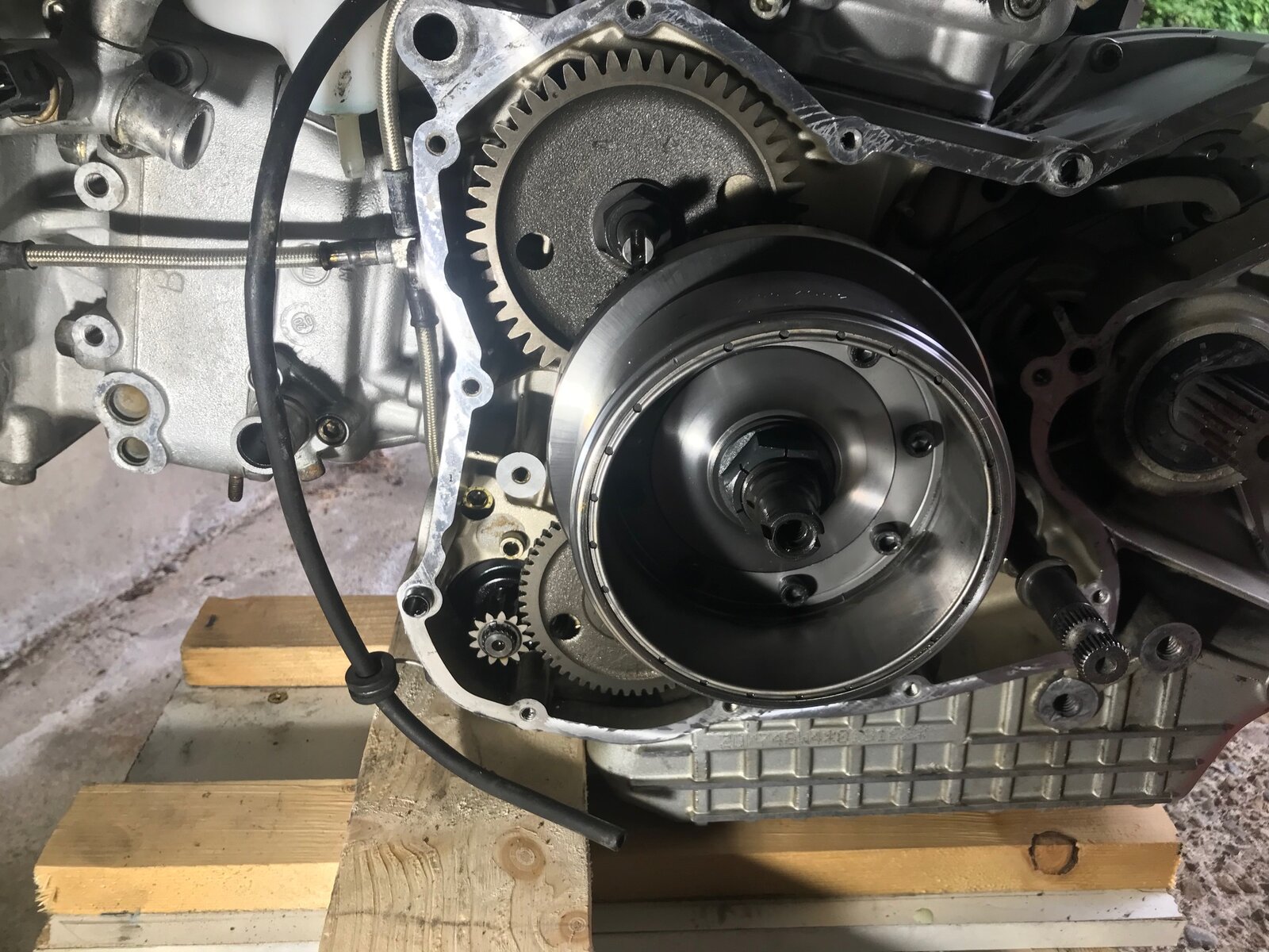

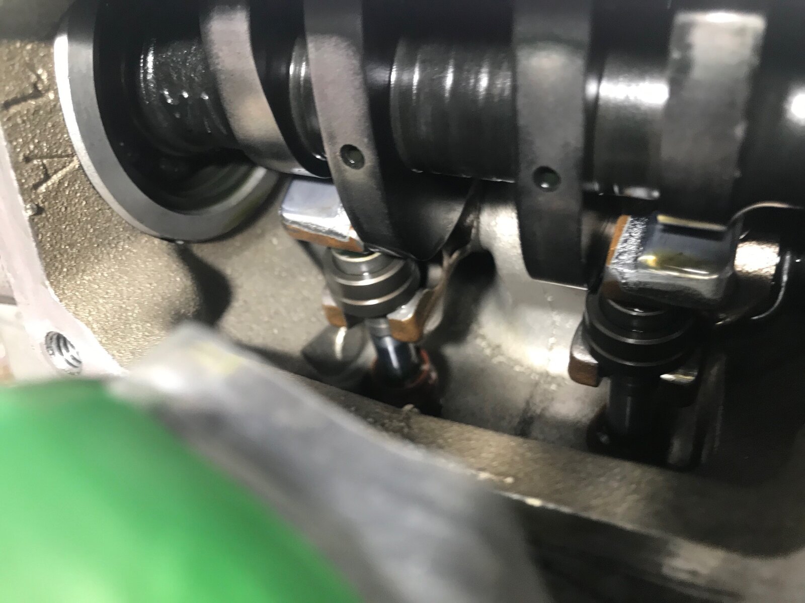

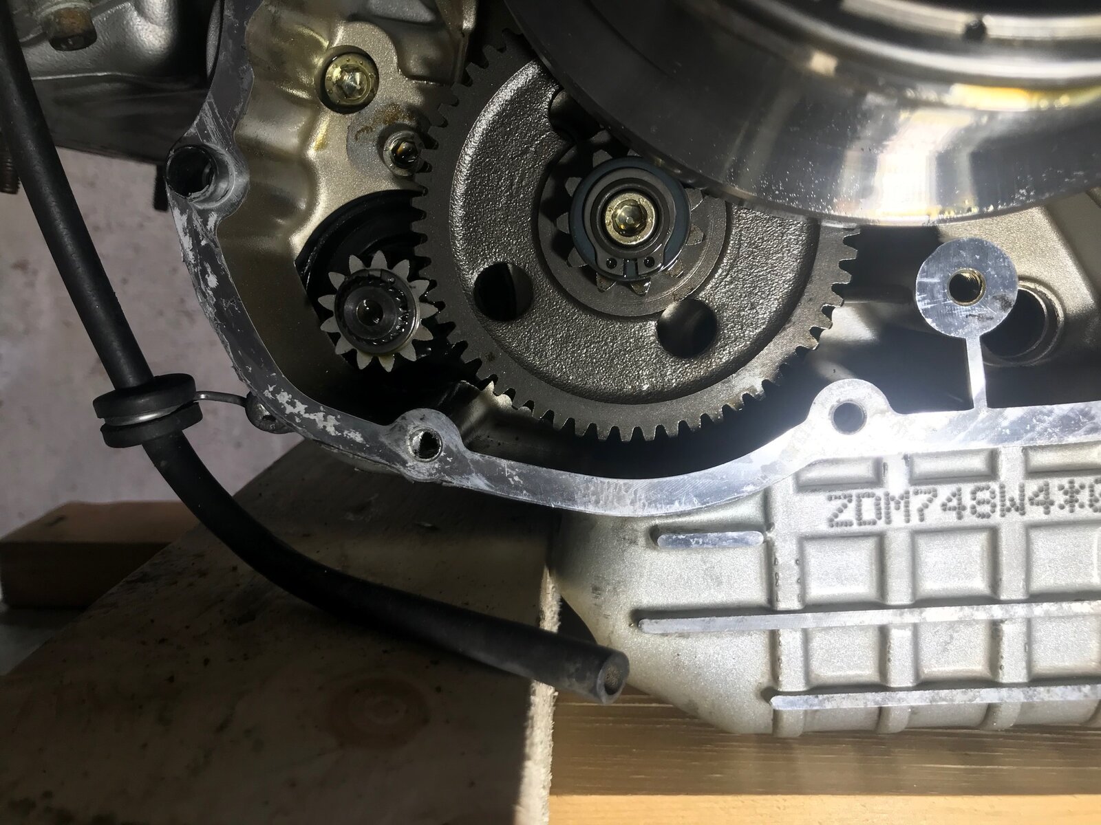

  5. So I've taken advantage of lockdown, dropped the engine out and started to strip it down just out of curiosity/boredom. Got both cases off but not the heads yet. Everything turns by hand so I'm assuming problem is with the crank? If I'm correct how much of a problem is this?
    I plan on calling Ducati John tomorrow but is it worth taking the heads off anyway and splitting it? IMG_0885.jpg IMG_0886.jpg IMG_0887.jpg IMG_0888.jpg IMG_0889.jpg IMG_0891.jpg IMG_0892.jpg IMG_0893.jpg

  9. I put a 748R engine in a 748S frame, easy enough swap but you lose the big injectors and airbox. I then had it mapped by CJS and it put out 104.5 BHP which, in theory at least, is 1/2 BHP down on the 748R. Top speed was rated at 148MPH as opposed to the supposed 150MPH of the 748R.
    After a bit of use, the main bearing went and I had the engine rebuilt by Ducati John. He stripped the engine in front of me and showed me exactly what needed doing. Although a while ago it was £1600 for the whole job of which £900 was Ducati parts alone. He also supplied an oil filter and removal tool as part of the price.
    Well worth the cost and there were a lot of worn parts in the engine including a few rockers, and main and rod bearings.
    From that experience, i would say get an engine rebuild or get a very cheap engine and have that rebuilt. I bought a stock 748 engine for £200 a while back, that was from a running bike with no reported problems. It was sold as the person was upgrading to a 748SP engine. I would happily have that rebuilt should\when the time comes.
