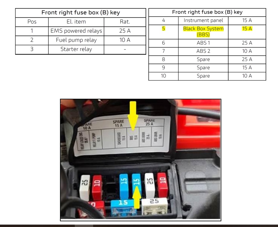

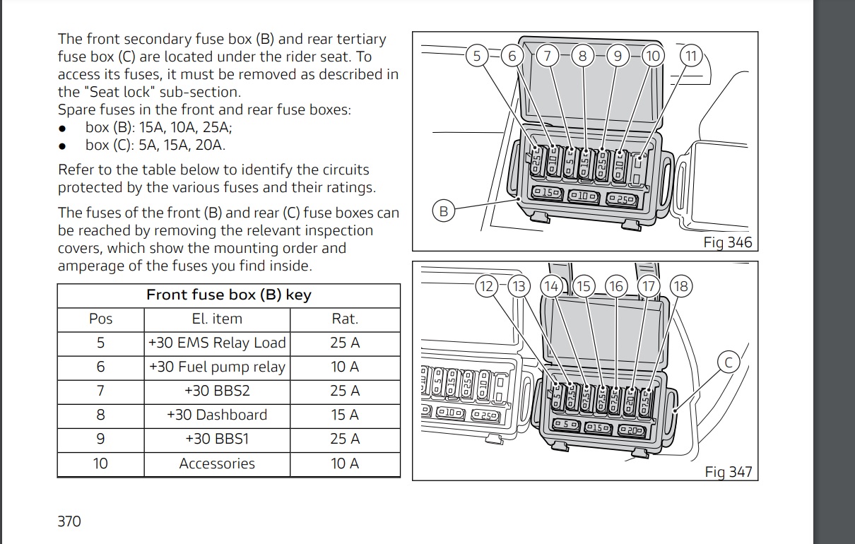

  4. I just ordered brentune for my 22 Ducati Multistrada V4S.
    Looking through the resources tab the description of location of fuse box is not the same as my bike.
    I've included two pics one is from btmoto site the other is from my owners manual.
    On my bike it's showing a bbs1 and bbs2 fuse which do I pull before writing ? Thanks Buck

  5. Email Brentune. When I installed mine on my Streetfighter they were excellent at promptly answering my questions.

    Somewhere in the process the PC app prompts to download a file whidh implies you have to start pulling BBS fuse when uploading to ECU - I asked BHP and you don't need to.
