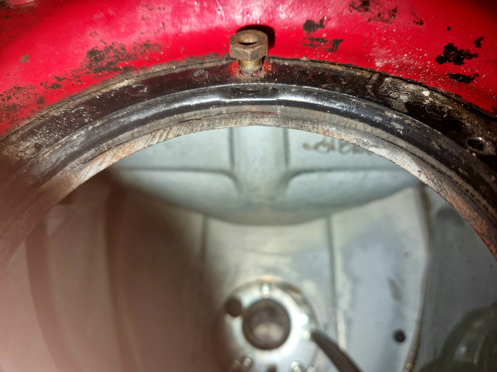

  13. I haven't looked at my 916 tank in a while but I have just done my MV pump new pipes and filter.
    While searching to see the best price I could get the Gates fuel pipe for I found some info on the MV forum.
    They reckon the risk for splitt/nicking the o ring can be reduced by filling some holes in the baseplate with epoxy. Now these holes are adjacent to the three mounting bolts for the base plate. I did mine and smoothed them out with a little flap wheel in a dremel
    The MV pump is the same but I don't know if the tank side is the same.
