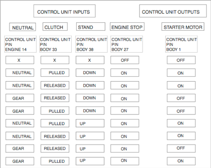

  4. You're unlikely to get one with the immobiliser disabled already.
    You'll probably need to find one on ebay and then get someone like Chris to flash it with a map for your bike and hopefully disable the immobiliser too.

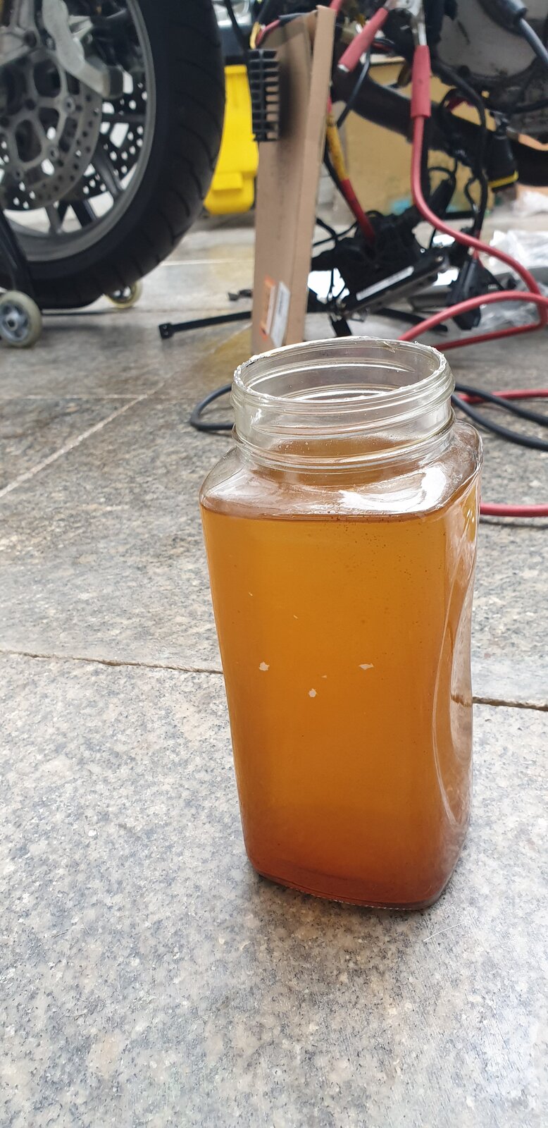

  8. Decided to remove the tank and get rid of the old fuel. Wasn't expecting this ...... 15608489337935915283402612933115.jpg
  9. is that marmalade ?
  10. Yeah, must have been owned by Paddington bear at some point. Who was also using the tank as a swarf bin judging by the slurry
    A full service history followed by several years of neglect ..... hmmmmmm
  11. That can’t help...
