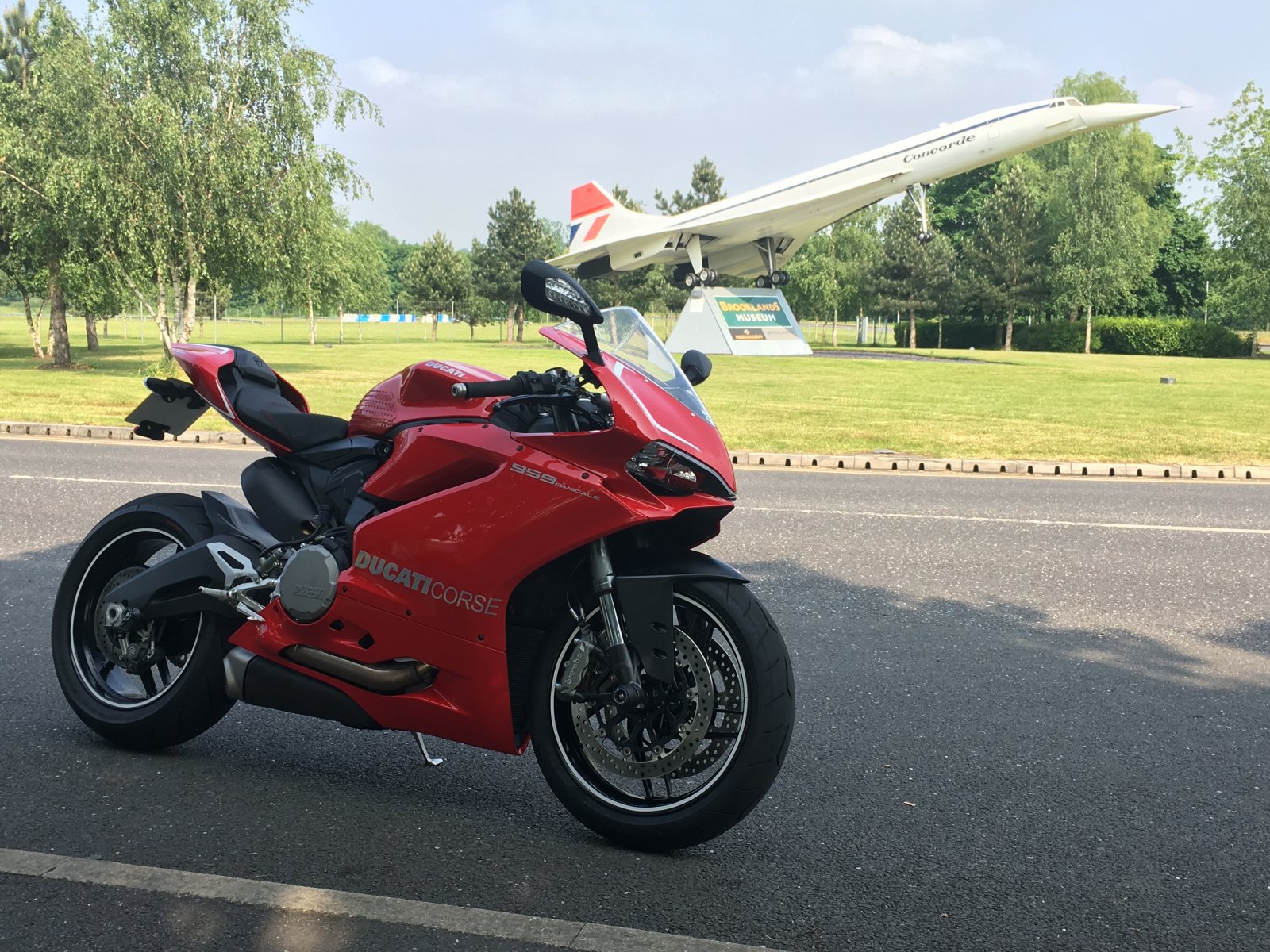

  1. I've only had it on tickover warming up and it is fine at that. Once I've tidied up the mess in the garage I may take it for a little run to see if the check engine light comes on.... But it is booked in Thursday to sort out any issues anyway.

  2. You getting a remap or just error code deleted?
    So the valve is completely removed now?
    I wonder if leaving the motor plugged in will stop any error messages? All you do on jap bikes anyway
  3. I have left it all plugged in for now but removed the cable that moves the valve.
  4. Hopefully that works. Used to always work on gsxr, r6 and fireblades I had previously.
  5. No luck! I'll get it reset Thursday, so no problem. Looks and sounds (and subconsciously feels) like a different bike now.
  6. Good job. Tempted to do this myself
  7. No more catching those silly pipes with your right heel either!

  19. As far as costs, for anyone considering it....
    Full US system on eBay £279 (actual cost was £225, but this includes shipping/taxes etc)
    Fairings £400
    Total £679
    (edited because I paid less in shipping/taxes than was estimated)
    The handy thing is that I have the lower fairings now if I ever decide to upgrade to the Akrapovic. If you want to do it on more of a budget, it would be possible to cut your existing fairings, but you would need to get the cut edges tidied up.
