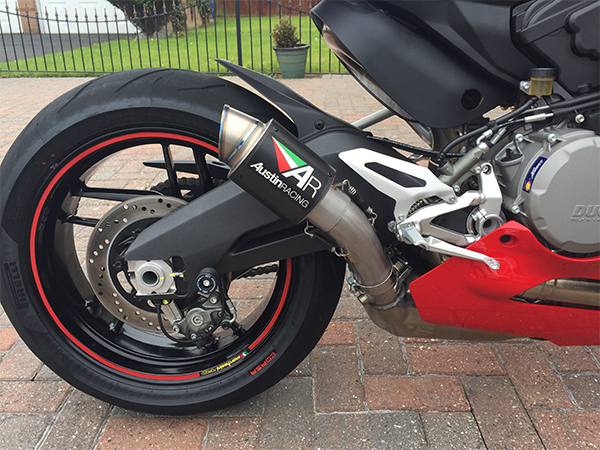

  15. No, the one in the photo just replaces the tail pipes and retains the standard Euro 959 under belly section. Including VAT etc it is £670 (PANIGALE 959 SLIP-ON EXHAUST SYSTEM
    You can take a race pipe on track if you pass the static noise test for the noise level of that day. The problem is that even standard Panigales fail, and race cans just make them louder. Therefore, to accommodate Ducati, they have the caveat that if it is standard you can go on even if you fail the static. Pass the static on anything and you can go out. It is fairly open and straight forward, and I haven't had any problems yet...
