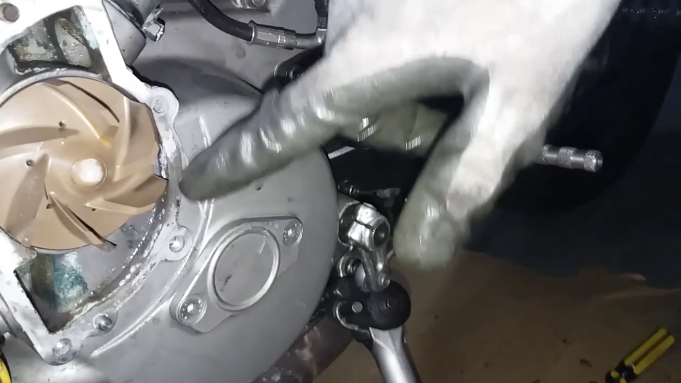

  9. The engine of the bike is adjusted with panigale elektronics and a bigger airbox so there is not a lot of space. I have got the bigger radiator wich fits the oem bodywork with two smaller fans. When both fans are on the temperature will rise slower but it rises. How can I check if the thermostat is working ok and the waterpump is working ok?
  10. I’m not sure on either, are these thermostats like the old fashioned ones where you can put them in hot water to see if they open? If you can remove the stat you may be able to run the bike (with stat cover re fitted) and possibly see the water flow with rad cap removed? Of course, I may be talking bollox as this may not be possible on a Ducati where it is possible on my stag! I’m sorry if that isn’t much help
  11. i use an small temperature laser device, to see the temp difference between the sides of the radiator, and also the thermostat housing in and out, this will give the a quick overview of where there is temp differential
  12. I use this Evans coolant on my rc390 cup bike (which have a history or overheating) for standard track days, never had any problems with it.
    Interestingly my local dealer for the coolant is a Landrover dealer, who use the stuff extensively in the older series Landrover models and they swear by the stuff.
  13. Are there Even improved water pumps availeble?
  14. Ok I have that as well so I can check that. But I don’t understand if you can see if the waterpump doesn’t work properly?
  15. if you can see the fluid level inside the radiator when the engine is running, you should see some evidence of flow if the pump is working
  16. no I can’t see that or use transparant hoses? I will check this somehow:cool:
    how does the pump works? Is it always on when the engine is running the same when in neutral?
