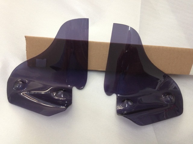

  6. A friend has made an experimental mould to make a softer rubber grommet which I have sent over to John at Eagle screens. The rubber grommet will fit into the fairing recess and present a straight path for the screw. John has also been busy with the WD design and should have some good news very soon.

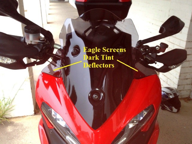

  11. John at Eagle screens has now come up with a set of soft rubber grommets for people who had trouble installing his earlier version of the WD’s and has completed and tested his second take on them (see below).
    Apparently version two has been re-shaped and is now moulded onto the fairing to provide a straight path for the fasteners into the fairing recess, making them a lot easier to install. The fasteners also blend into the cockpit more seamlessly.
    For me this is the end of a project I undertook because my 2010 model was sending me deaf. The WD’s with my short screen, for me, brought back all the enjoyment of riding the bike until Ducati could come up with a new model sufficiently different to entice me once again to purchase.
    Now have a 2013 Pikes Peak model and totally wrapped.
    Would also like to thank John who has put up with me nagging him for what seems like years, and for his efforts, guidance and determination in getting this project to production.
    John has a blurb about his new WD’s on his website www.eaglescreens.com.au

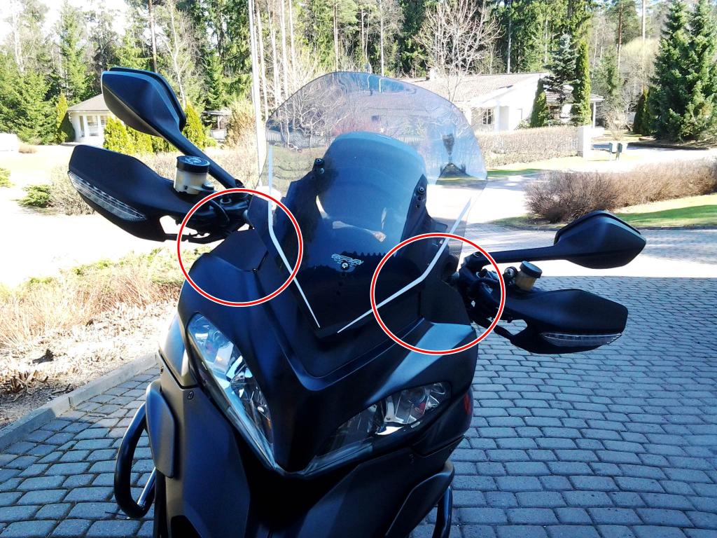

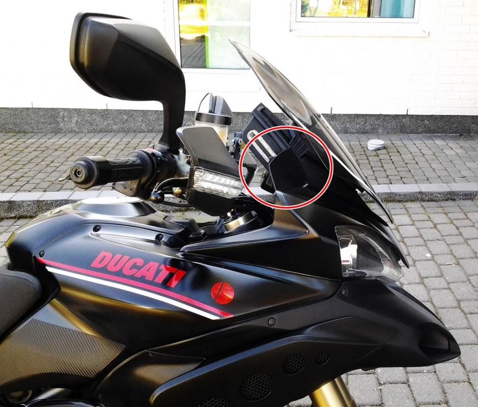

  20. I read this topic sometime during the "loooonnng" winter, and decided to make my own deflectors. Since I am a simple man, I decided to make the deflectors from the 3€ mudflap I bought from the local bike shop.
    Mounting was done by simply opening the 2 fairing bolts on each side and by pushing the rubber mudflap between the fairings. It goes there about 5mm, which is apparently enough to keep them firmly in place once the bolts are tightened. Great mod, which ended up costing 3€ for me and 15min of cutting / assembling time. :upyeah:
    Here are few pictures of the flaps in place. You really can't even see them unless you know what to look. This shape is my first try, and after riding with them, I am happy. Gets the wind of your shoulders pretty nicely!
