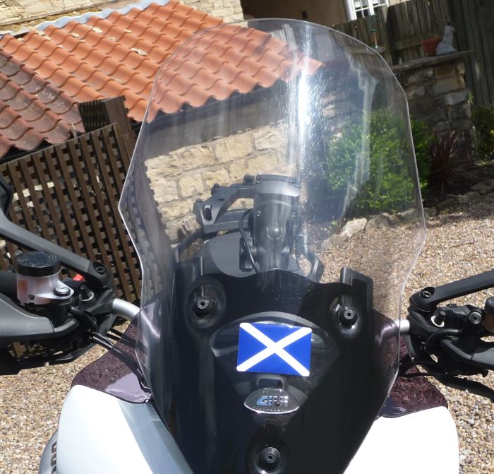

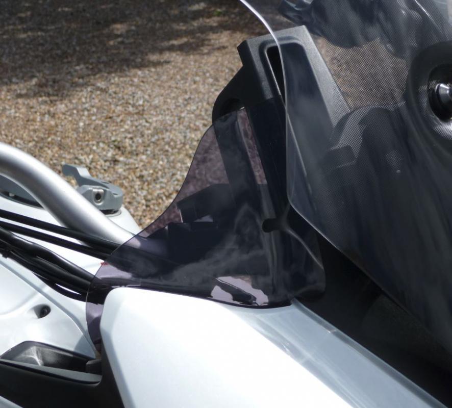

  1. Just fitted the new Mk 2 version of the Eagle Screens Wind Deflectors - took 2 minutes to fit each side and looks really tidy IMO. Now to see if they work!!!

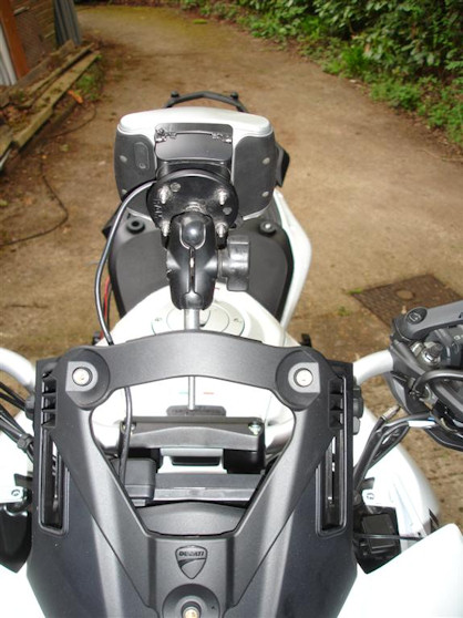

  4. Never mind the wind deflectors, how have you mounted your satnav, I can see it's on a ram ball but how have you fixed the bottom ball to the bike?
  5. Probably by mounting a ball to the handle for the screen.
    There are details on andyw's site somewhere of how I mounted mine like this.
  6. RAM mount bolted through the screen frame top rail. Picked up the idea on AndyW's Motorcycle Info Pages. I reinforced the underside of the rail with a bit of steel plate. Zumo wobbles a bit but nothing serious and I have done a few big tours with no problems.

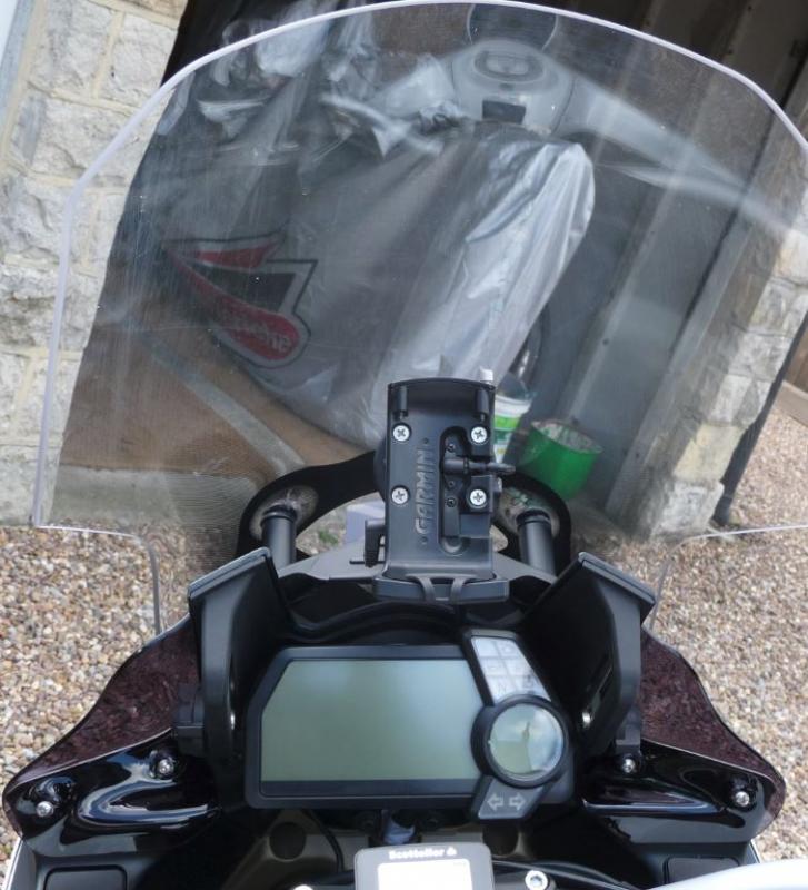

  8. I've mounted mine using a ball off one of the handlebar clamp screws and it blocks part of the dash but if I can't see which gear I'm in it's hardly the end of the World. It doesn't wobble at all but the security screw that locks the clamp on top of the satnav keeps vibrating so it's done up and I've lost the tool for undoing it :rolleyes:
  9. With the 550 mounted as shown it does wobble, but not a great deal. The long thread you can see in the picture has a well-nut on it that touches the flat bit of the handle, so it acts as a damper.
    With the screen all the way down it masks the speedo, but the 550 shows you your true speed anyway, so its not a big deal either :cool:
    foosyerdoos, how much bigger / different are these mk2 deflectors ?
    I've got a set of the originals, wondering if I need to upgrade...:smile:

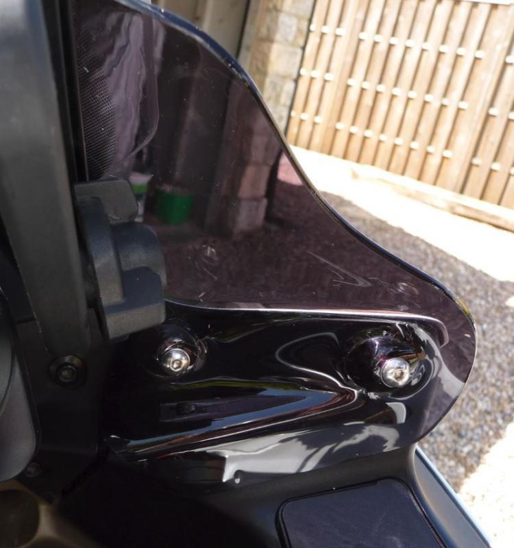

  17. Hi foosyerdoos,
    Looks like you also have Aztec spacers fitted? Does this create a gap between the WD's and the fairing - does it look odd, or is it fine?
    Got mine on order - just waiting the few weeks for them to arrive now. Really looking forward to trying them out.
    Cheers
    Steve
  18. Steve, had my first ride out with the wind deflectors fitted last night. The ride was much more comfortable - still get the wind noise but that uncomfortable buffeting was virtually eliminated. I didn't have time to experiment with screen heights but plenty of time for that in the next 10 days on a trip to Scotland!. My set up is Givi screen, AZTEC spacers and now ESA wind deflectors. The wind deflectors look good as they sit tight to the screen frame and the gap to the screen looks fine.
