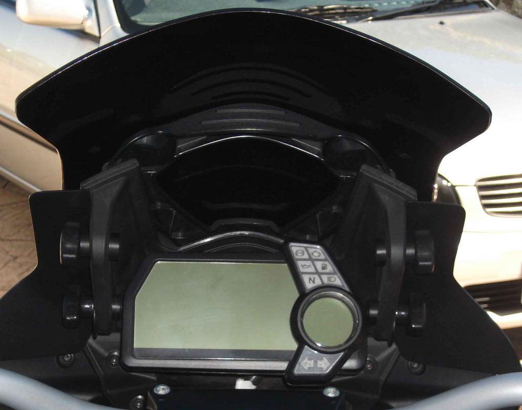

  1. If you meant the existing screen knobs, then no, they don't work.
    The three thumb/finger bits are too long with the addition of the 1.6mm wing on the slider, and I didn't want to file them for clearance.
    I may want to use them in the future and keep them original.

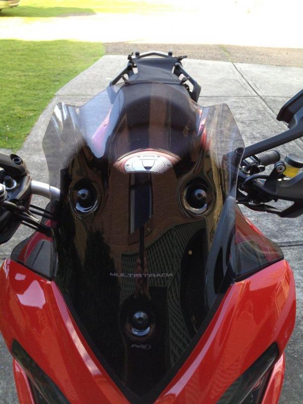

    To be honest I'm disappointed with it. Having said that, it's far better than the standard screen.
    It's a real shame, because I love the bike - just about everything else about it is brilliant.

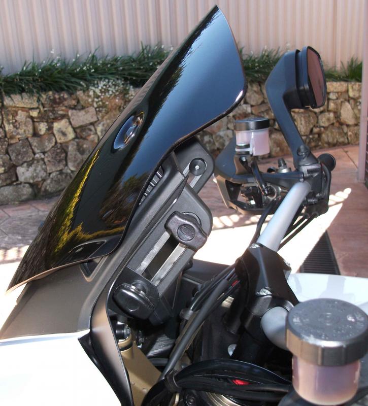

    So just to clarify about these wind deflectors; once fitted, you can't change the height of the screen?
  8. Yes it can be made adjustable by using another set of thumb screws and nuts, as they are smaller and don’t rub the wings when tightening or loosening them.
    The existing knobs are too large and they're not solid where they need to be trimmed off.
    If the wings are fixed at the bottom of the slides not using the slider, the screen will now have movement from about 25% up to full height.
    I’ve set up some pics to illustrate it.
    As for me doing a batch run, it's too much hassle with international shipping, and each wing has to be fine tuned on the bike before painting.
    It was an easy DIY job for others to try as well. :smile: sorry guys.

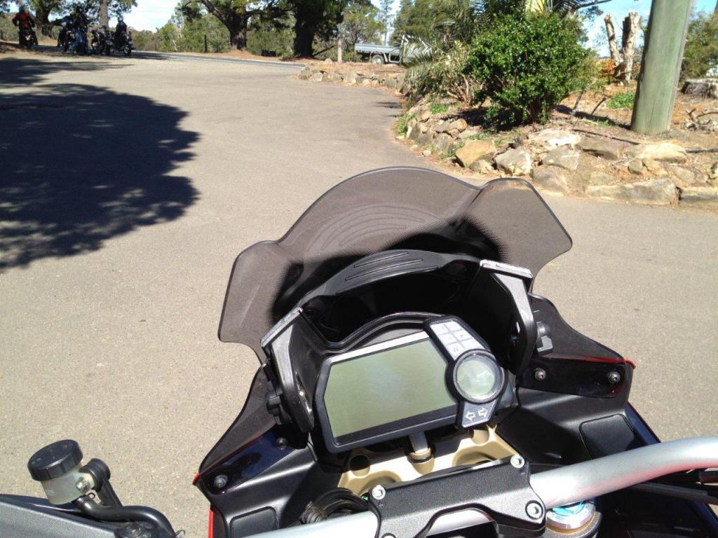

  9. Hi there Chickenman, over the last three months I have undertaken a project to develop a set of wind deflectors for my Multistrada, inspired by the work done by Captain Plummet. The pictures and full story can be viewed on Andy W’s website at www.MTS1200.info
    The end result looks like this.
    The results are absolutely fantastic. The wind deflectors take away all the air pressure from your chest and shoulders and make riding the Multistrada very relaxing at high speed. As a side benefit, they changed the air flow around the handle bar wind protectors giving improved protection to your hands, and in particular your thumbs.
    But, the wind deflectors only solve half the problem. I tested them initially with my PUIG short screen up to 180 km on the freeway, and everything was fine, the chest and arms totally relaxed, your helmet of course is in the normal air flow you would expect with a short screen, but this is still much better than having your head tossed around in the turbulent airflow that comes over the top of the factory screen and it is much quieter.
    I have tested the wind deflectors with the standard screen and this showed what a dog of a screen it is. Whilst the bottom half of the body is perfectly protected with the wind deflectors, the air flow over the factory screen hits you straight in the helmet. Everyone would know how this affects both the noise levels inside, and the stability of the helmet. As yet, I have not had time to test the wind deflectors with the Aztec Spaces behind the factory screen but I would imagine the best solution would be to use the wind deflectors with a touring screen for a long trip and with a shorty screen any other time.
    Have built many more examples, based on a slight variation of the last pattern, using Lexan and Perspex, trying for a perfect fit so I can send examples to Eagle screens in Western Australia to encourage them to make the moulds, advise on the best fittings, and produce a batch of wind deflectors based on forum member interest. Have also sent an example of the earlier design to Andy W for testing.
    Finally, have now made some 2mm Perspex examples and sent them to Eagle Screens for evaluation. Fingers crossed

  12. What polish are you using? That Puig shot looks like Photoshop Extra Gleam:) Where does one get that?
  13. I have the Aztec Spacers also :) there great
