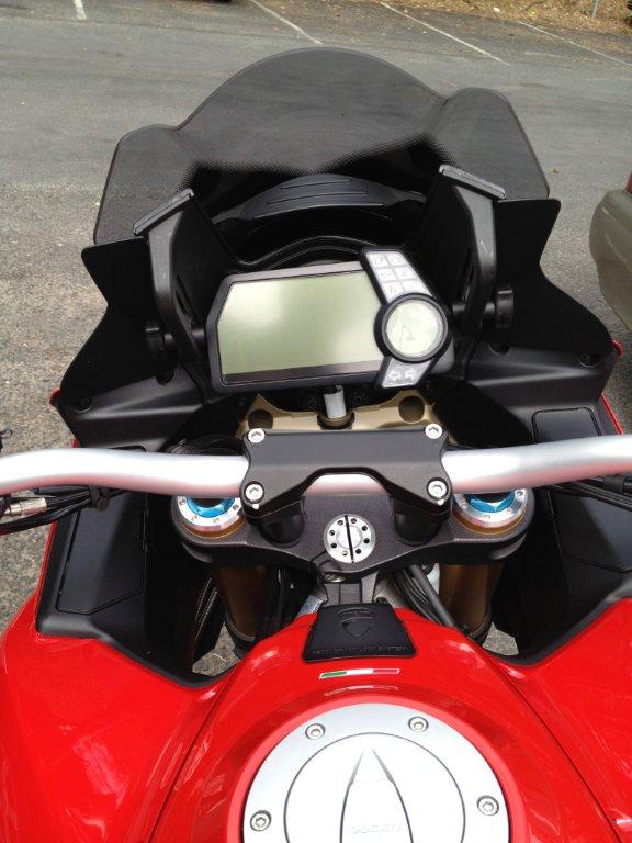

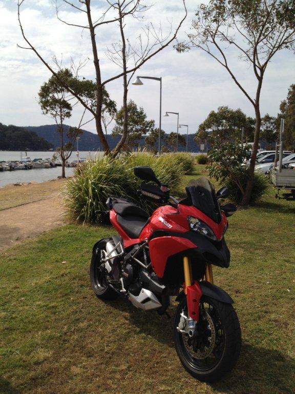

  14. Hi Andy, an update for you. Met with Don aka Chickenman, a great guy and full of idea's. He lent me a set of his wind deflectors which I found to produce similar benefits to the set I have made. Again I couldn't imagine riding my bike now without a set installed. Sent you a draft of a "DIY manual" for you to critique and have nine sets of blanks to bend and fit over the weekend. One set to Don and two sets to Eagle screens. Still no word from a Perth Multi owner, but fingers crossed.
  15. Hi Andy, Chickenman's wings on a Red Multi with a Puig short screen.

  16. Stop teasing, and get whittling - I NEED a set!
