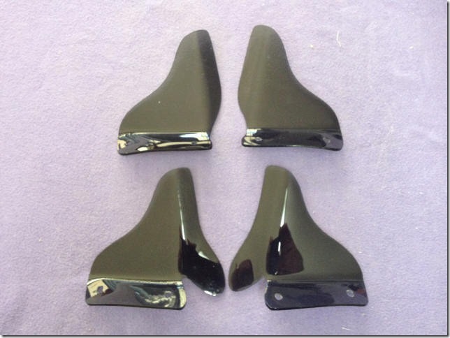

    PUIG Touring Screen (shortened 2")

  13. Eagle Screens have made the moulds and produced the prototypes in the picture below. You can see they have made two different versions which will be fitted to a local guys multi for testing and final fitment. I have also asked John whether it would be possible at this point to make the WDs a little taller (to the top of the screen mount) and little wider.
  14. I'll write up and send you my feedback on the later versions... Slightly wider and taller at the top will almost certainly help, although you would have to watch for stress on the fixing points. That's where the "lower" (second set shown above) design may be better, as it gives more support to the whole flap (even though it only fixes low down).

    The selling should begin soon.......had a message from Robin (RBlacky;-) earlier today - Eagle Screens will have the test MTS1200 back with them next week for fitment and design finalisation :)
