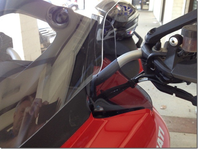

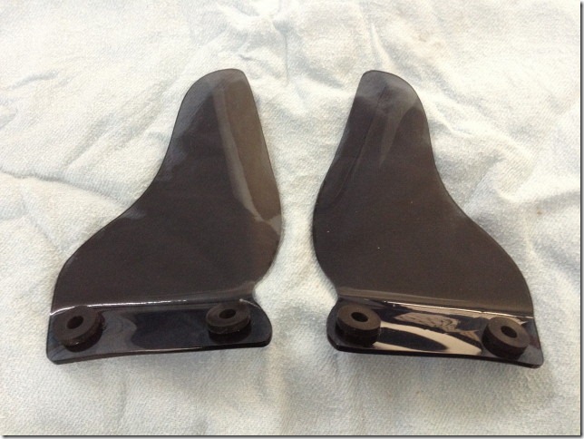

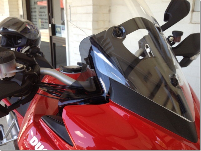

  5. Here are the latest pictures of the almost finished product. John refers to them as the "LongJohns" and only has a little tweaking to do in terms of shape and gaps.
    They are fitted to Jeremy's bike.
  6. nice! That looks just the ticket Robin! Well done.... :)
  7. Just for clarification, the grommet fits into the hole in the wind deflector. The 12mm underside part of the grommet fits into the fairing recess and the 10mm topside part of the grommet fits under a stainless steel washer. A stainless steel screw is then passed through the washer and grommet and screwed into the original fairing fastener. Probably take five minutes to fit both wind deflectors.

  14. It should do....the flaps work best with a "shorty" screen, as for many a shorty screen works best. The stock screen is awful. I have an MRA X-Creen double, and that works well.
    It's a combination of screen width, screen height, flaps, and you! The trick is to either be "in" the airflow (like on a sports bike) or to deflect it round you.
    The flaps won't fix your screen, so a crap screen will still be a crap screen (e.g. The stock screen), but it will improve the airflow around the BOTTOM of the screen. This is where a lot of the noise/turbulence comes from.
    Hope that helps.
