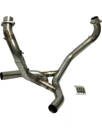

  5. Spike is that with end cans or is it just the header section? They have recently produce (Past 5-6years) headers which fit most high level cans. You can also get the Silmoto end cans, but I believe this is slightly different to the original 45mm full systems they used to produce.

  9. Yes, thats the headers i got from nog.

    So you bought the pipes from Nog Spike? I thought about it, but couldn't really justify the outlay at the moment... Still on my nice things to have list though!
