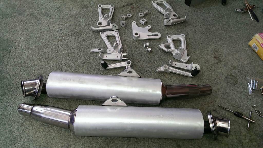

  2. Just got everything back from the anodisers. Wow is what I reckon.
    Cans are mot fully back together yet as I need to get a bit more of the original tube taken off the inside of the end cap for a good fit, but here's what the ally sleeves look like along with a few other bits that were done too.
  3. Looks nice :upyeah:

  6. I drilled the rivets out of them, tapped end pipe off with soft hammer and cold chisel, undid the hanging bracket, and took the sleeve off. It took no more than 10 minutes per can. The anodisers asked me to degrease them so I just gave them a good scrub inside and out with brake and clutch cleaner and a scotchbrite cloth. I also cleaned up the outside with a scotchbrite wheel on a bench polisher. In hindsight if I were to do it again I would scrub/polish them differently. I used a medium scotchbrite wheel initially, then a fine one. I couldn't get an even finish with the fine so went back to the medium which looked better but still wasn't perfect. I did manage to get all the scratches out. Also they looked too shiny, hence the anodising. Next time I would try using a polishing wheel and compound for a more even finish then anodise them.
    While you've got the sleeves off, take the opportunity to polish up the stainless ends and link pipes as it's easier without having to worry about the ali sleeves.
    The ends need to be riveted back on again with stainless rivets, but the guys who modified the baffles have done that for me.
    It's actually real easy to do. It sounds like you are close by so if you fancy giving it a go and want a hand let me know. If you weren't modifying the baffles then there's probably no more than 2 hours work there tops.

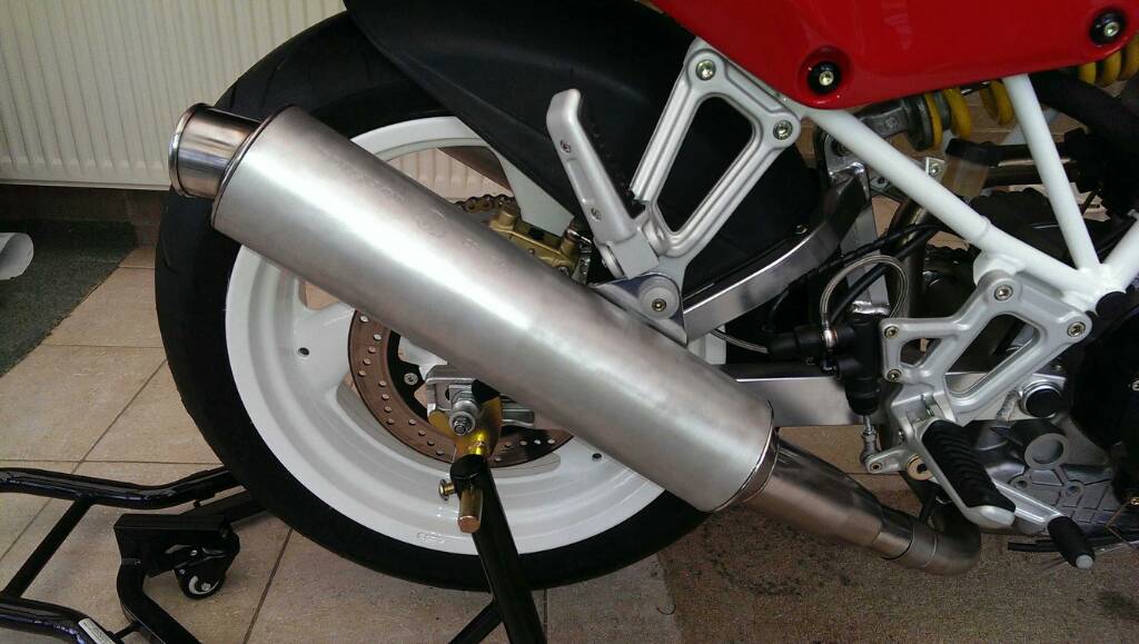

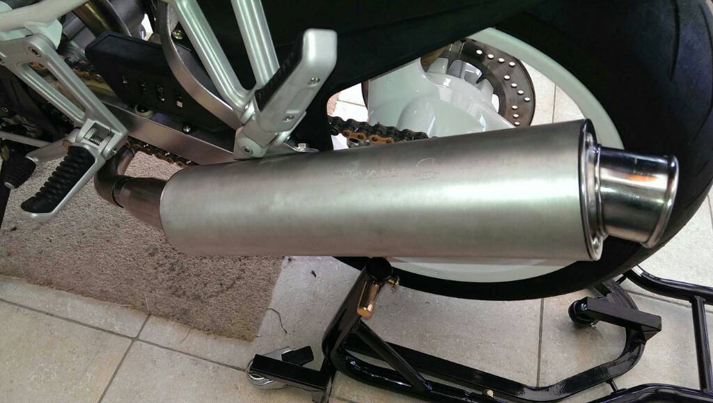

  11. Finally, got cans finished and back on the bike. I'll fire it up later and see if I can get a video with sound linked up somehow. Anyhow, here's how they look
  12. Managed to take a video and upload it to YouTube. It's not very good though and it doesn't really capture the sound fully, but here it is
    They are certainly louder than standard but quieter than the open race cans that were fitted previously, but overall I'm pleased . It's running a bit rich now so needs tweaking, and I think I'll need a bit of sealant at the joints.
