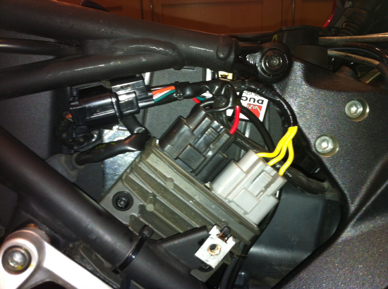

  4. I bought one and fitted it two years ago. Bought a Mivv decat when Leo Vince was down so needed this to override the electronics. Never had a problem with it. Here's a photo of it behind the regulator/rectifier behind the RH side panel. image.jpg

    The eliminator device sits nicely in a little pocket behind the regulator:
    Then with the reg re-installed:
