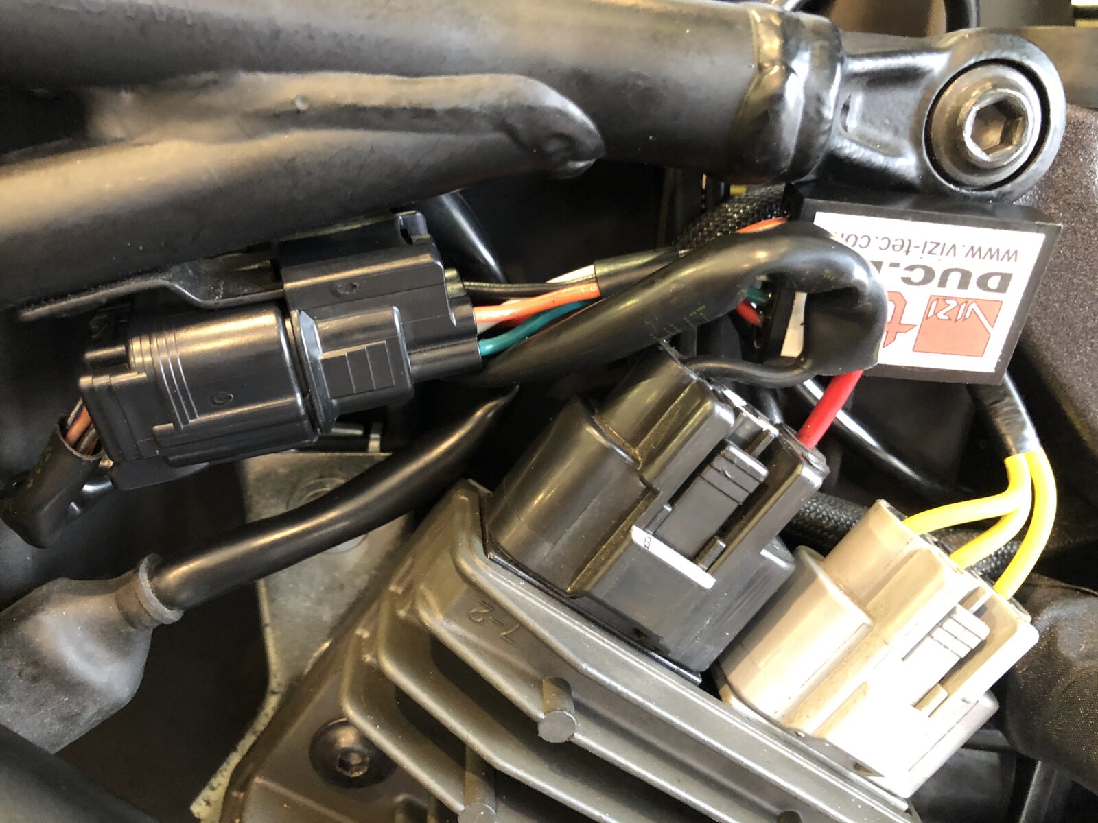

  10. I Plugged a Duc Ee in here - (removed the cat and cat buterfly valve cable - as used Leo vince decat pipe) ... but when I turned bike ignition on I got error on dash.
    Does that mean the duc ee units not good?
    I’ve just left the stock servo and cables in situ so can return back to stock should I choose.
    Is plug in right place any anything else to do, or is Duc ee not working as it should?
