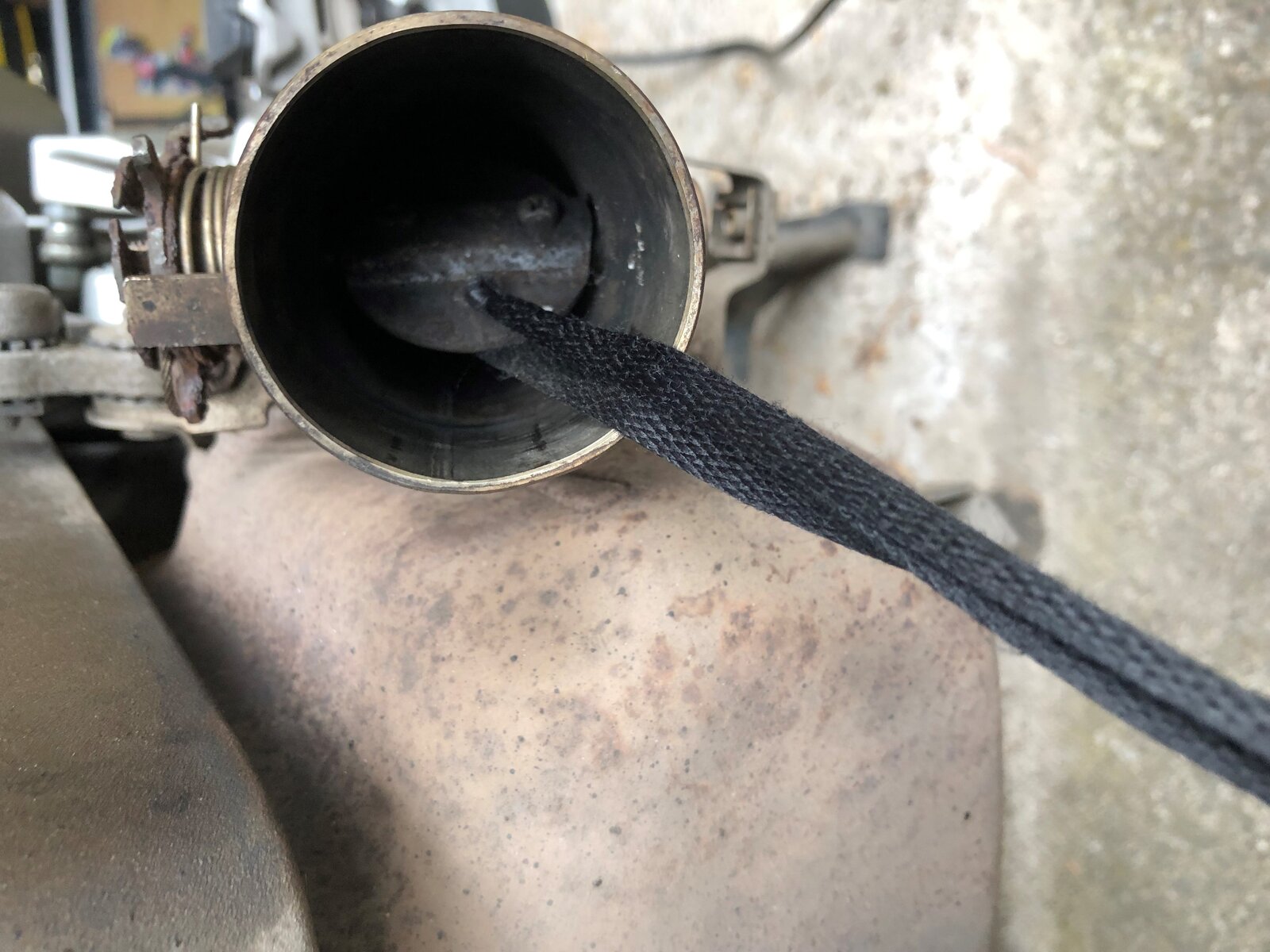

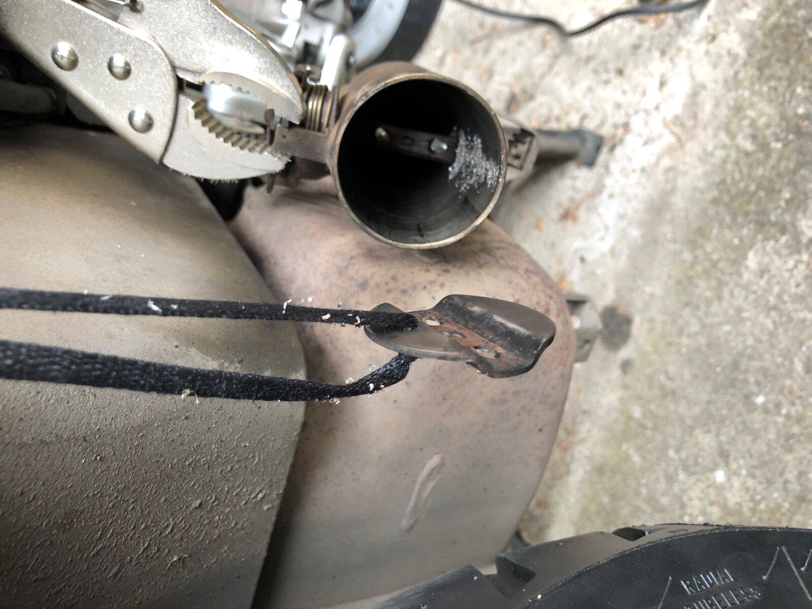

    I just drilled the valve out. For those worrying about losing it in the cat - I have a solution. Drill a hole through the valve whilst it's still attached and pass some string/shoelace through it. Worked a treat for me.
