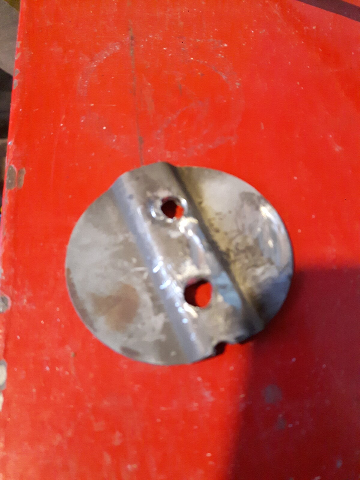

  1. So I am curious DarR, could you provide some details as to how you physically removed the valve flap in the exhaust? :)
  2. Sure.
    Once you remove the silencer, the flap is readily accessible.
    There's two screws holding the flap fastened to the valve axle.
    All I did was use a Dremel Tool with a round blade to cut-off the screw heads. Only the axle remains.
    The whole process took me about 30 minutes and that includes removing and reinstalling the silencer.

  3. I did the same.
