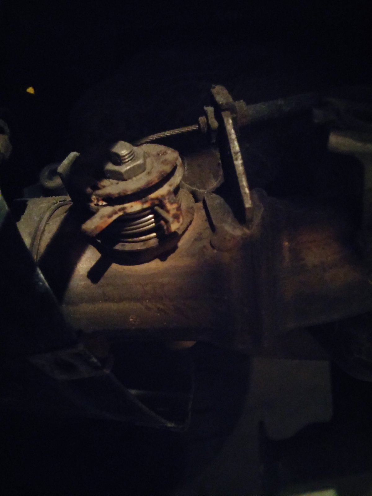

  1. Nightmare. Can't say I've been impressed with some of build quality and had to buy a new battery as original one failed.
    Looking at pic of mine do you think it's worth trying to get it replaced under warranty or isn't it that bad compared to yours?

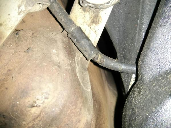

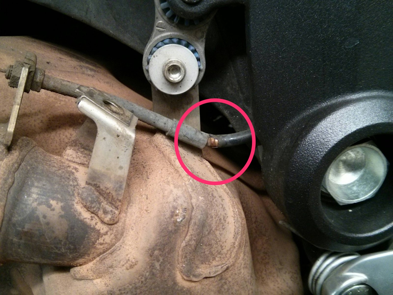

    This was my cable in August:
    ... and this was the cable in November:
  3. Getting really annoyed with mine now. It's just not holding up to the winter weather.
    Got the EXVL error message the other day, literally 24 hours after I had JUST given the bike a damn good clean and ACF50'd the entire thing, including the valve.
    Rusted stuck - not in any meaningful way - its just the two contact points, came free by pushing it with my finger.
    Been fine for a week or two and not seen the error since, but its obviously stuck closed again as the bike is running like a bag of spanners - won't rev, no urgency same as it was when the error came up.

  4. They will (should!.....LOTS have been) replace the valve under warranty. Unless there's been a change with the very latest Multi's the valve will be exactly the same! Decat kit is the answer.......with other benefits :D
  5. Yes, they just 'fool' the ECU as if the exhaust valve is still present and working...........if you come over this way at all Chris at CJS can switch off the exhaust valve in the ECU ;-)

  7. AFAIK, you can't replace the exhaust valve by itself, you'd need the whole exhaust 'union', part number 57313482A. I can't find a UK price, but I seem to remember it being several hundred pounds, at least.
    If it's stuck open (or you can force it open), you might be able to get away with cutting or disconnecting the cable. I did that on mine temporarily (when the second one failed), and it didn't give an EXVL error on the dash.
