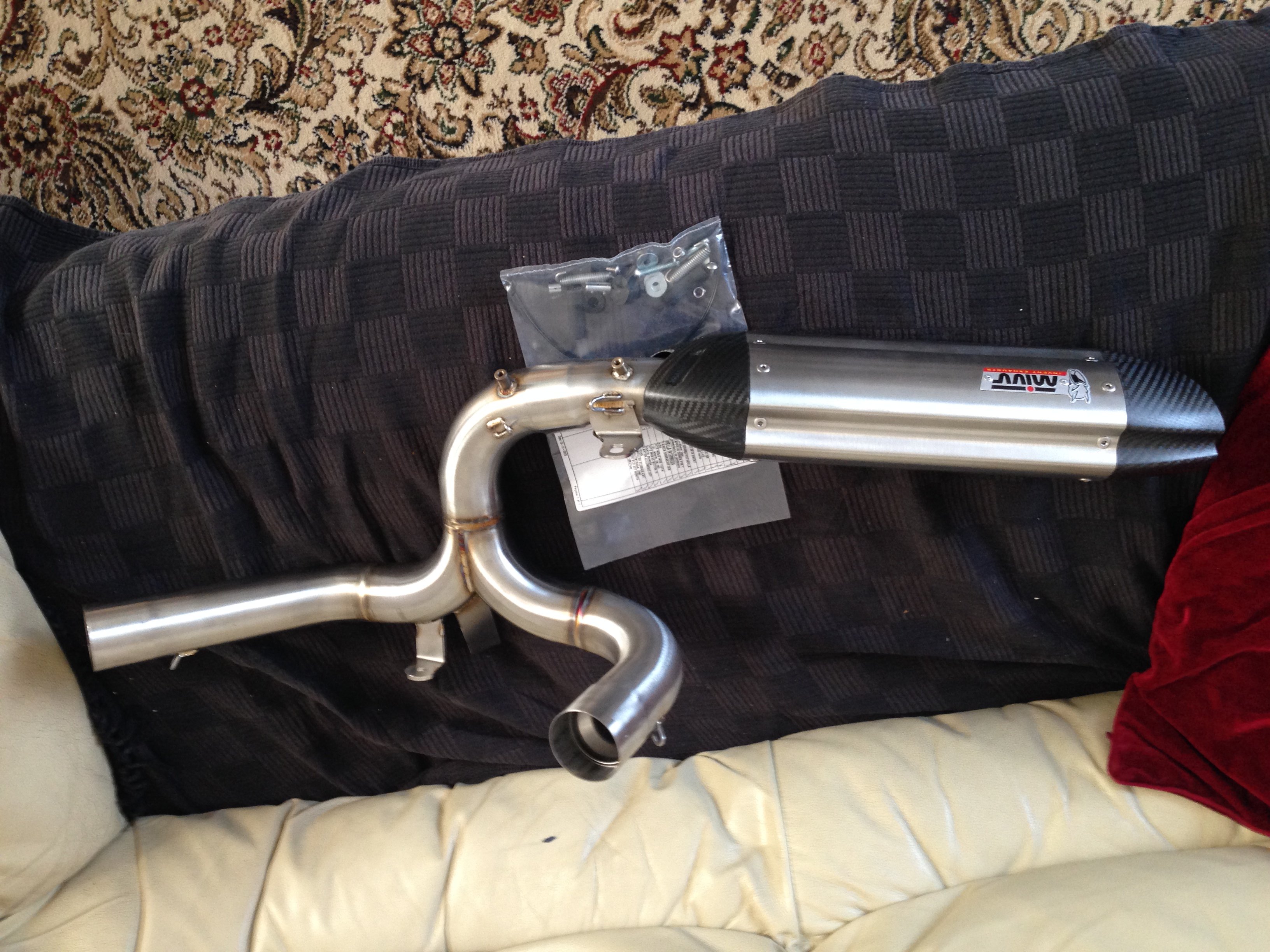

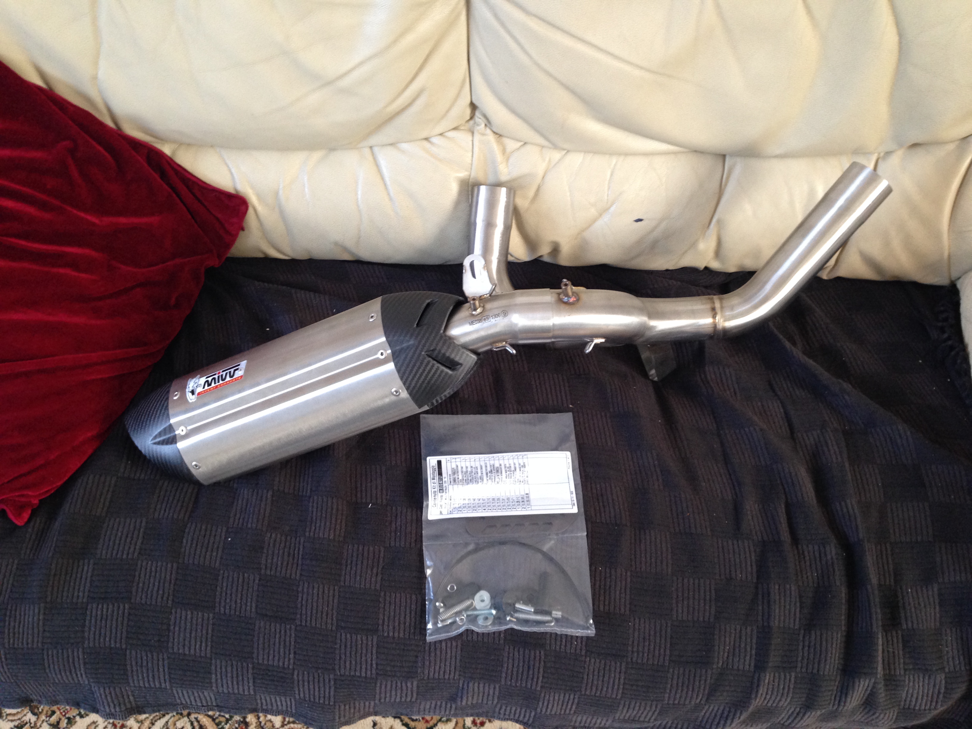

  12. IMG_0141.JPG IMG_0142.JPG Well I got an unexpected knock on the door this morning.
    It looks very good quality and with full instructions it even gives you a kit to fool the exhaust valve sensor it to thinking the valve is still there. IMG_0141.JPG

  13. Nice looking piece of kit jcmental - health to use mate. Is there a centre stand stop welded on? I can't really make out in the pictures if there is or not?

  15. Yep it cam with some BD Killers 3 in fact I left the one in the baffle but took the ones out of the down pipes to try it and they didn't sound any different.
    And yes theres a centre stand stop, they even put in a grommet with Mivv on it to put inplace of the old stand rubber sstop.

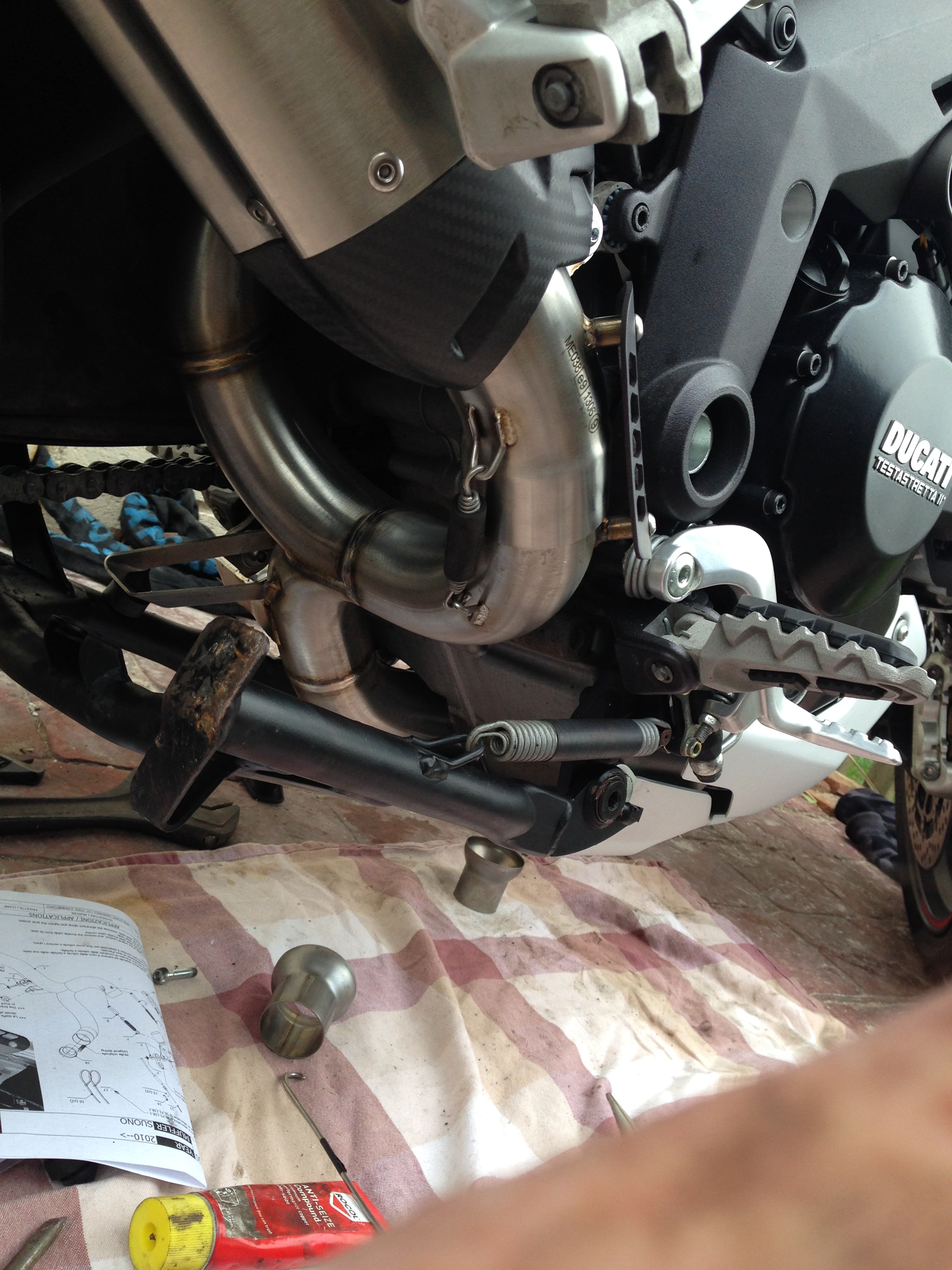

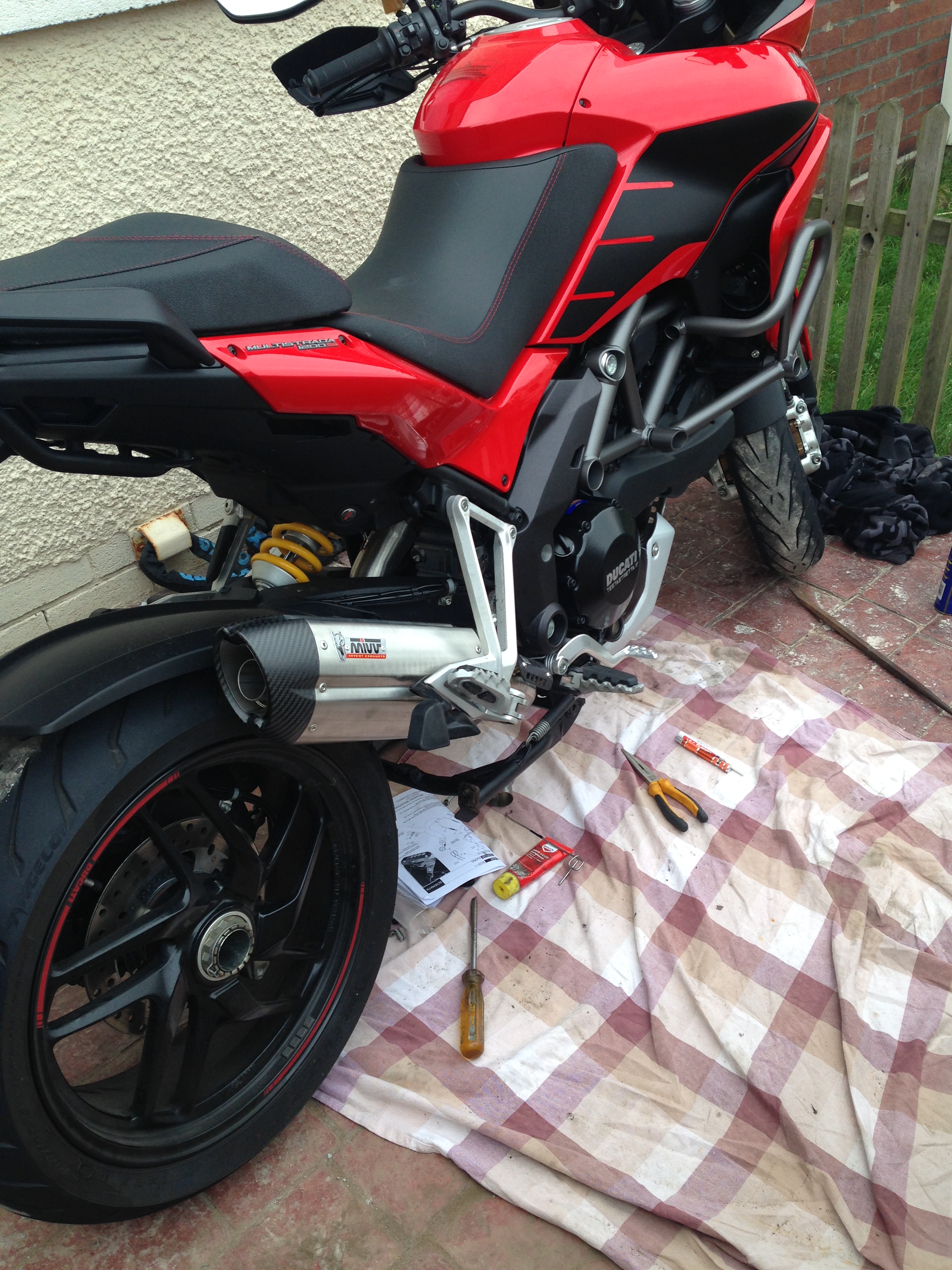

    Not being one to Feck about, I fitted it this afternoon, I had a bit of trouble with alignment so had to put it on and off a few times to adjust one of the branch lengths, but here's the finished article 2 hours later. Tell you what it's very loud and deep, the wife walked past the back of it when I was starting it and her hair blew all over like she was in a gail.
    A few pics (I hope, cant get used to the image up loader)
    You can see the DB killers under the bike in the last pic to.
  16. Looks the dogs danglies and thanks for the info regarding the centre stand as well. Health to use.

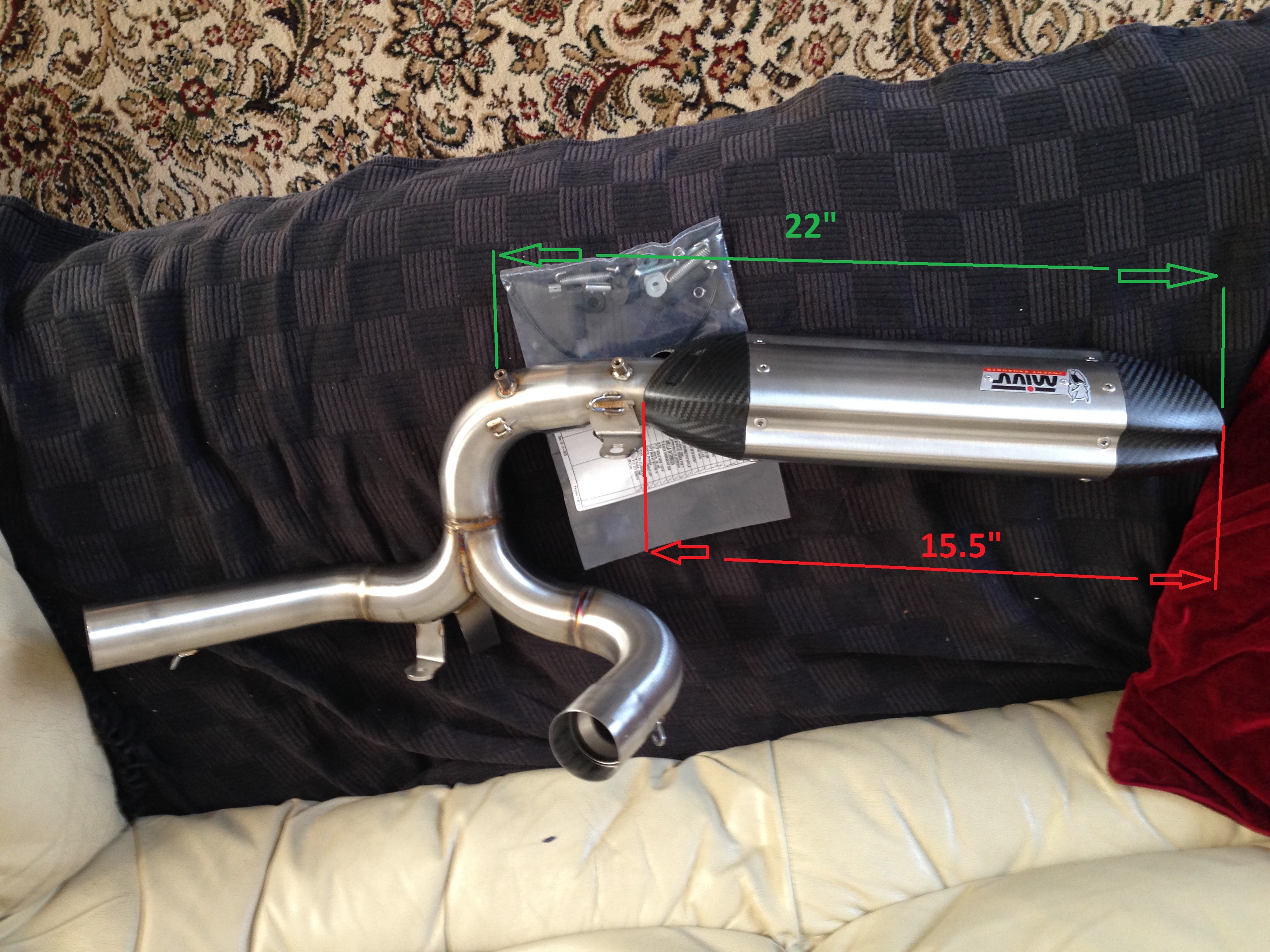

  17. Could you do me a favour when you get a minute and measure the length of the can? ive looked everywhere but its really hard to tell how long they are, im thinking 400mm ish?
  18. I've measured it, the can from the tip of the outlet end to the carbon fibre heat shield on the inlet is 15.5 inch
    and the total measurement of the whole can is 22 inch
  19. Cheers mate, appreciate that.
    Do you mean this?
  20. Yes, its a bit deceiving though because in reality the exhaust is at a shaper angel than the picture looks
