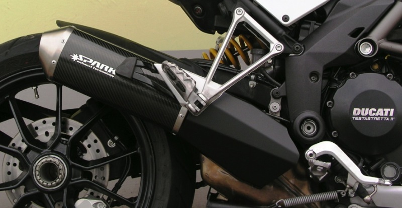

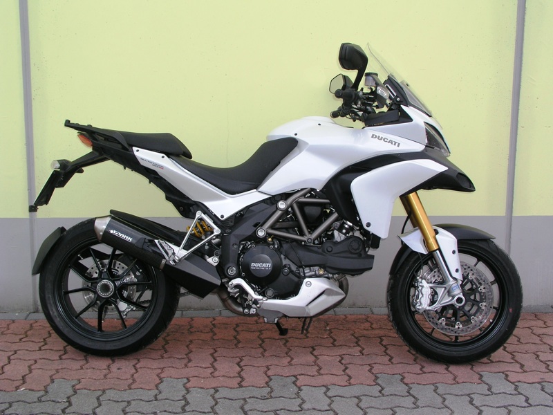

  16. Here are some pix of the Spark.....I import them through my little enterprise...Solo Corse Racing....
