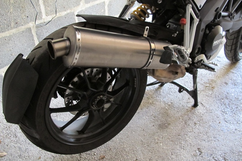

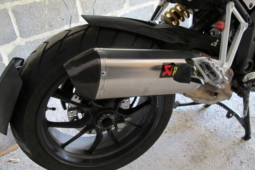

  3. Purely out of curiosity, I took my standard silencer off, and stuck on a few bits of pipe I had kicking around the garage. First an Akra pipe which was off my KTM superduke R - this was a couple of millimetres too big so it's drooping in the pics, and too wide so it would foul the tyre.
    Then an old Titanium pipe from a T595 Triumph, which I reckon looks ok if a little long.

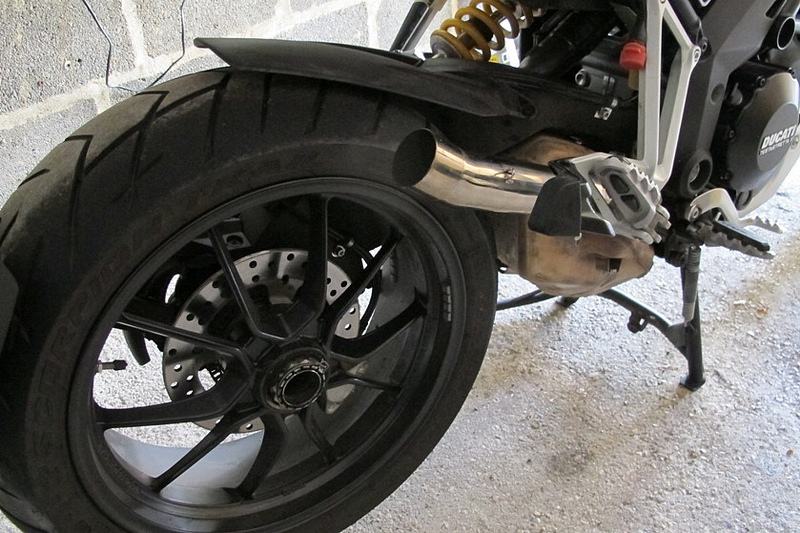

    The link pipe from the Triumph job also fitted, and by itself looks a touch like a MotoGP end pipe. It also gave me a chance to ride the bike in that configuration, which just sounded just a tiny bit louder (as you'd expect with the cat still in place).
    Back home I dug out my Radio shack decibel meter and did a quick ACU style measurement (at 0.5 mtr at a 45 degree angle but at tickover rather than at whatever the mean piston speed spec they use) - surprisingly the standard end pipe was the loudest 103 db. This rose to 107 db at 3000 rpm. The unsilenced stubby came in at 101 db and 104 db. They probably would have been quieter out in the open rather than in my garage.
    Personally I'm drawn to the Leo Vinci pipe and decat, but might just try that old Titanium pipe on it...
