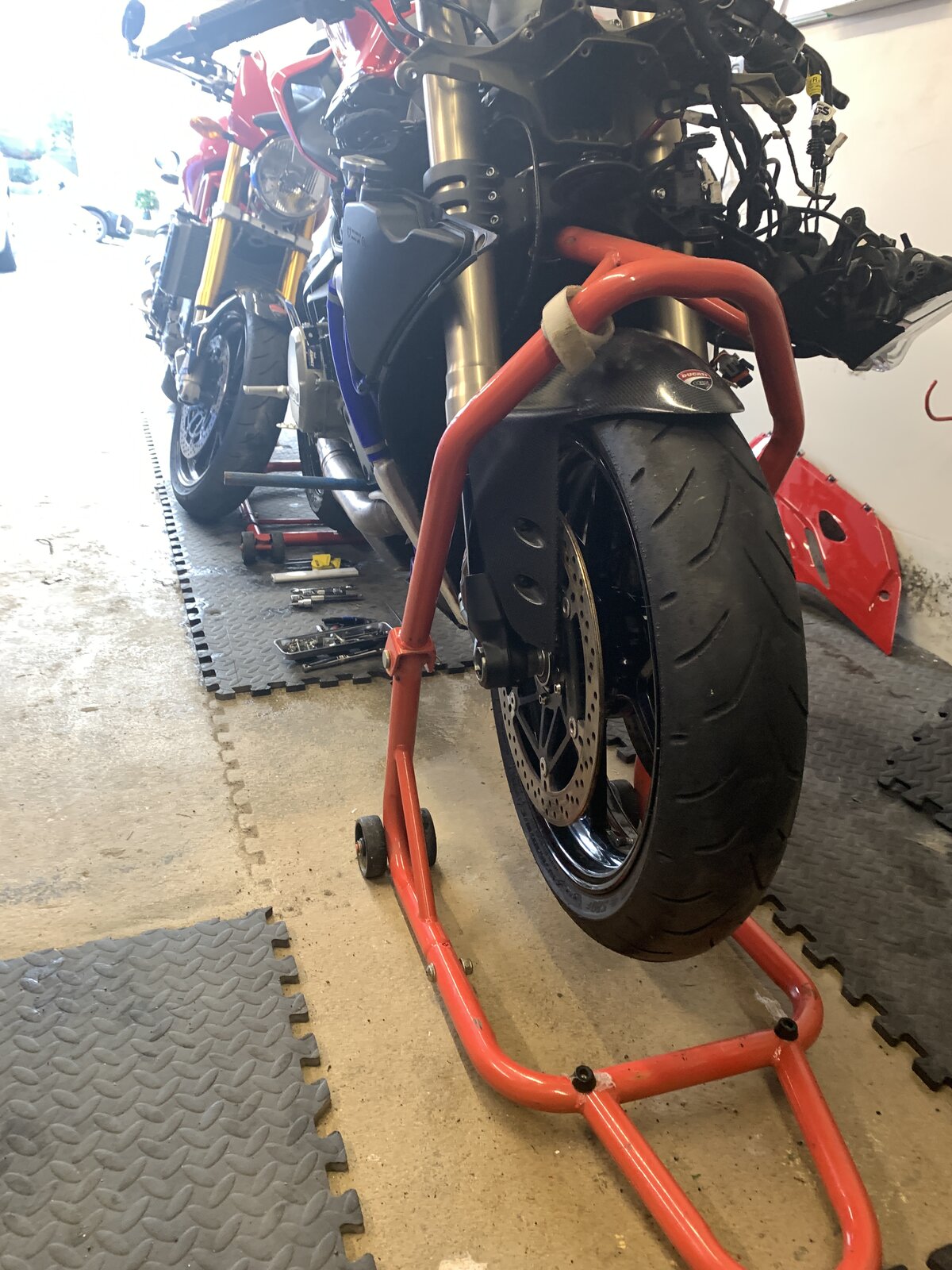

  7. Success. Silly little local issue prevented stand working properly. Picture has a clue as to what I needed to do to resolve….fresh eyes today helped

  8. i see you supplement it with a bit of Abbas stand. Nice touch
    If you could post a link as to where you bought it or the make and model that would be much appreciated.
    Cheers
  9. I bought the stand 6 years ago. Sorry don't have a link for it.

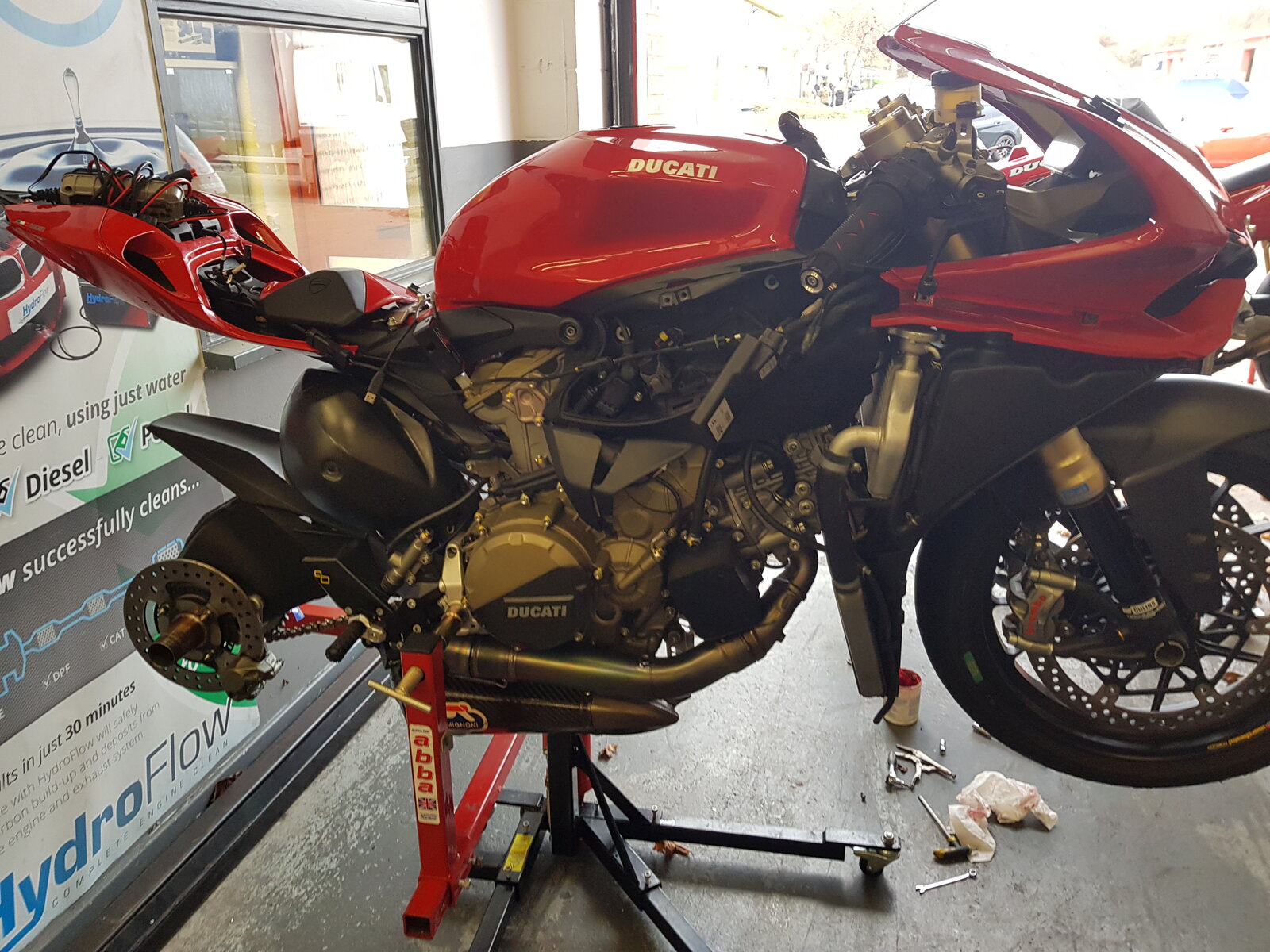

  10. I have the Abba stand inc. front end lift in addition to front and rear paddock stands (under fork and headstock types).
    The Abba stand is my go to for any serious work. I’ve had both front and rear ends off all my bikes (Pani 959/1299, 748, 996 Truimph 675, 765, Kawasaki z900 etc) simultaneously on it with never so much as a doubt. You do need to ensure it is correctly located before lifting but then super stable.
    Edit. I guess the clue is in the name for one of the types. Paddock stands in the paddock. Abba stand in the workshop.

  11. Ah, yes I have just noticed mine is a 1199 and yours a 1299. That might make the difference.
