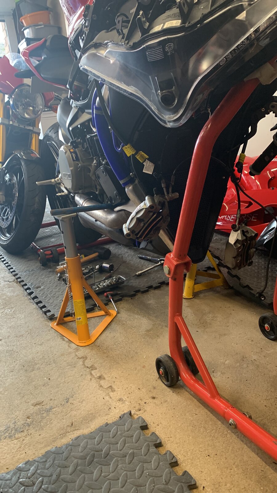

  2. What I do now is jack it up and put stands under the pegs with weight on the rear, if you are going to do this a lot get a scissor stand with the built in wheel clamps.
    I have a bottle Jack that I have used in the past. But I prefer a rod thru between pipes and casings normally find a spot and then axle stands to take the weight of it should get knocked. Like this, in case the stand fails.
