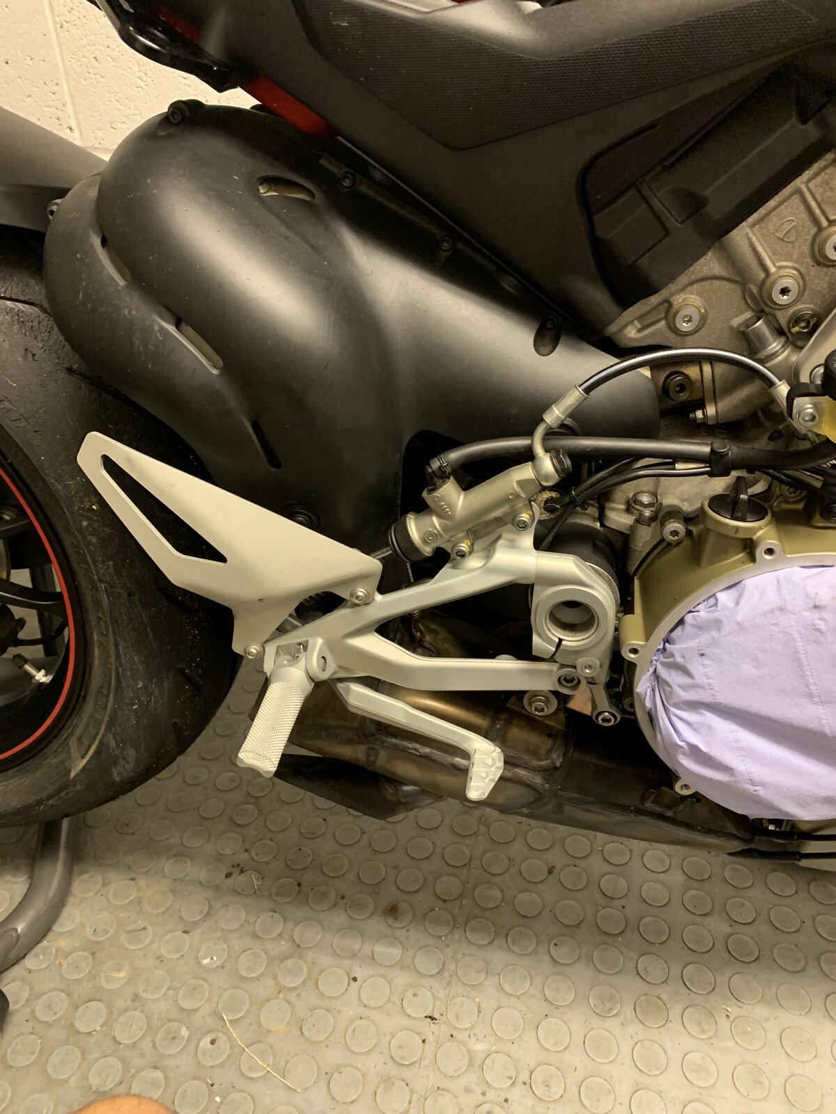

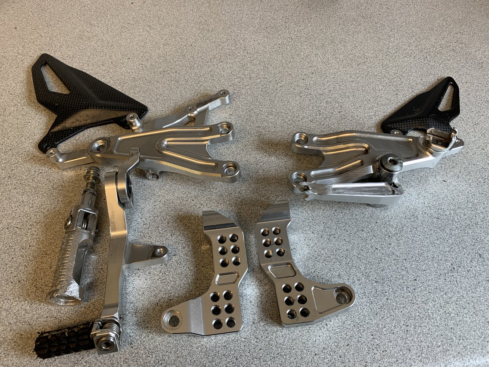

    I’ve started down the restoration road. First of all I need to see if the engine is ok, so that means making it oil-tight again and fixing the controls so that I can try starting it. I have cleaned nearly all of the oil from it (the stuff gets everywhere). Remains of clutch cover removed. No sign of any dirt ingress, so that’s good. Broken rearsets are off and the OEM rearsets back on. I never really did like the Ducati-by-Rizoma units and the remains are scrap now. The gearbox feels ok when tested statically.

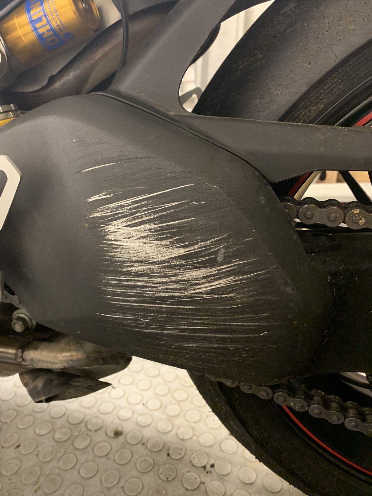

  13. You should get a few quid for the rearsets sold as spares. Carbon cover for swingarm?
  14. Surely it’s good to leave a few battle scars?
  15. It’s a veritable tour of the outer reaches of the track!
  16. It does add a certain je ne sais quoi
