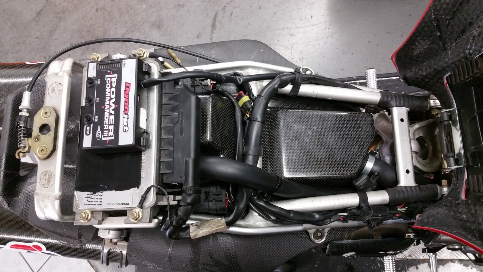

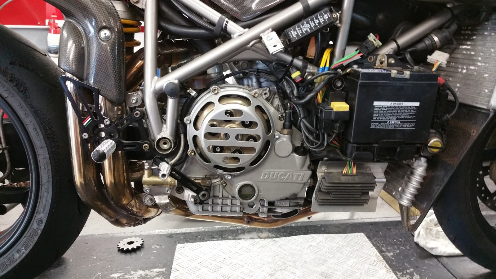

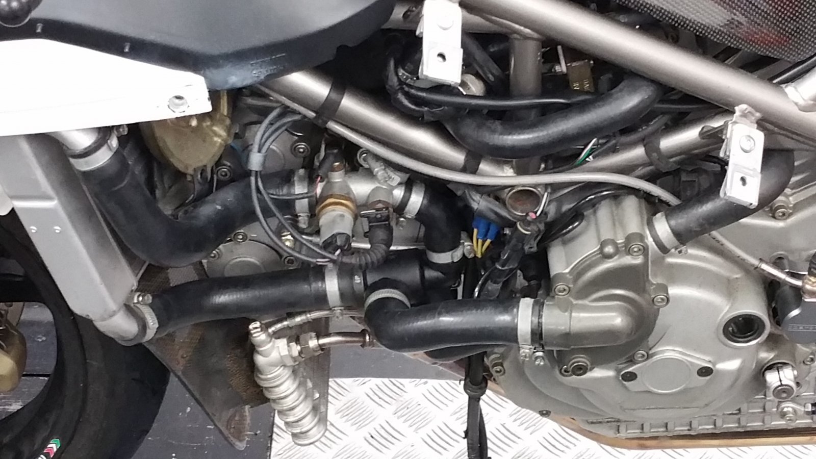

  8. So, having a great year so far and the bike has been faultless which is more than can be said for my riding. Been playing with getting an engine to play with and use instead of the original which I would prefer not to wreck if I ever need to return the bike to standard. Anyway after looking at a number of options I bought a 2000YM 748RS engine that has been refreshed and is ready to go. Stll hoping for another trip to Spain before the year end so something for January. No plans to go mental just a few tweaks here and there. I'll post pictures after I pick the engine up at the weekend and of course record the build nect year. Andy
  9. Bike booked in for engine transplant last week in November and I've been collecting one or two bits. A carbon under seat crankcase breather box was a good find as were the de restricted 54mm throttle bodies. Going to be a bit of a hybrid with OE 748R radiator and coolant pipework which makes it easier with the stock wiring loom. Workshop reckon about 10 hours to get it ready for the dyno and hopefully Christmas will come early. I have asked Santa for 125 rwhp and 80 lbs ft torque. Andy
  10. Engine fitted and running sweetly although yet to go on the dyno. Will post a couple of pictures I took with the phone but the transplant has been done very neatly. Tarty red Samco hoses didn't arrive in time but I can do that any time. Still hoping to acquire a 54mm system which I have located but the de restricted throttle bodies and 848 injectors seem to work really well together although only time will tell what the torque and power delivery is like. Have to say after being allowed to fire the engine up in the workshop I cannot get rid of this huge grin :). Andy

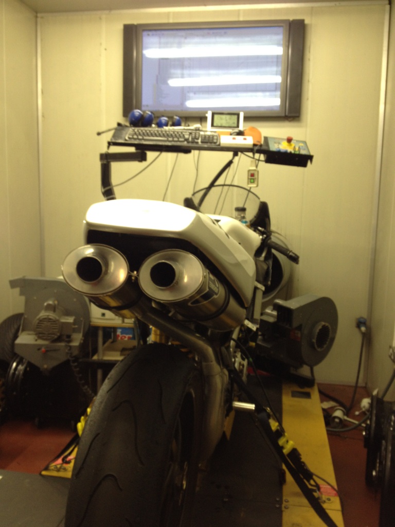

  14. So a last minute change after the bike was loaded into the van on Thursday to be taken down to the dyno. It now has a full titanium Termignoni 54mm race system that was offered and I couldn't resist. Had a long chat about what I was looking for, compromising all out performance with an 11,000 rev limit, reliability and longevity. A refresh every 6 to 700 kilometres would just take funds and time away from being on track. Just had a text and the bike is making a smidge over 120hp and just under 60lbs ft torque which is about 7 or 8% up on the 748R on the same dyno. Not worked out how to download the chart from an mms message so will post a copy and some pictures when the bike comes home. Proof of the pudding is in the eating, so I need to arrange a track day somewhere in Spain probably in February. I hope my project has entertained, the sad anorak in me has loved the minutiae and challenge. I had a very enjoyable season with the R and I look forward to the same pleasure from the RS and hopefully will see a few of you out on track. Andy

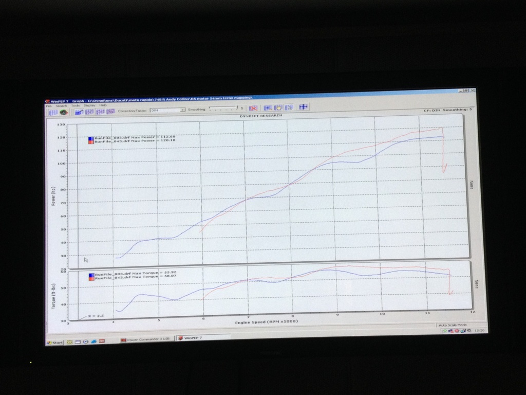

  17. I'm not sure that this will show much detail but I think that the "before" is a comparison with my 748R fitted with a 50mm full system and a JHP half system eprom.
    Looks like I'm going to be using the 9000 to 11000 rev band quite a lot :). Andy
  18. That's a lovely smooth curve!
  19. It represents a full throttle run with the revs being taken from the coil. Unfortunately with a PC3 USB you cannot tune individual cylinders so the vertical cylinder is a little rich mid range. The AFR is very good but I didn't have a copy of that. Running 848/1098 injectors was a bit of a punt but it really worked really well. Andy
    Oh yes I almost forgot, dyno work courtesy of Wilf at Moto Rapido.

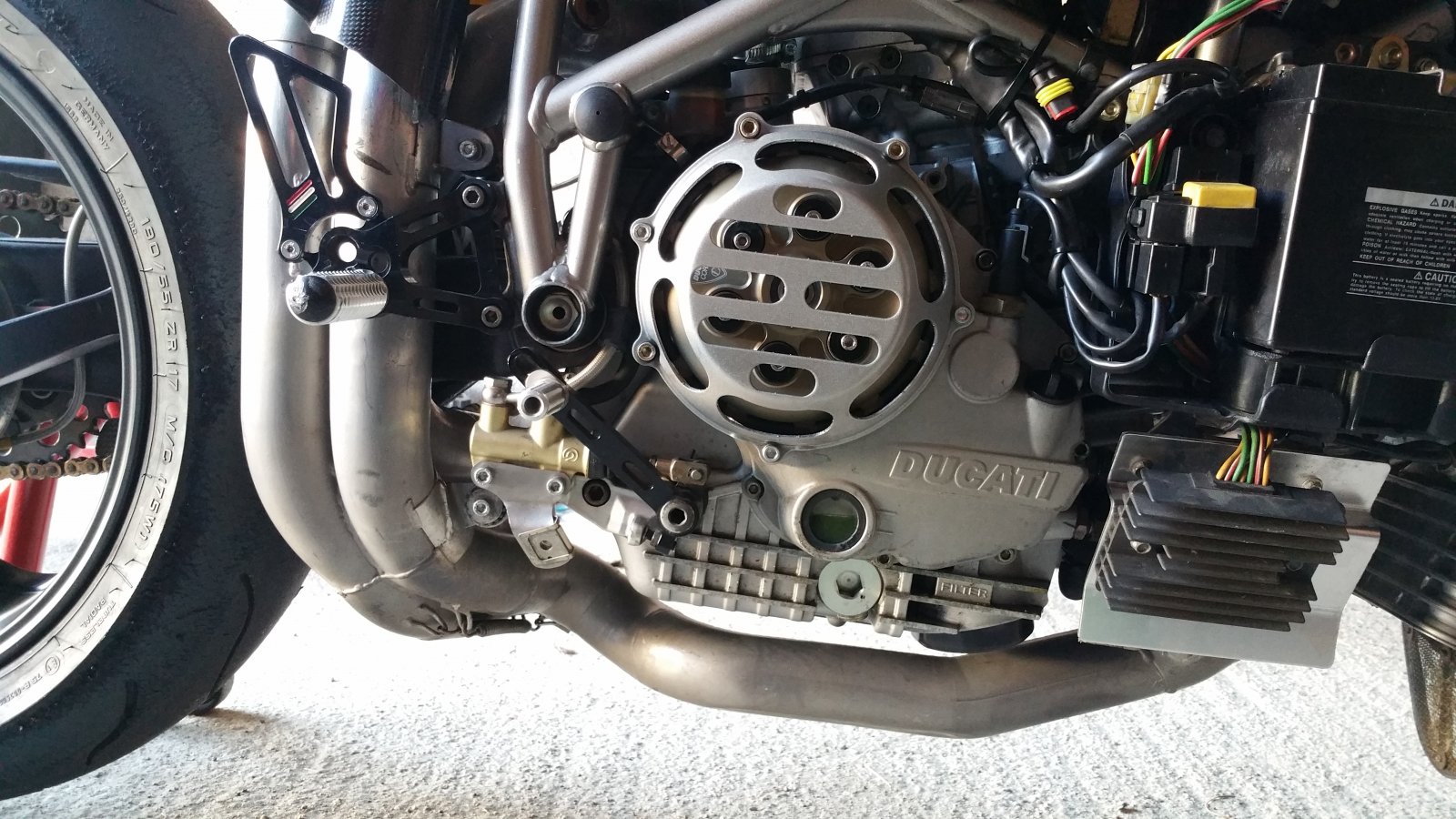

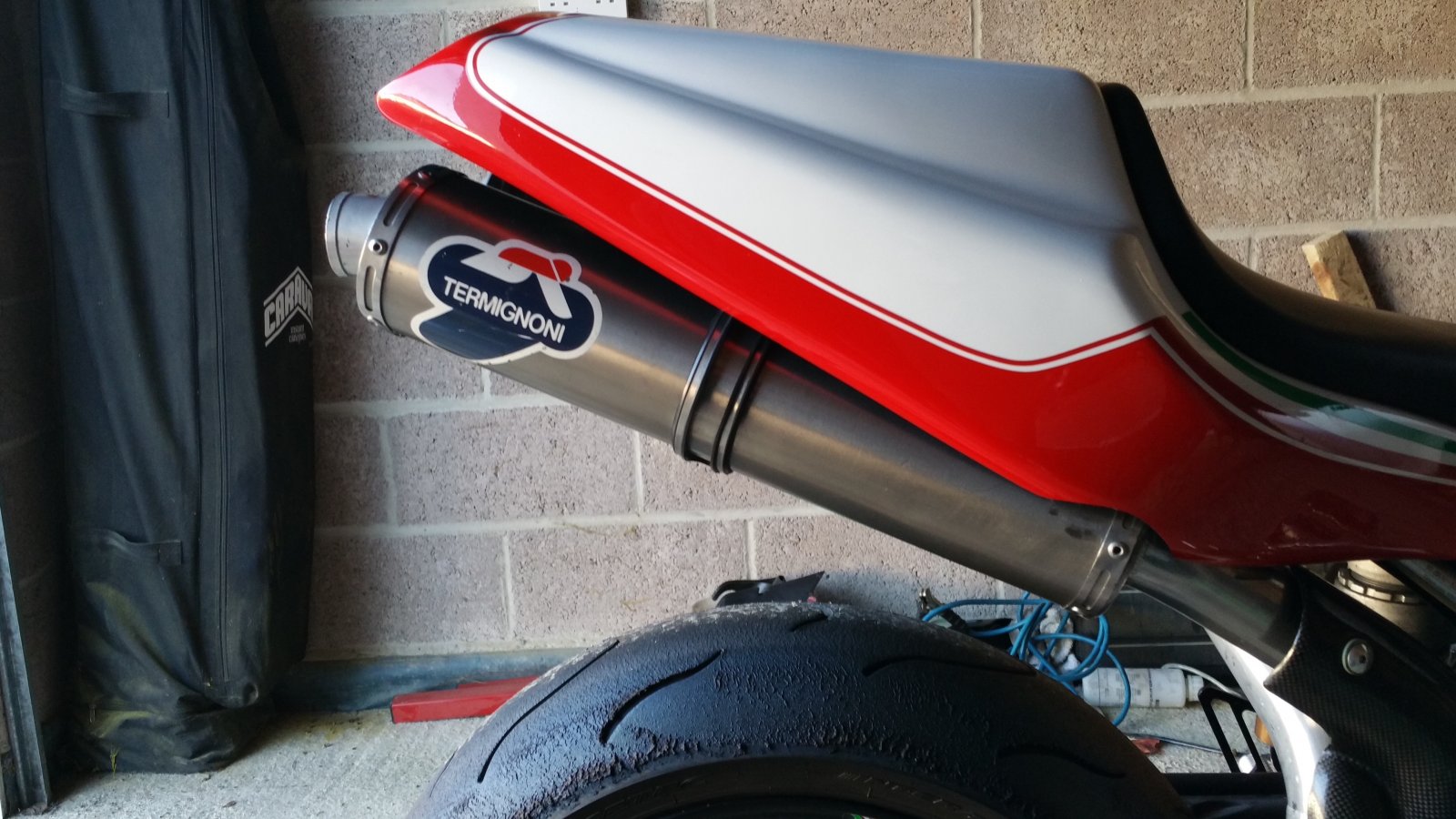

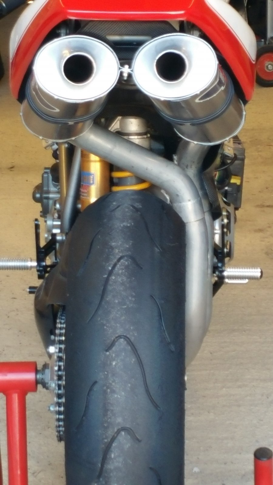

  20. Just picked the bike up from Moto Rapido so a couple of pictures of the 54mm full race system. Fired it up so I could hear it for the first time, my oh my and doesn't it rev :Jawdrop:. Andy
