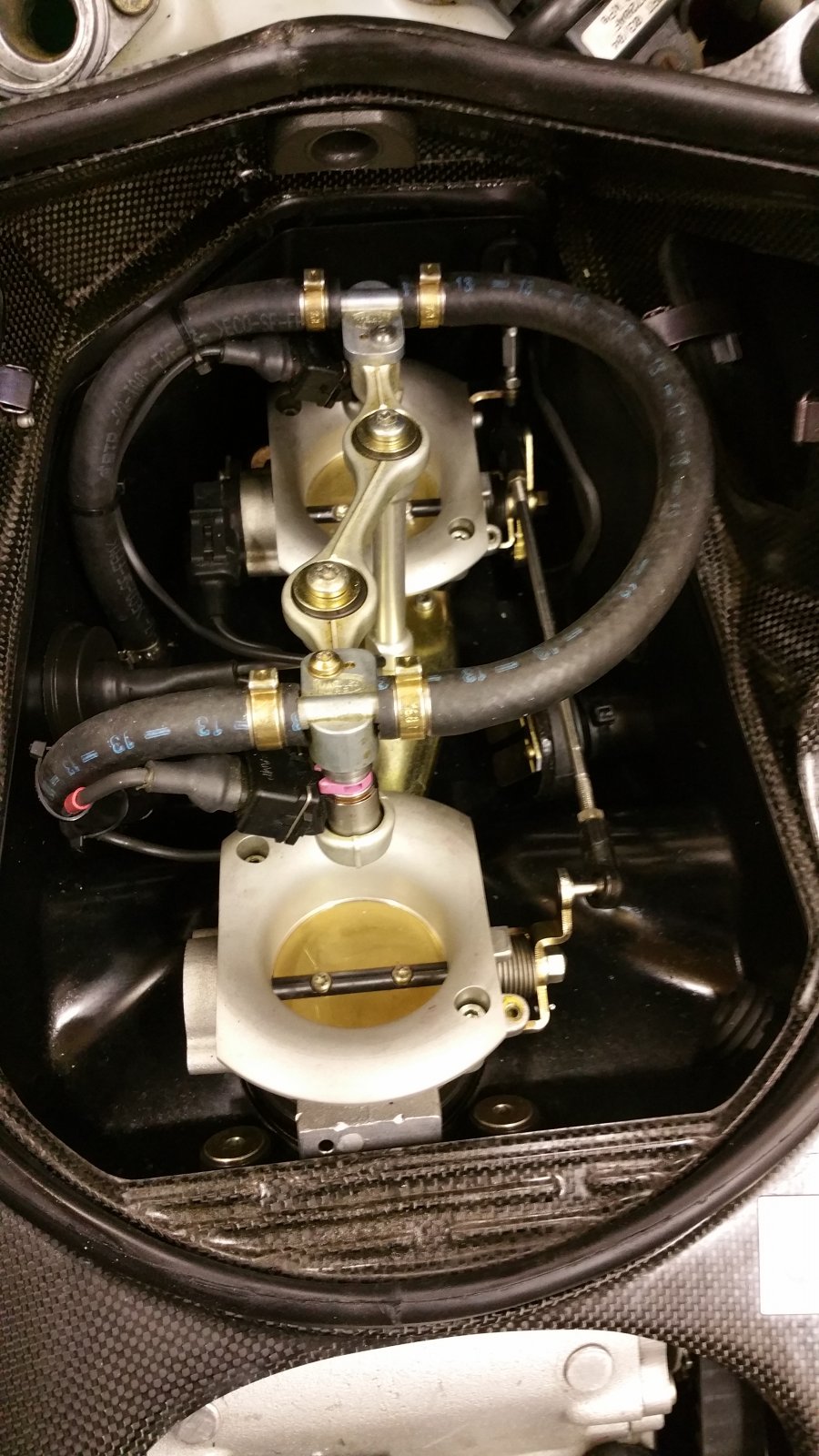

  3. 54mm de restricted throttle bodies and RS throttle body venturis. Andy
