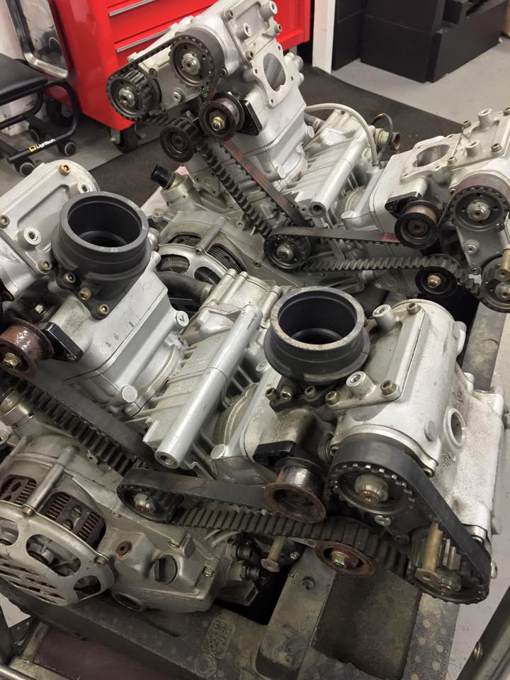

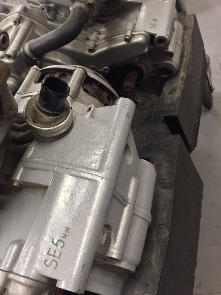

  2. And so the project continues. Dropped off the 748RS engines to MRs this morning and had a chat to Wilf and Baz about the way forward. To a knowledgeable eye first inspection confirms that both engines do appear to be just what they were advertised as. The inlet and exhaust ports have been extensively reworked with the valve guides getting a reduced profile on both engnes and it also looks like they both have lightened flywheels. Excited to see just what these ex BSB Supersport engines look like and have really got my hopes up for some seriously good figures when the rebuilt 853 gets on the dyno. I have been promised some photos so hopefully will have something to add to my album. Andy

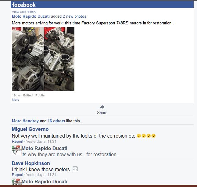

  3. Seen his pic on twitter, wondered if it was yours
  4. Yeah seen em on FB too, they reckon "this little job" should pay Danny Buchans wages for the year :Hilarious:
  5. So I'm a Luddite and don't partake in any social media unless this forum qualifies as such, so I'd be very grateful if someone could reproduce the full tweet for me. Andy
  6. It said something like 'a lovely 748rs motor in fir some refresh work, not used since you last rode is @..... ' ( cant remember who it was, sean thingy I think)

  10. Yes that is them and one of the comments is from the bloke I bought them from. Andy

  15. So, one engine fully stripped and exactly as advertised, it has been refreshed. Turns out the engine dropped a valve and was completely rebuilt, run up on the bench and then put on the shelf. The gearbox is on the second of four stages of "rumbling", new bearings in the cases and the crank, con rod and (853) piston assembly off being balanced. Absolutely chuffed to bits that this engine has the very best of RS bits including an aluminium selector drum with the selector fork spigot that locates in the selector drum having a bearing bush to smooth gear selection. Got the full RS generator and a (very) lightened flywheel. Full RS cams and light weight valve springs ................ yummy. I have a few pictures and a video which I will try and add to an album. Interestingly it now appears that some of the spares I bought in the package are for a 916 Racing so need to chase down some part numbers. Andy
