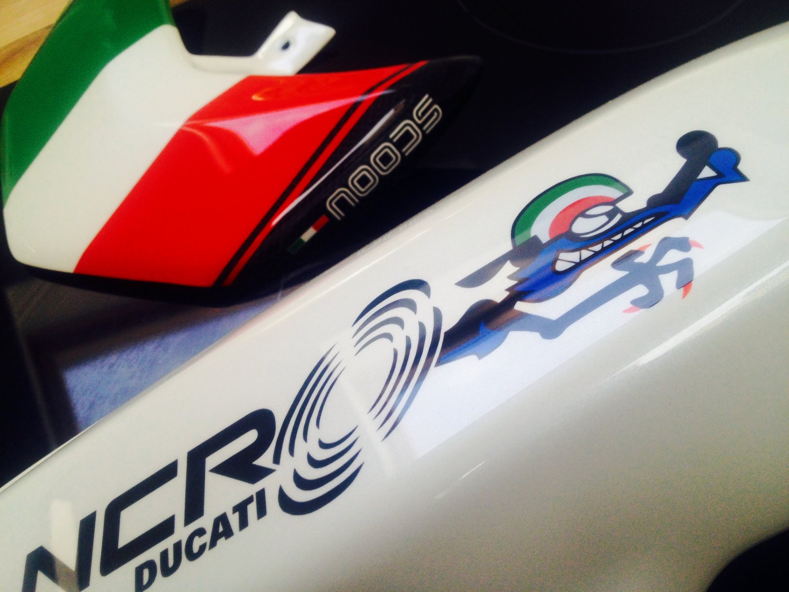

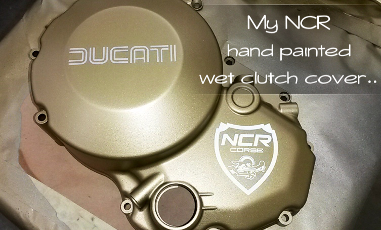

  12. I've come in late on your posting .. I'm planning a similar project on a 996 sps but for a day time mot on the road.. Eg mag s arm upside down ohlin front forks etc.. I'm known for my attention to detail, really fussey.. A couple of pics of my polishing and paintwork below.. image.jpeg
    Were you involved in the engine build? I can see the Ducati logos in the background of your pics..
    What's the blue cylinder thing the gear wheels are sitting in ? Some kind of bead blaster?
    Beautiful work mate.. A man of my own heart.. I could have a panni or similar but still, so adore everything about the 748/916 range.. Beautiful..
    NOODS
